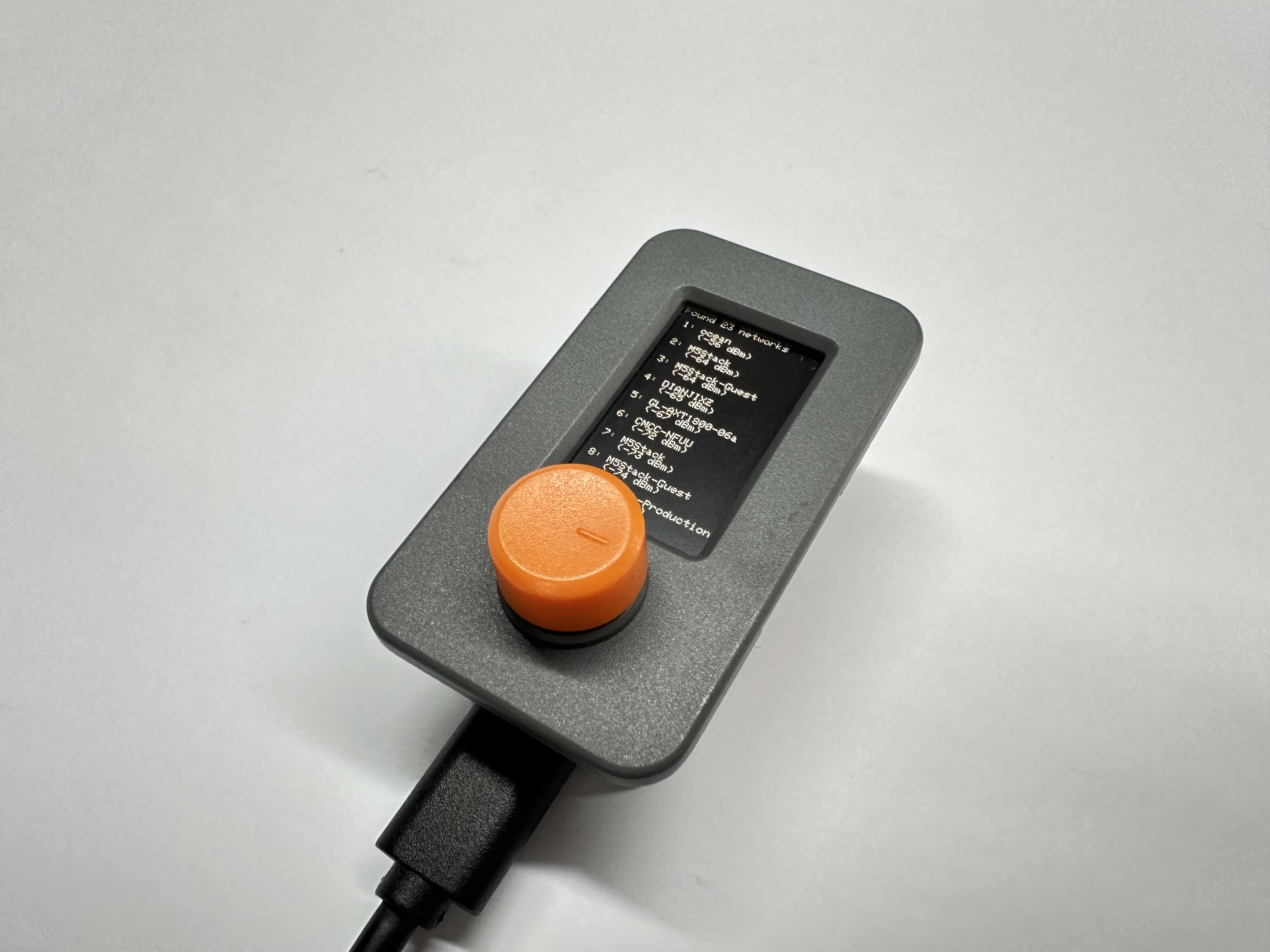

After uploading, press the Reset button to see the following effect:
