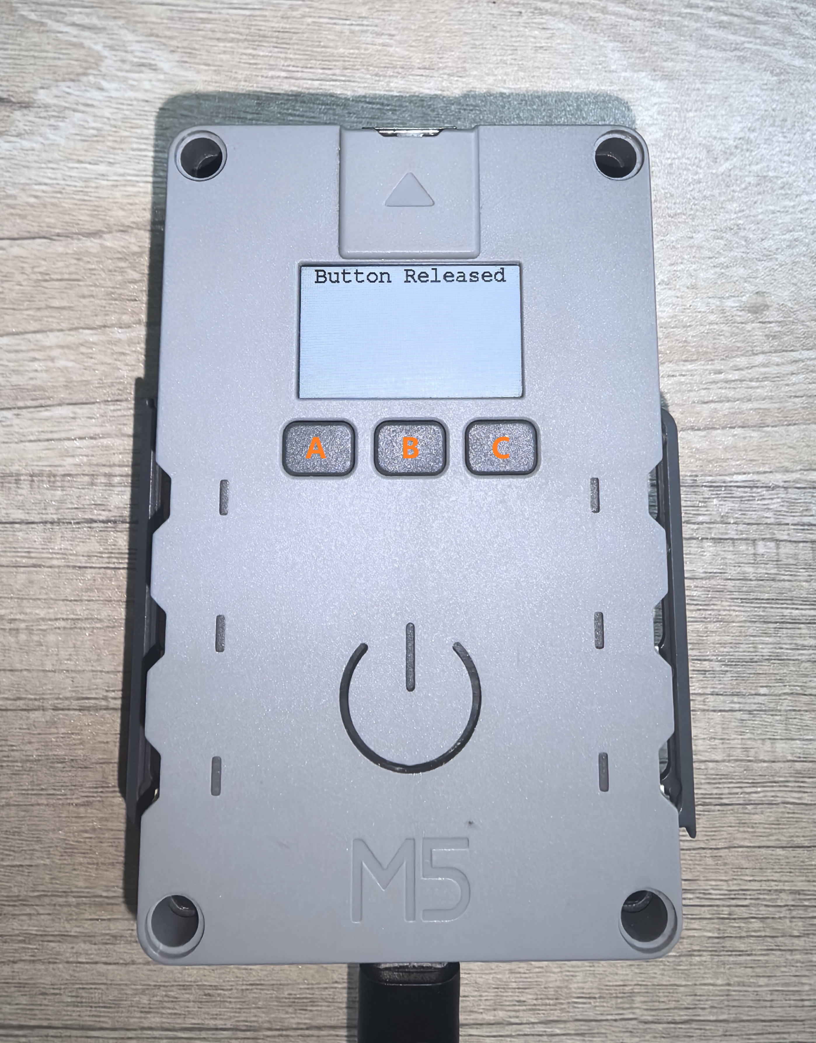

Station Button
Station button input related APIs and sample programs.
Caution:
When using, include the M5.update() function in the main loop to read state updates and minimize blocking as much as possible. Otherwise, button state changes may not be detected in time.
Example

This program displays specific button states on the screen when buttons are pressed.
