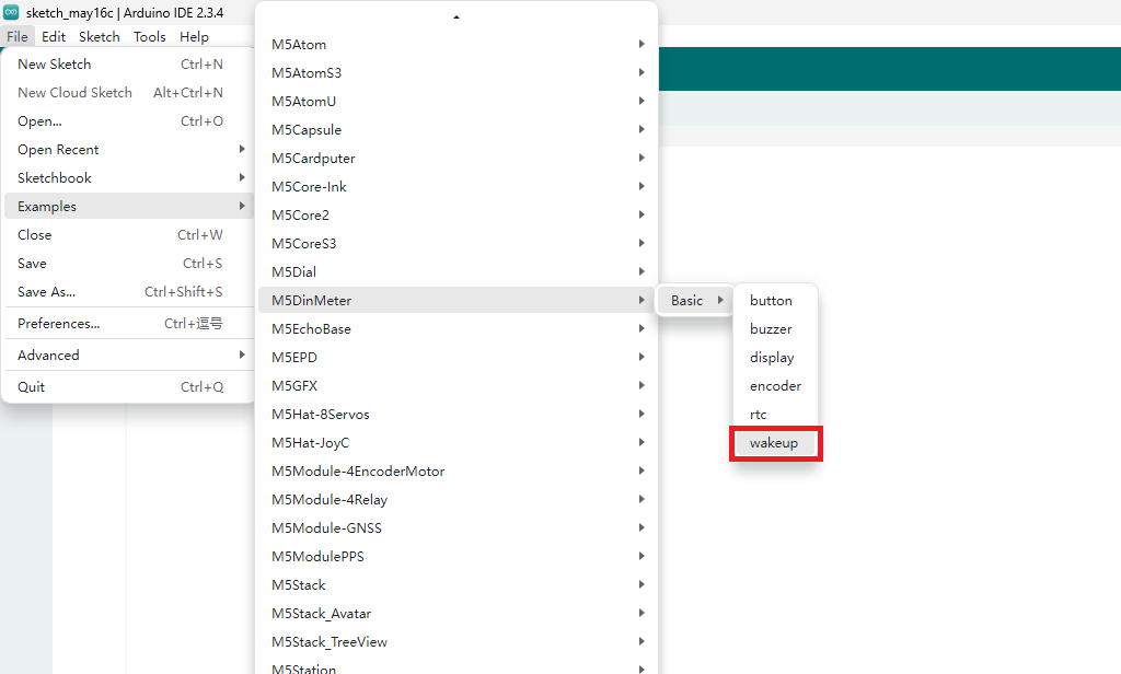

  • Open the example wakeup, upload the code
Example

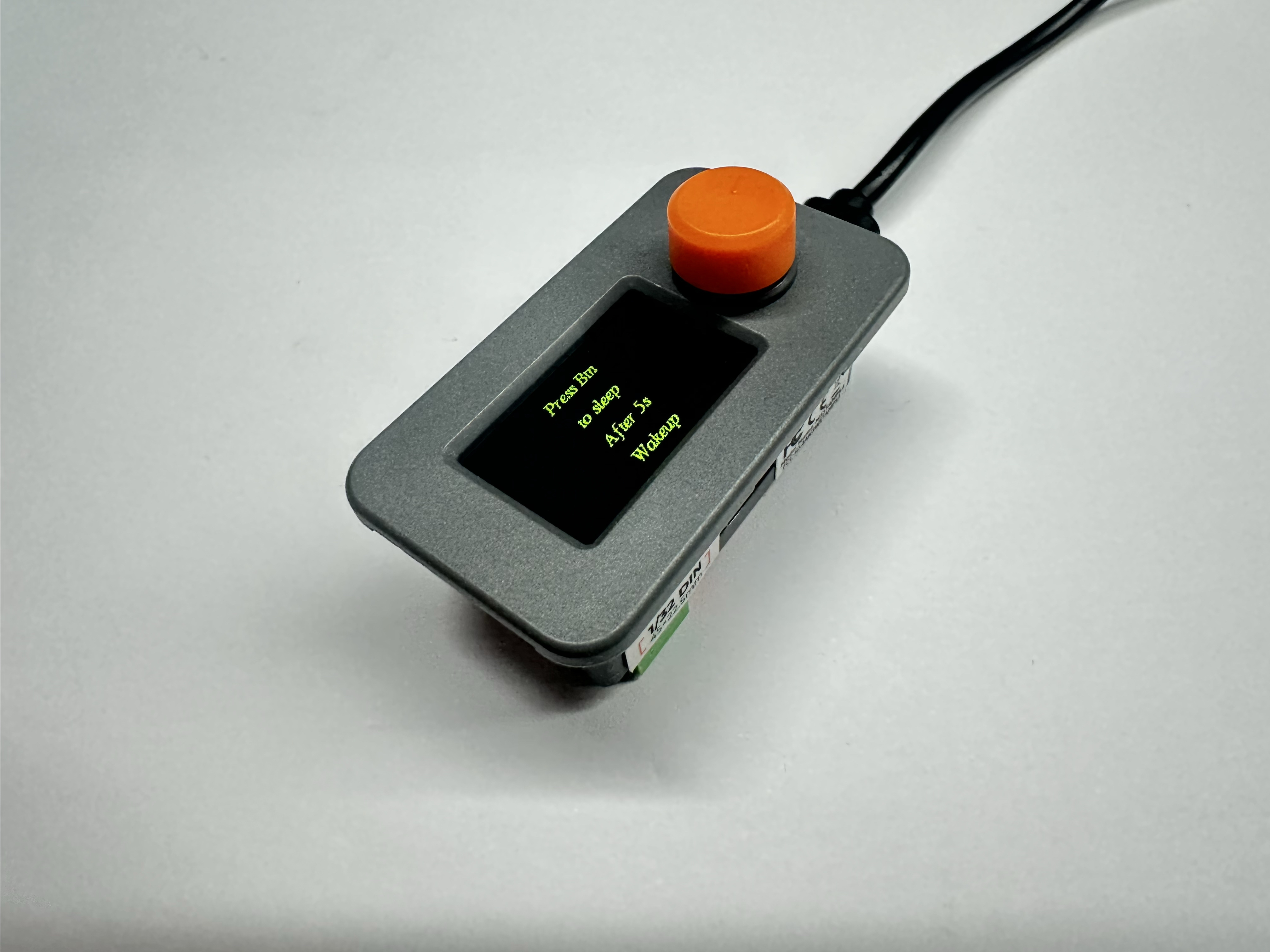

After uploading, press the button to see the following effect
