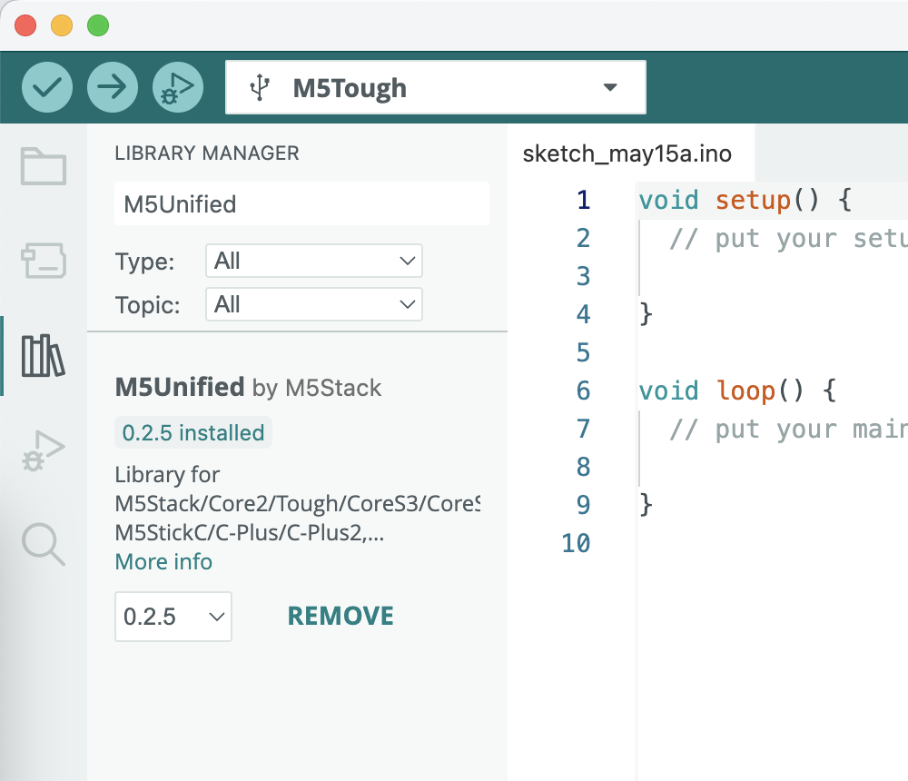

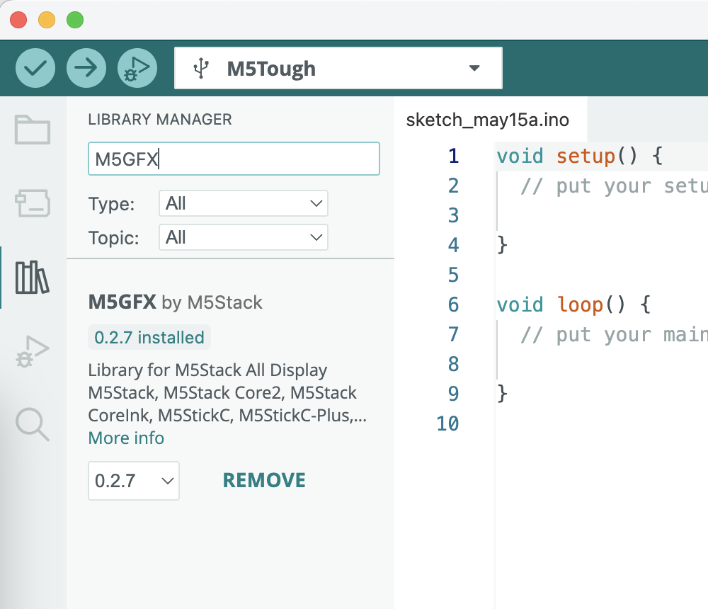

  • 3.Library Installation: Refer to Library Installation Guide to install the latest M5Unified and M5GFX driver libraries, along with all required dependencies.
M5Unified version >= 0.2.5, M5GFX version >= 0.2.7.

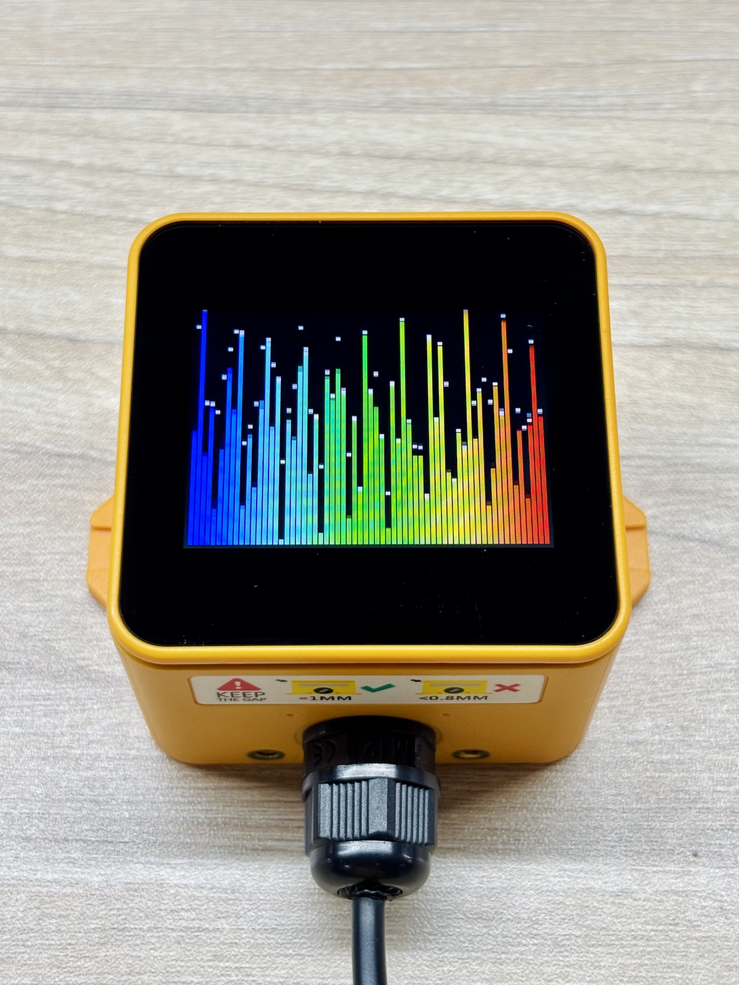

4.Program Compilation & Upload
Open the example program BarGraph from the M5GFX driver library and click the upload button. The program will be compiled and uploaded to the device.
