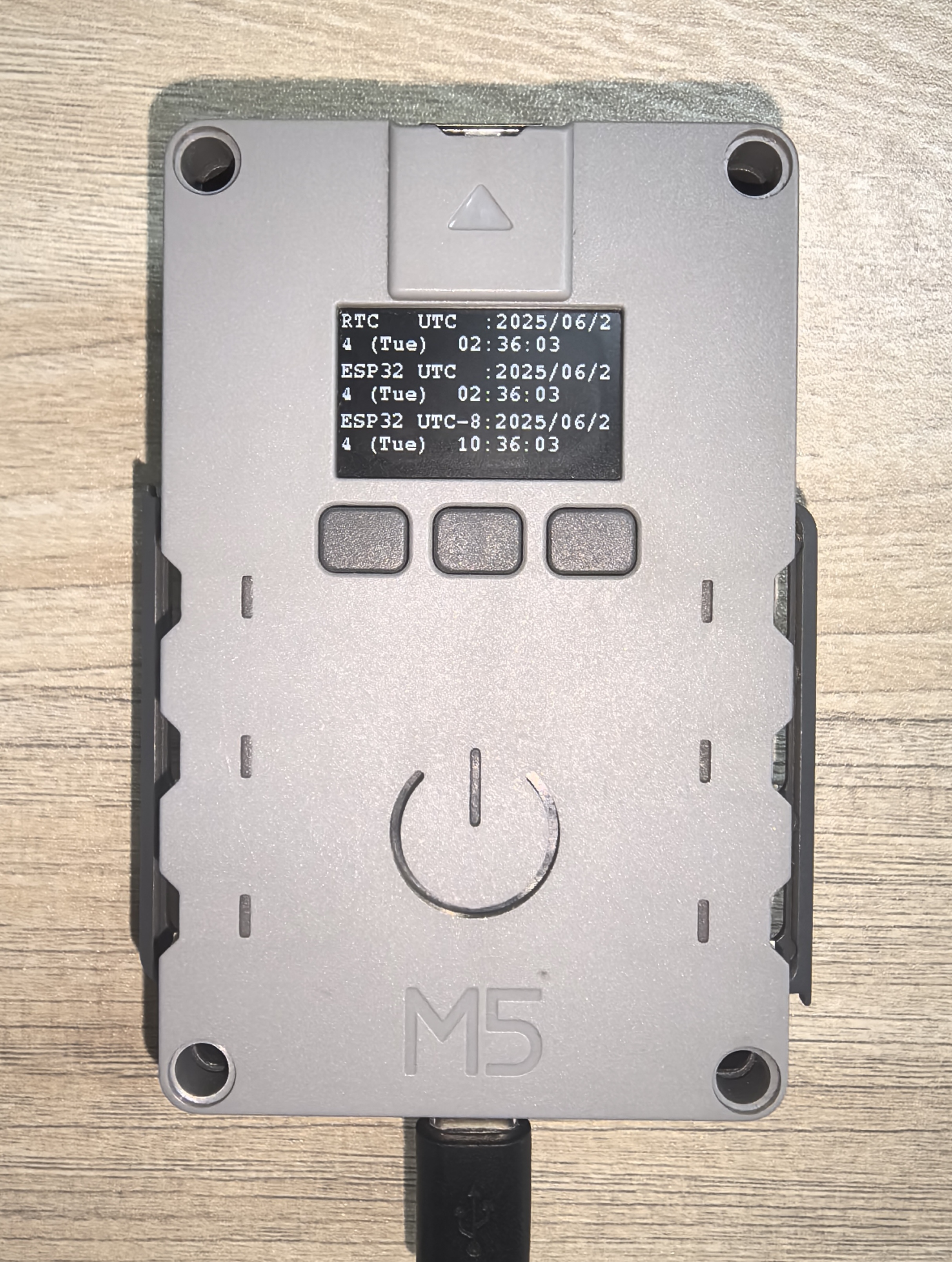

Fill in the Wi-Fi name and password to connect in the program, then click the Upload button to display the real-time clock.
