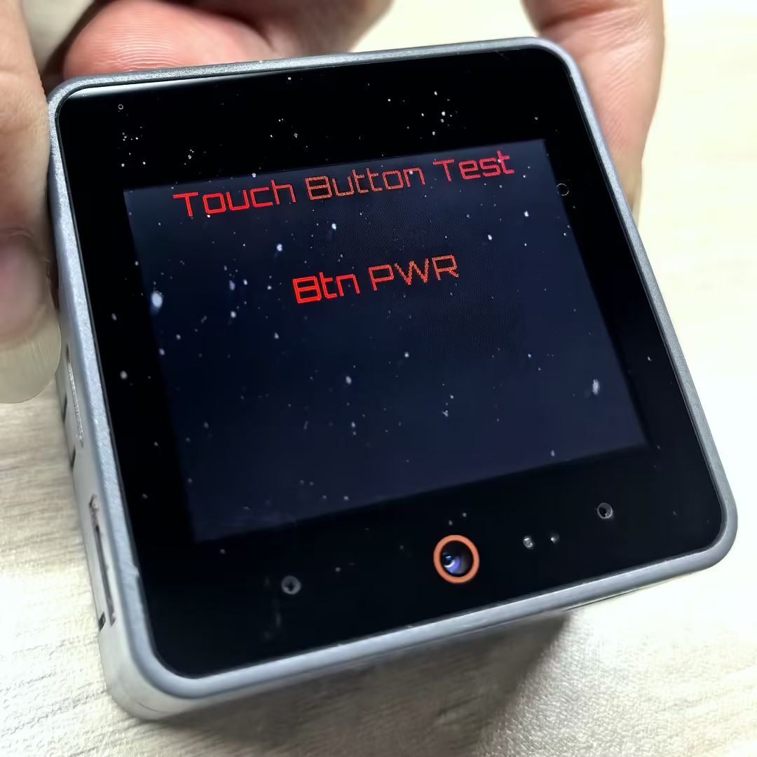

    M5.Display.drawString("Touch Button Test", M5.Display.width() / 2, 15);
void loop(void)
    M5.update();
    if (M5.BtnPWR.wasClicked()) {
        M5.Display.fillRect(0, 40, M5.Display.width(), 70, BLACK);
        M5.Display.drawString("Btn PWR", M5.Display.width() / 2, M5.Display.height() / 2 - 30);
After successful upload, you can trigger events by pressing the CoreS3 power button (BtnPWR). When the button is clicked, the device will detect this event and display the text "Btn PWR" on the screen.
