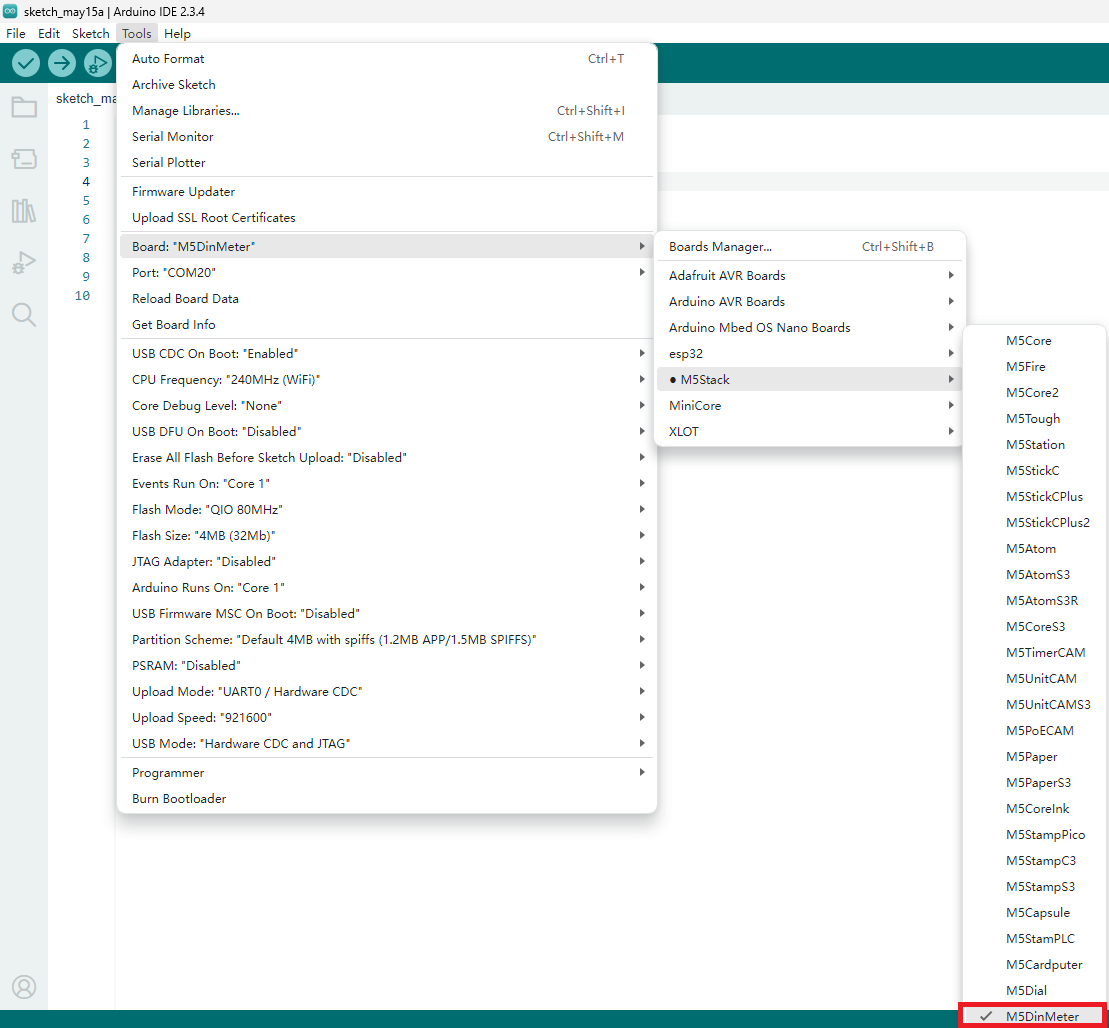

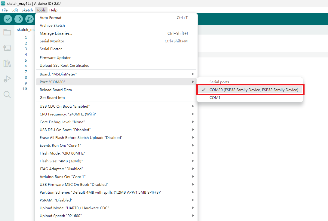

3. Port Selection & Configuration
  • Connect the device to your PC via USB. After the driver installs, select the corresponding board and COM port in the Arduino IDE.

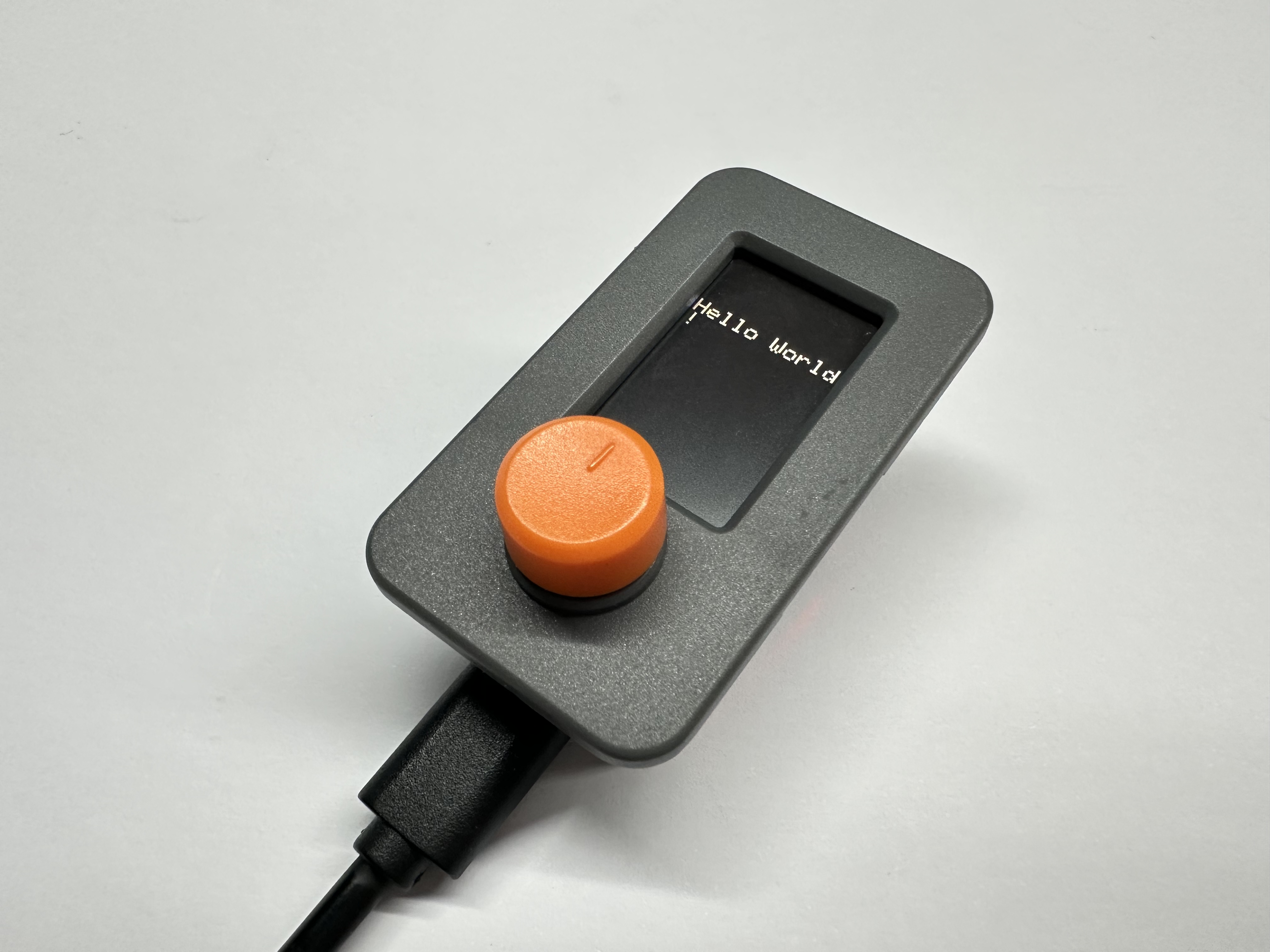

Hello World
  1. In the Arduino IDE, create a new sketch and paste the Hello World example below.
  2. Compile and upload to your device. The screen and Serial Monitor will display “Hello World!”

After uploading, you can see the following effect:

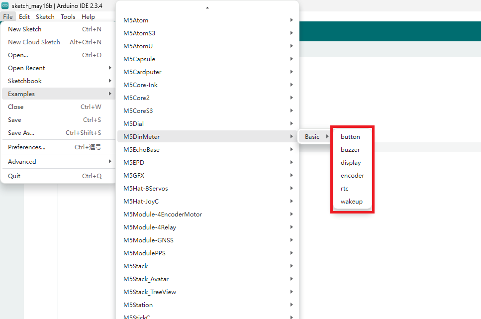

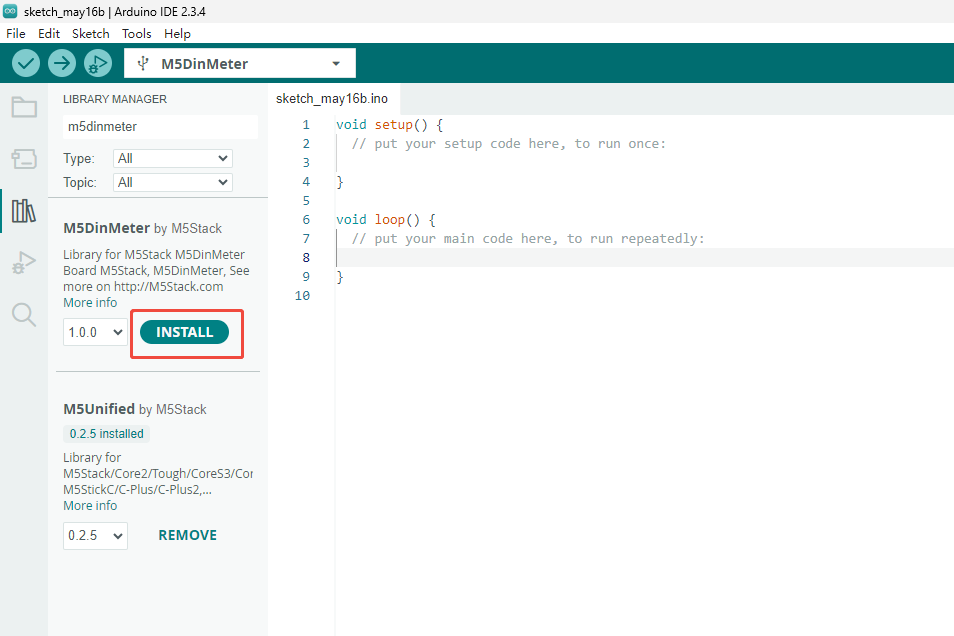

5.M5DinMeter Examples
  • Open the M5DinMeter library examples in the Arduino IDE and upload
