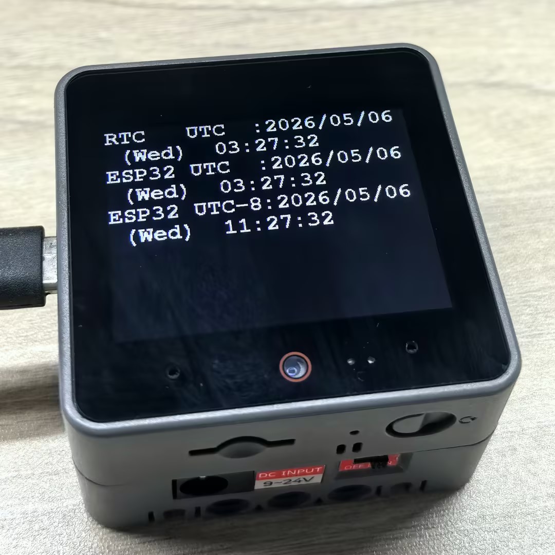

After successful upload, the CoreS3 screen will display the current RTC time and the ESP32 internal clock time information. The RTC time is set through NTP synchronization, while the ESP32 internal clock is obtained through the system time function. They should be synchronized.
