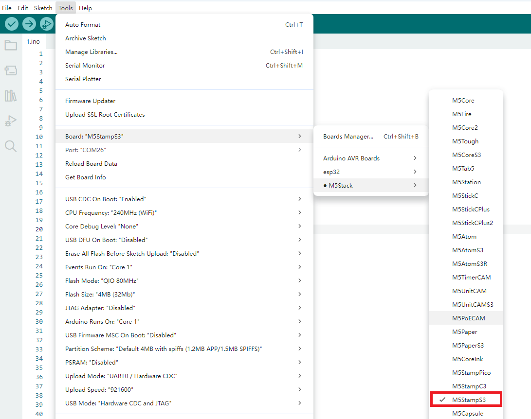

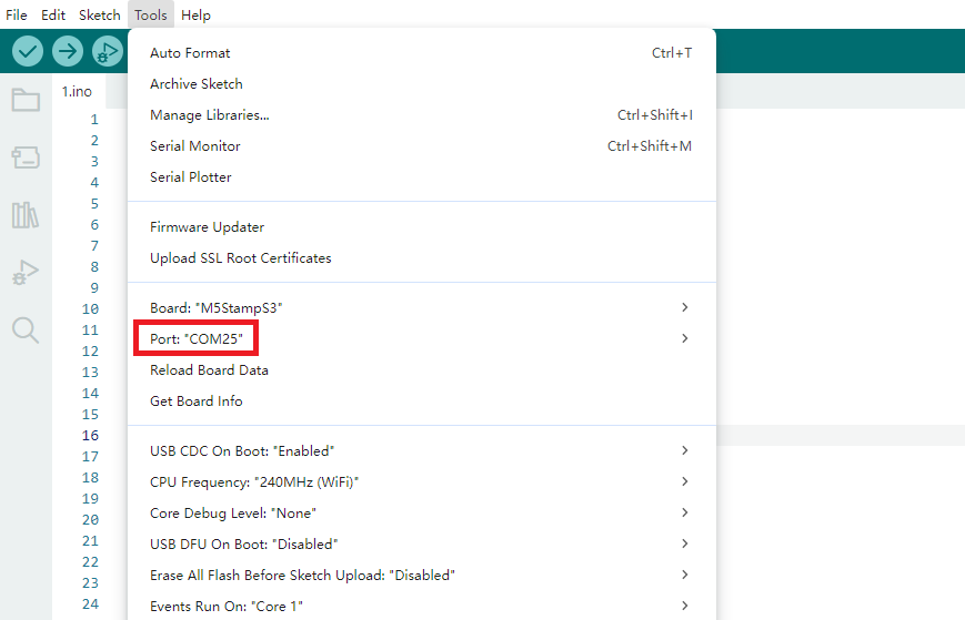

3.Port Selection
Wait for the device to successfully recognize the port, and select the corresponding device's port in Arduino IDE.

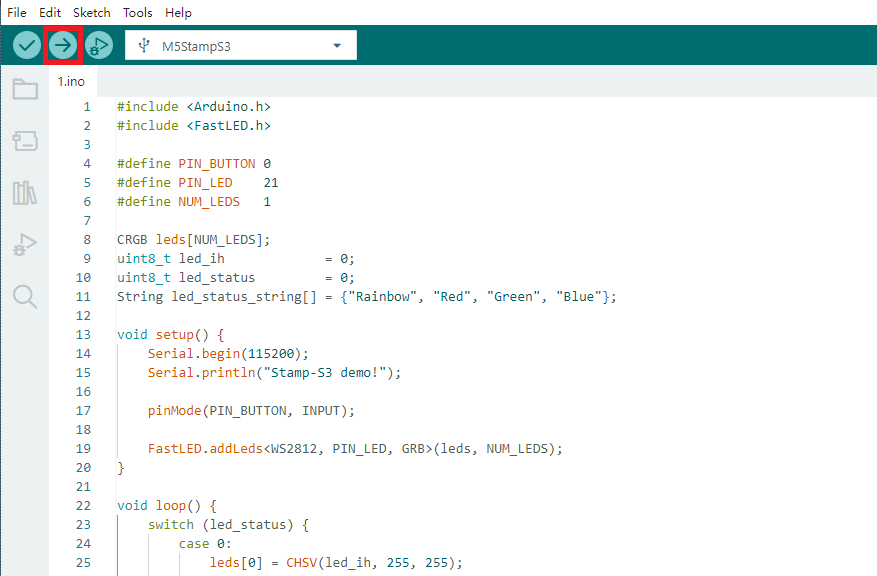

4. Program Compilation & Upload
Enter the following code in the Arduino IDE workspace, and click the upload button. The program will be automatically compiled and uploaded.
Note
This example is realized based on FastLED library, please install FastLED dependency library through the library manager before use.
