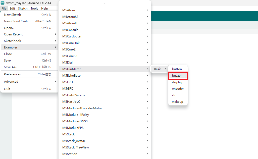

  • Open the example program buzzzer and upload the code
Example

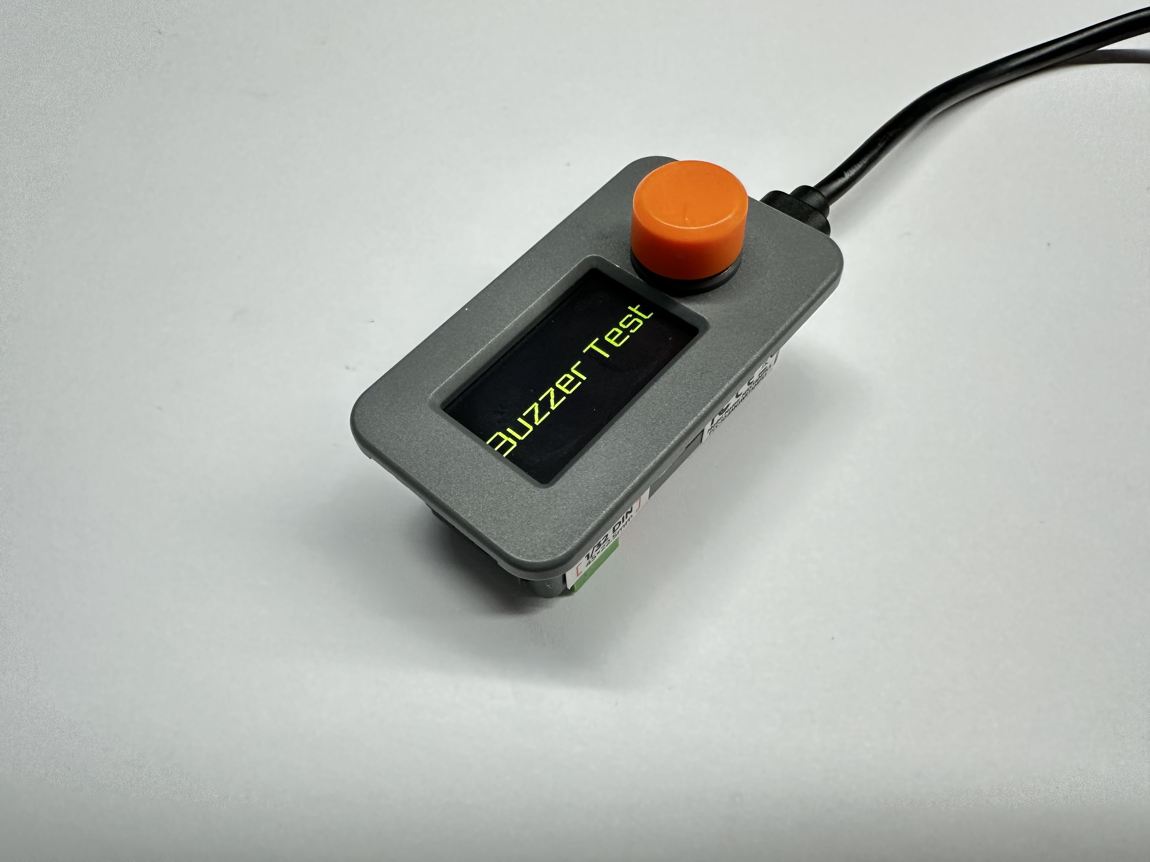

After uploading, you can see the following effect
