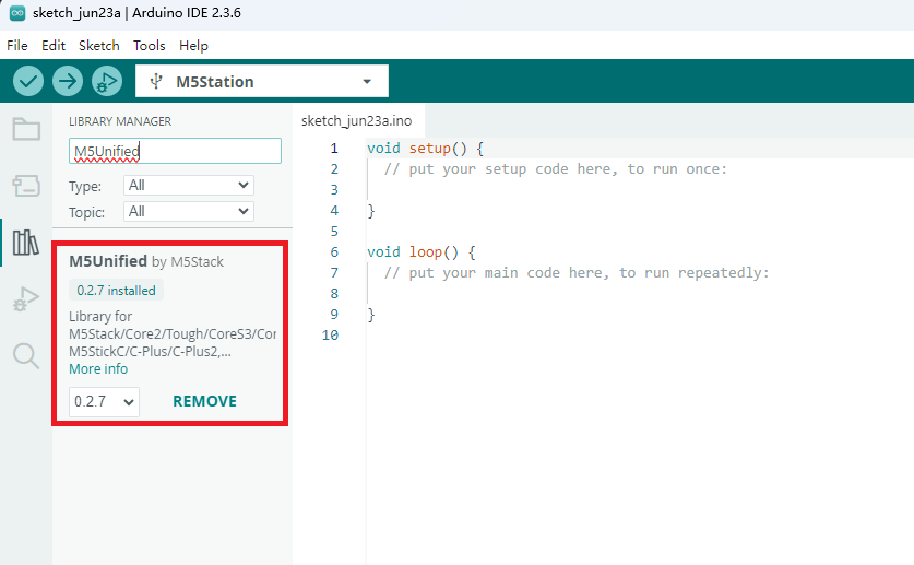

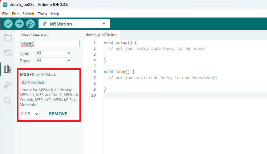

    1. Library Installation: Refer to the Library Management Installation Tutorial to complete the installation of the M5Unified and M5GFX driver libraries, and follow the prompts to install all the required libraries.

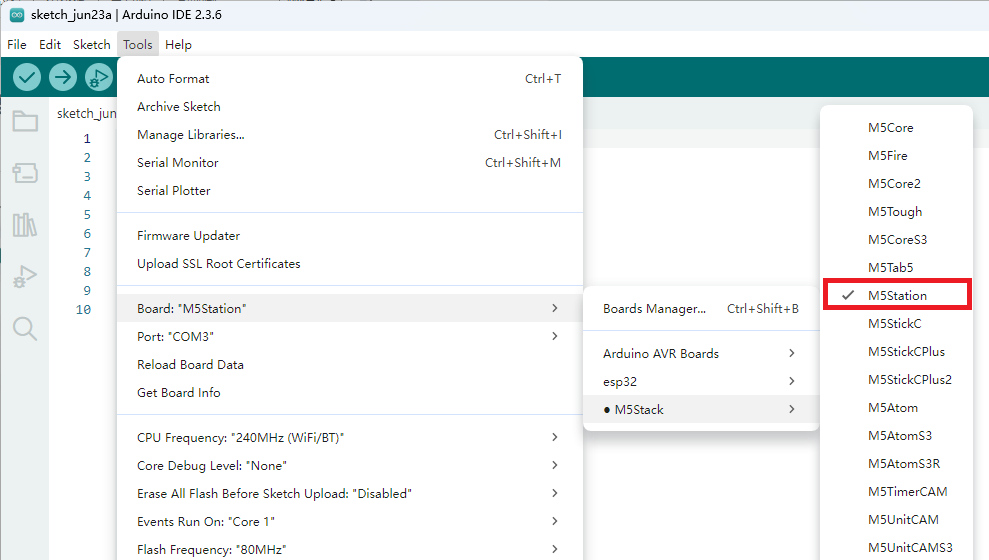

3.Port Selection
Connect the device to the computer via a USB cable. After completing the driver installation, select the corresponding device port in the Arduino IDE.

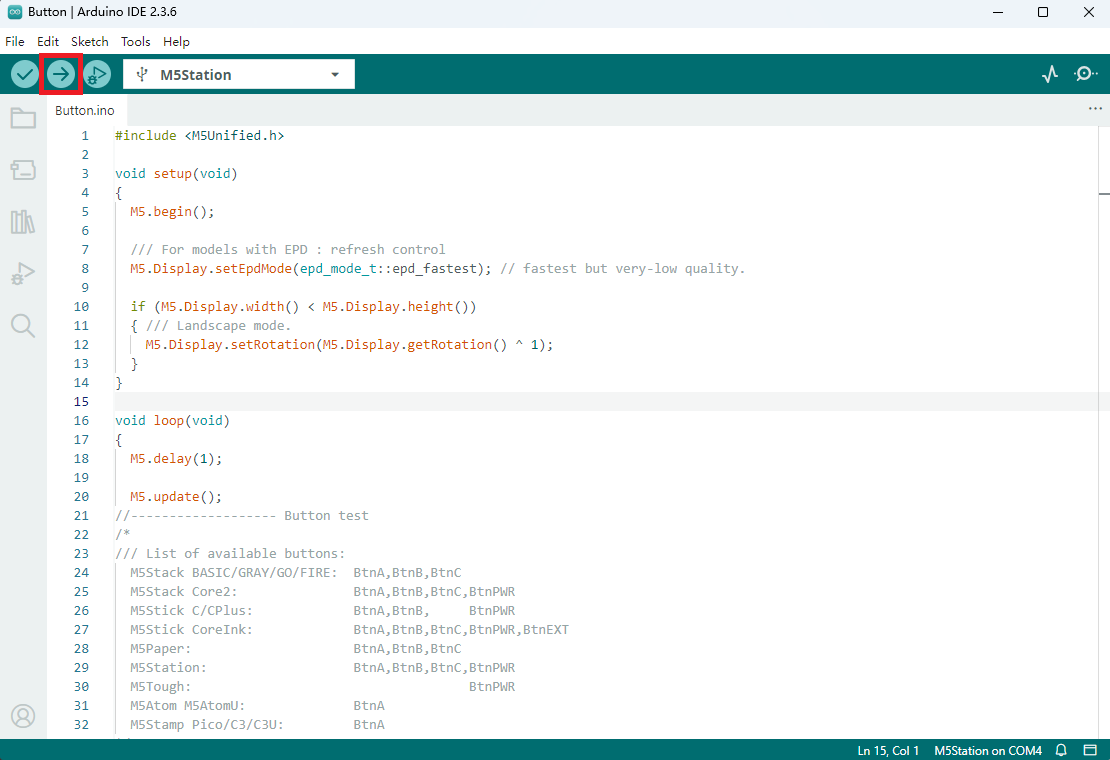

4. Program Compile & Upload

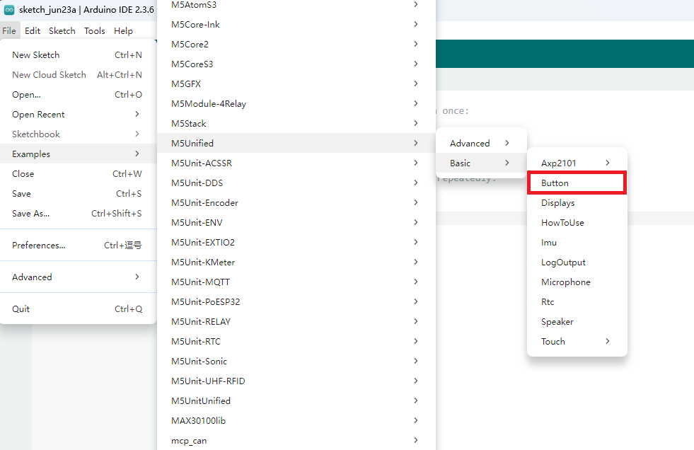

Open the sample program "Button" in the M5GFX driver library, then click the upload button to automatically compile and flash the program.

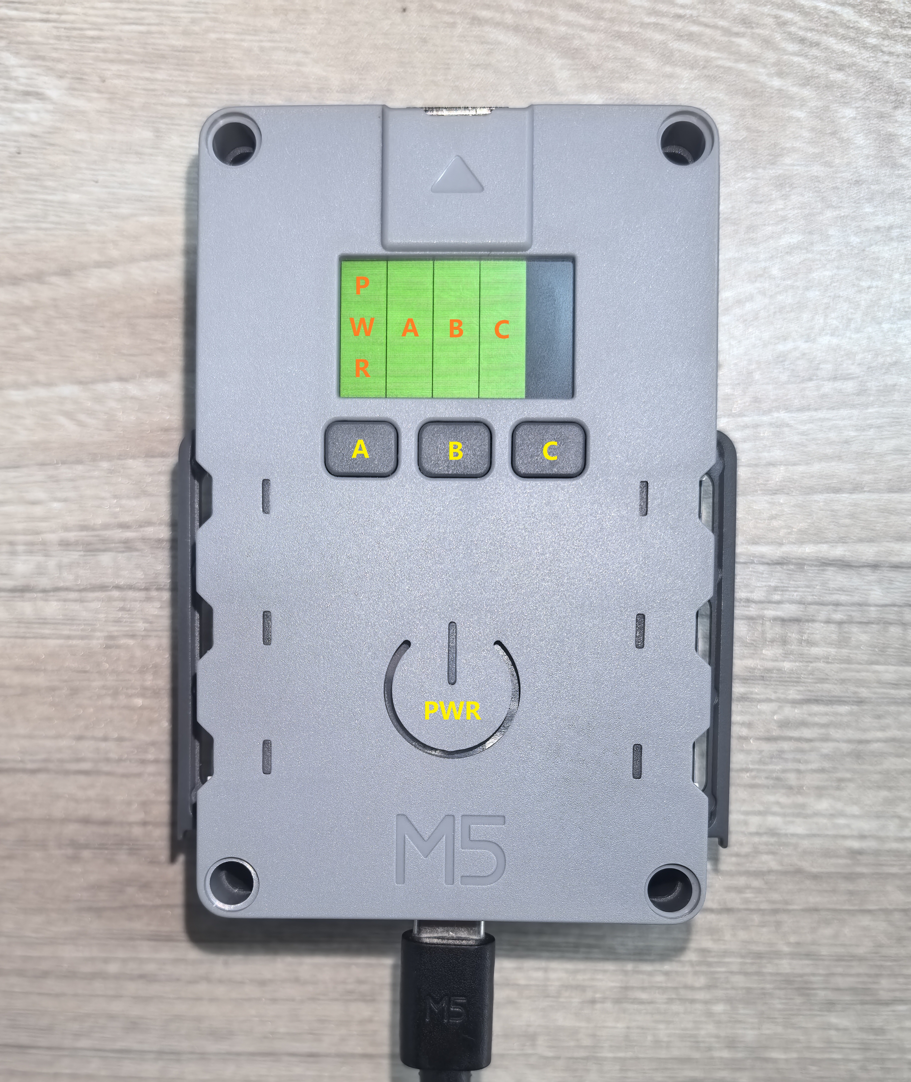

Press the button, and the corresponding area will change color. The position of the button is as shown in the figure below:
