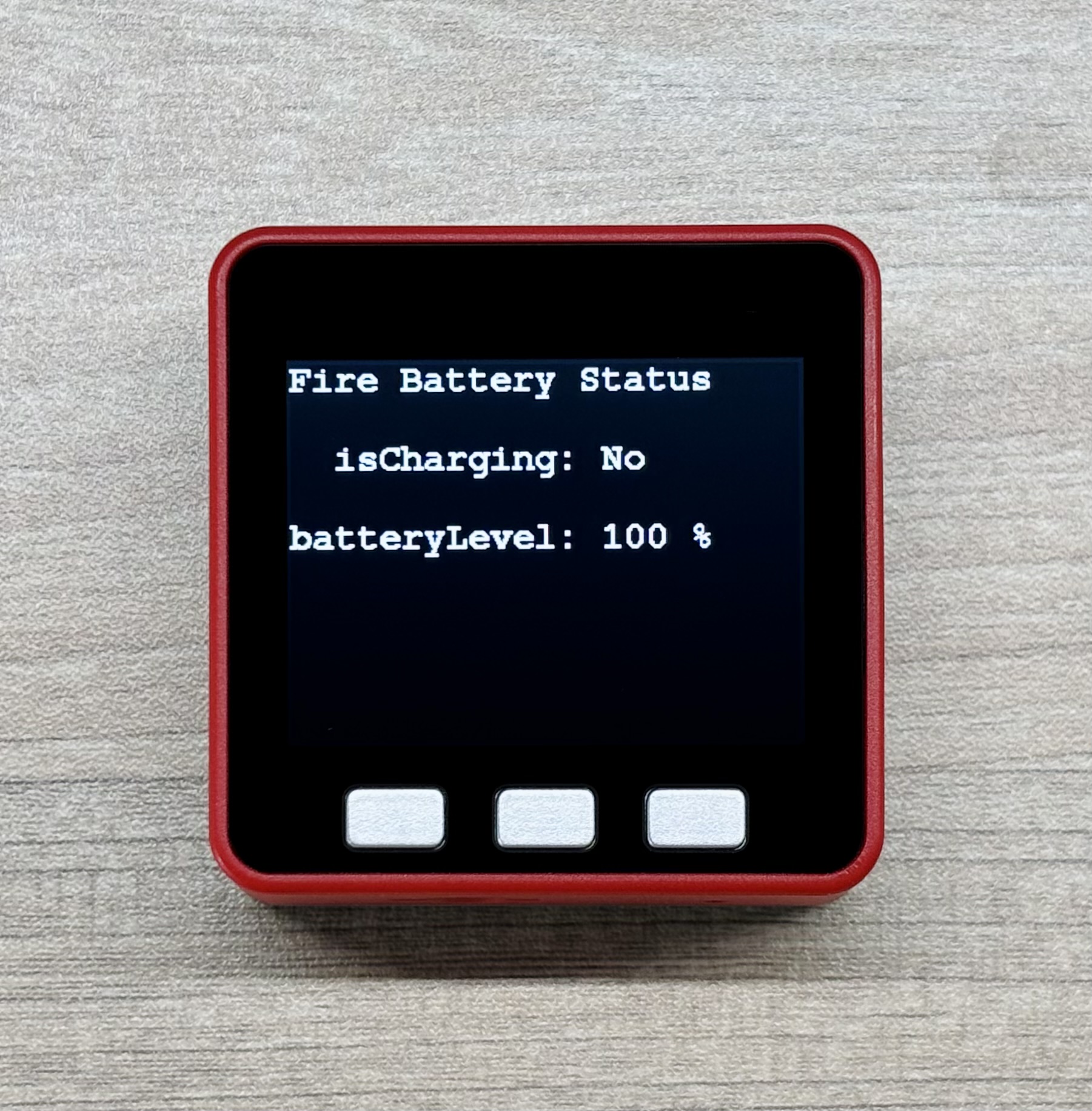

#include "M5Unified.h"
void setup() {
  M5.begin();
  M5.Display.setFont(&fonts::FreeMonoBold12pt7b);
  M5.Display.clear();
  M5.Display.setCursor(0, 0);
  M5.Display.print("Fire Battery Status");
void loop() {
  M5.update();
  bool isCharging = M5.Power.isCharging();
  int batteryLevel = M5.Power.getBatteryLevel();  // 0 - 100 %
  M5.Display.setCursor(0, 50);
  M5.Display.printf("  isCharging: %-3s", isCharging ? "Yes" : "No");
  M5.Display.setCursor(0, 100);
  M5.Display.printf("batteryLevel: %3d %%", batteryLevel);
  delay(1000);
The program will display whether the battery is charging and the battery percentage on the screen, refreshing once every second.
Due to hardware limitations, the Fire cannot read battery voltage or current information. The battery percentage is displayed in only five levels (0%, 25%, 50%, 75%, 100%). For the correspondence between percentage and voltage, see the Product Page.
