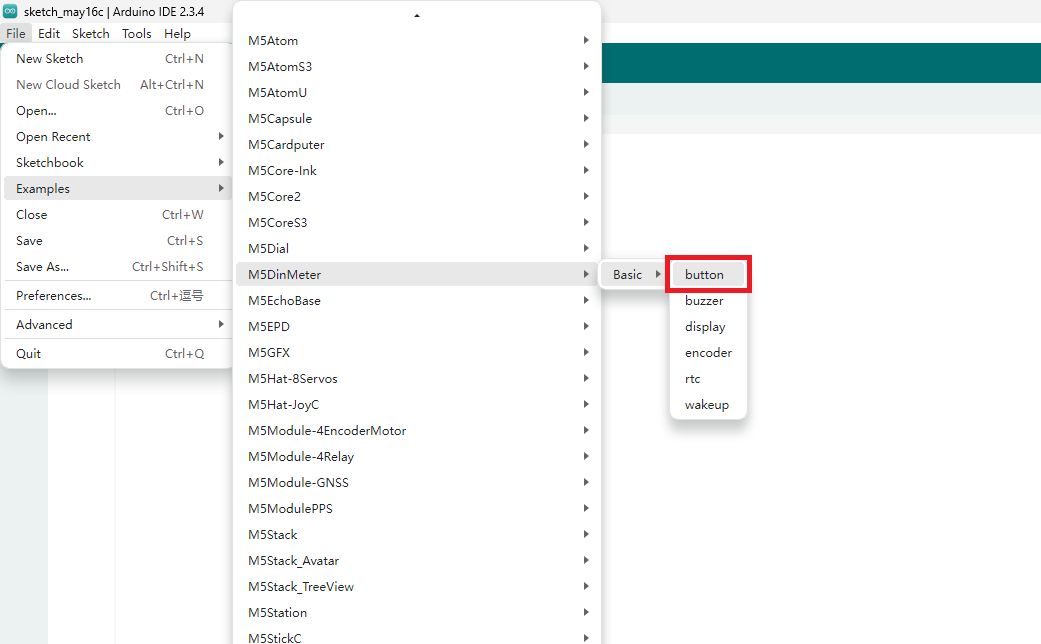

  • Open the example program button and upload the code

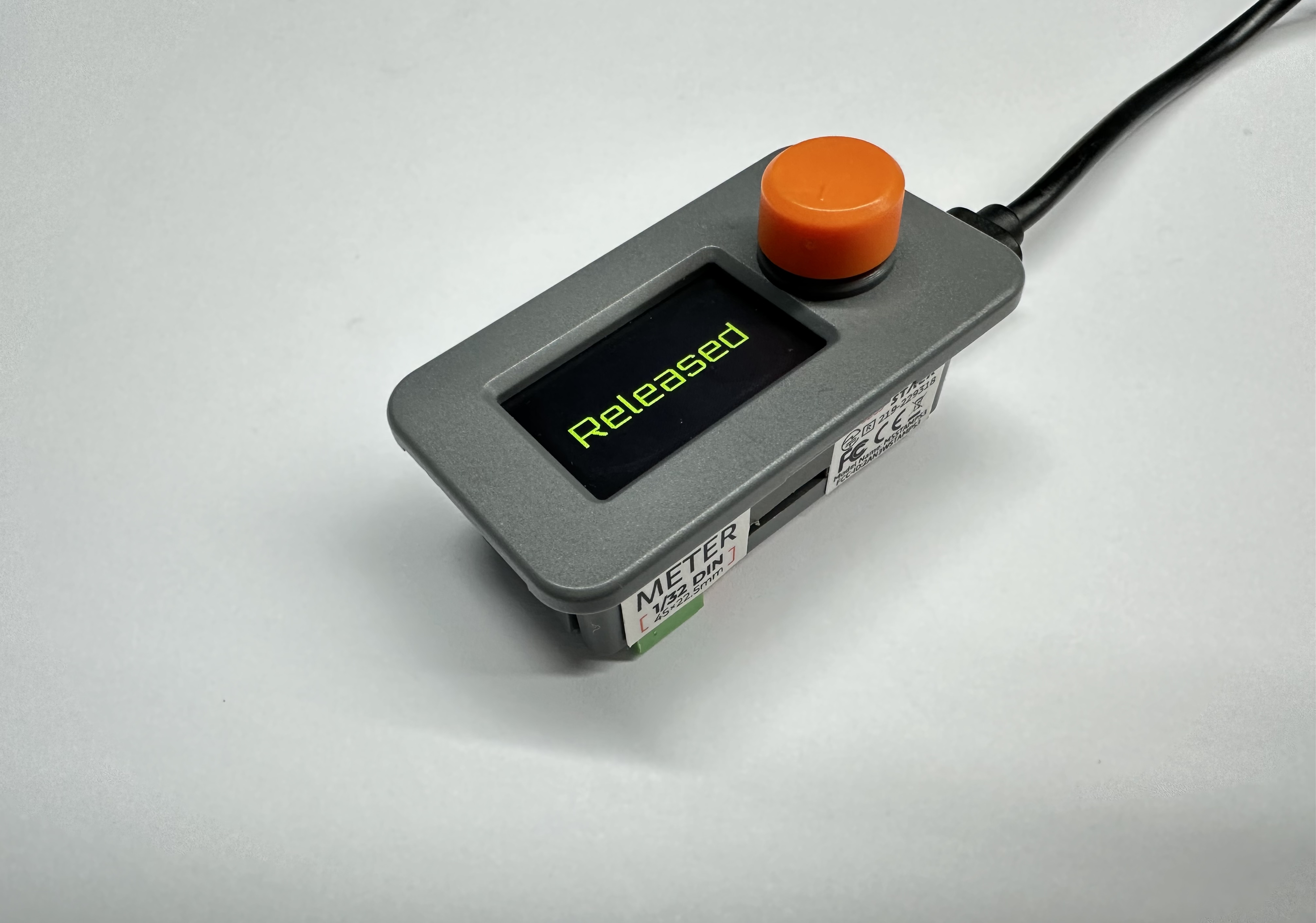

After uploading, you can see the following effect
