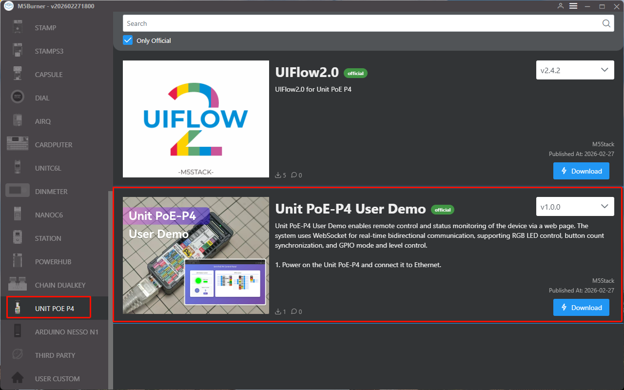

  • Refer to the M5Burner tutorial to complete the download of the flashing tool, and refer to the image below to download the corresponding firmware.

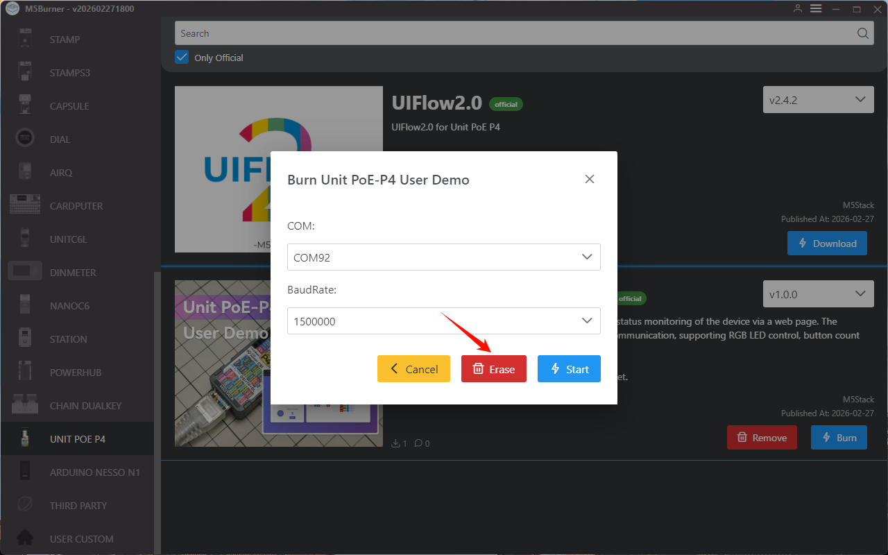

  1. Click Erase to erase old data.

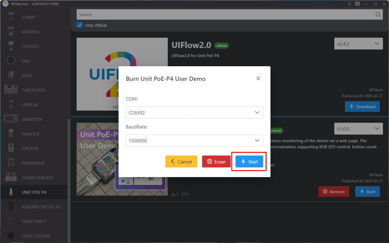

  1. Click Start to begin flashing.

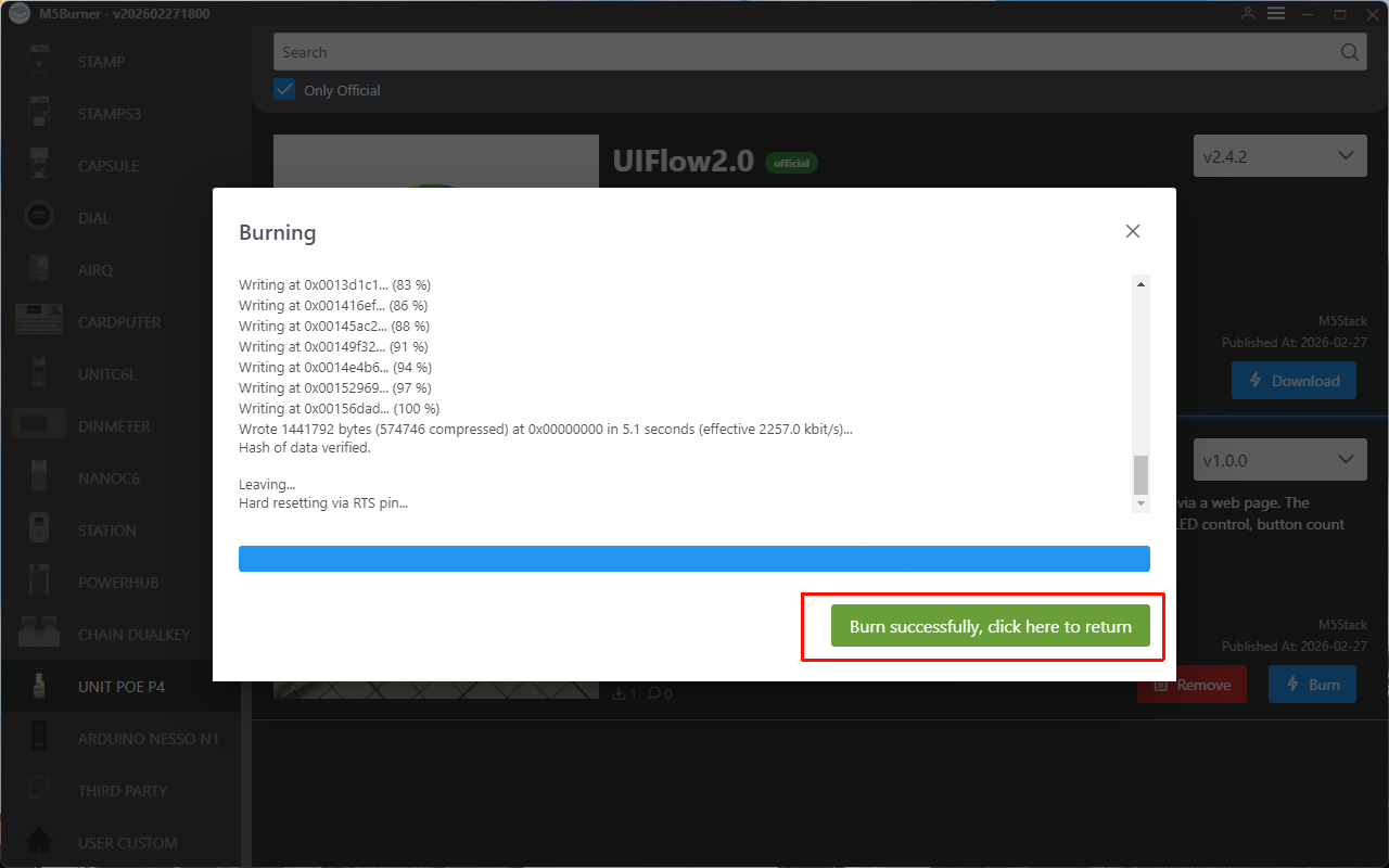

After flashing is completed, the following message will be displayed:
