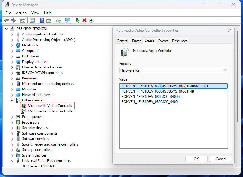

  4. After booting, press Win+R, enter devmgmt.msc to open Device Manager. An unknown multimedia video controller will appear under Other devices. In the device properties, you can confirm that the VENDOR is 1F4B.

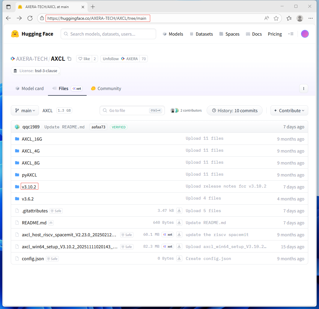

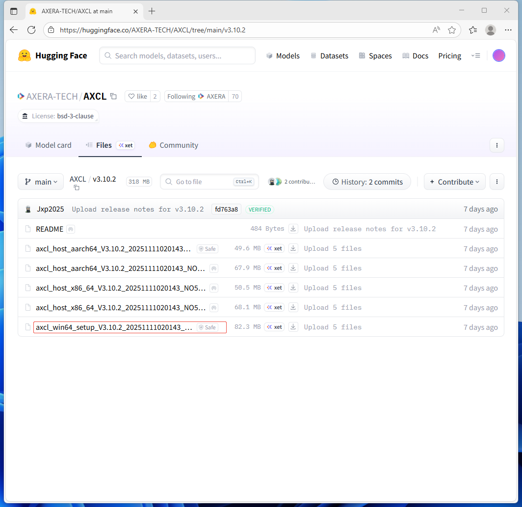

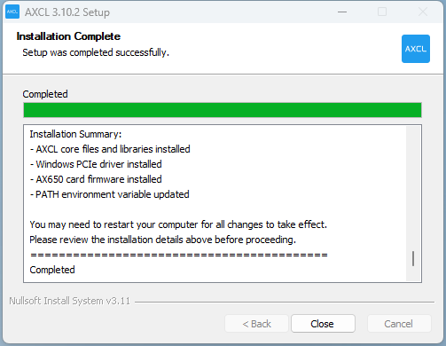

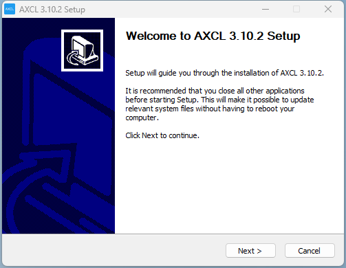

  1. The Windows release package axcl_win64_setup_Vx.x.x_yyyymmdd_NOxxxx.exe will automatically install the driver, dynamic link libraries (including import libraries), executable programs (such as axcl-smi.exe), and sample source code. Run the release package with administrator privileges and follow the wizard to complete the installation. Click to download
  2. Click Install.

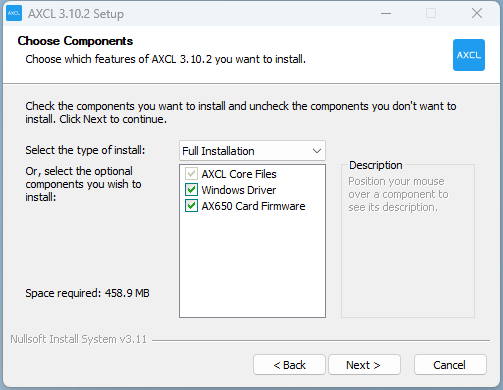

  1. It is recommended to select all components for installation.

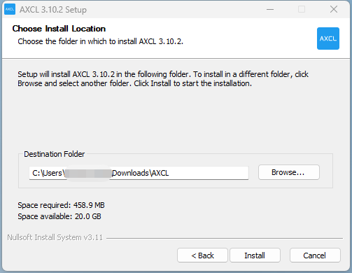

  1. Pay attention to the installation path selection. This directory contains executable programs, the uninstaller, header files, and dynamic libraries.
  1. Wait for the installation to complete and restart the computer.

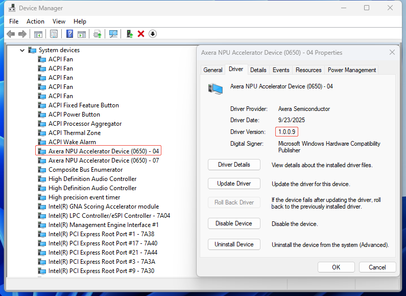

  1. After restarting, press Win+R, enter devmgmt.msc to open Device Manager. Under System devices, you will find the Axera NPU Accelerator Device, as shown below.

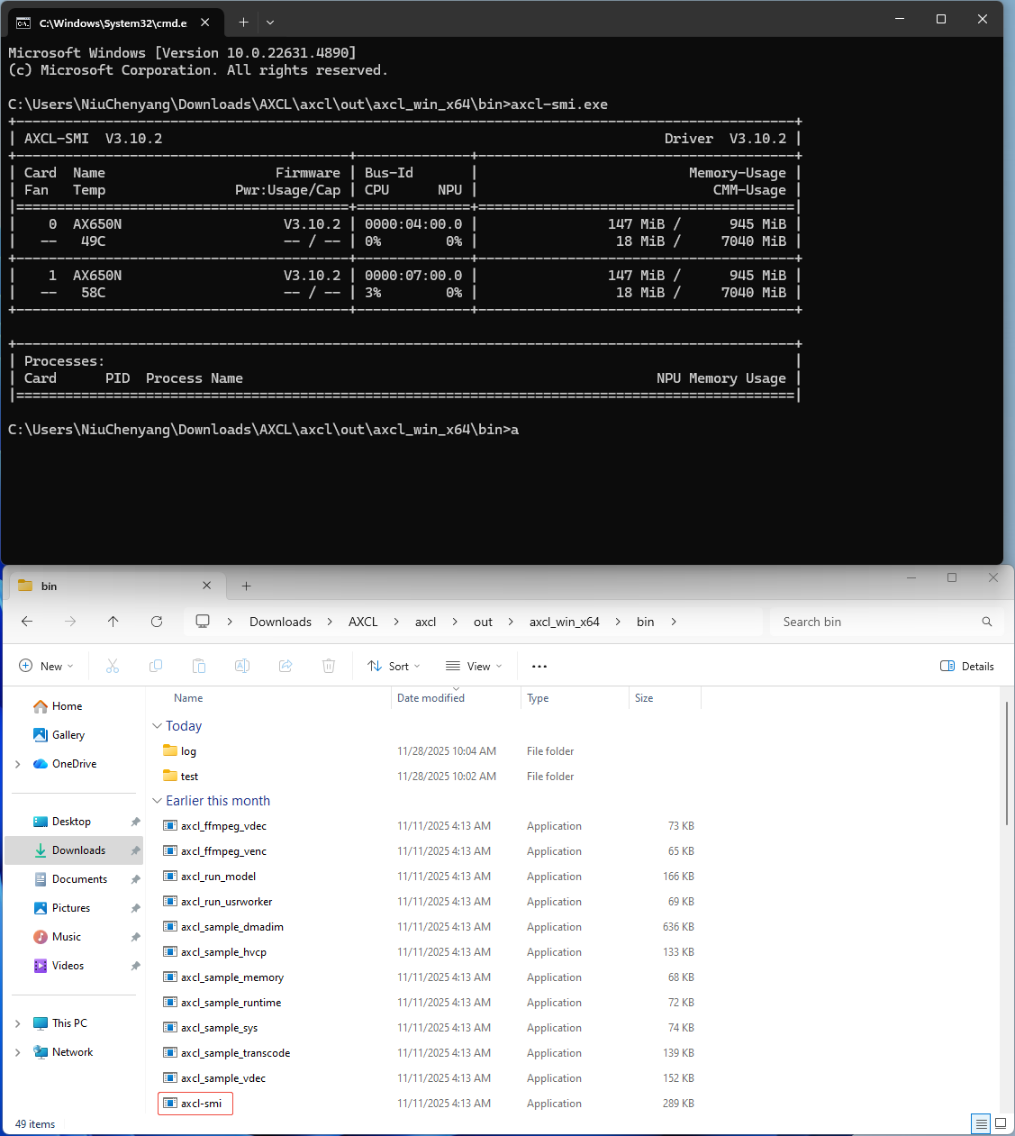

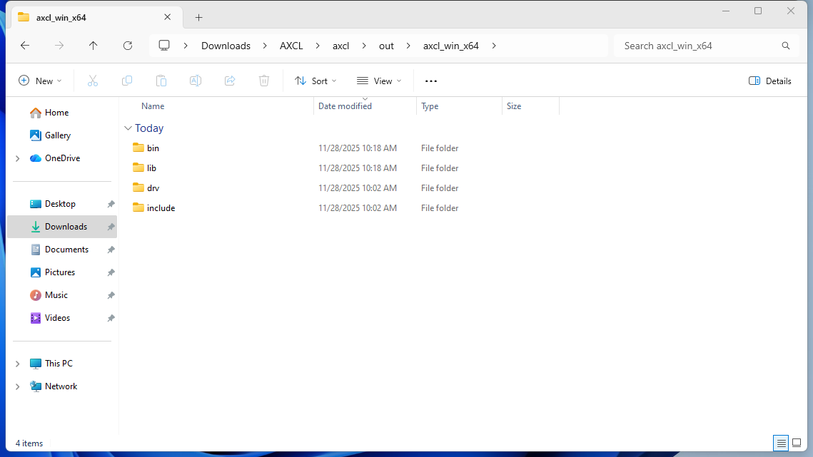

  1. Navigate to the installation path AXCL\axcl\out\axcl_win_x64\bin. In Windows Terminal, execute axcl-smi.exe. The output should appear as follows:

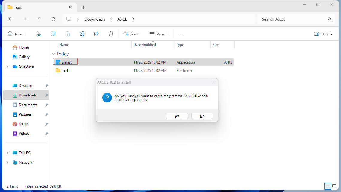

  1. Navigate to the installation path AXCL and run uninst.exe to uninstall.

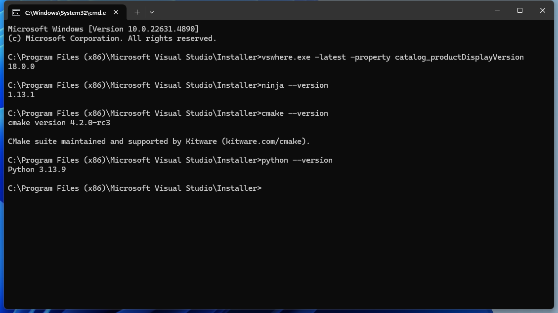

The AXCL Windows SDK can be built using the Visual Studio 2022 / Visual Studio 2026 toolchains. The required environment dependencies are as follows:
- Visual Studio Community 2026, refer to the official documentation. Required workload: Desktop development with C++.
- CMake, version higher than 3.20.
- ninja, recommended v1.31.1. Add the path of ninja.exe to the system environment variable Path.
- Python3 can be installed via conda.
After the environment is set up, it should look like the following:

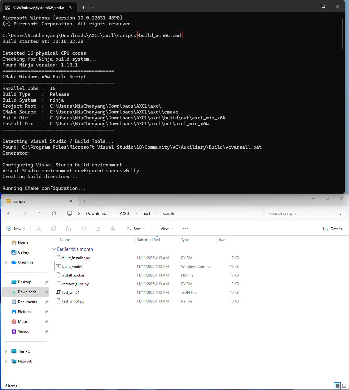

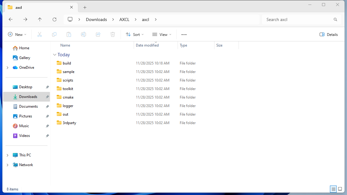

Navigate to the installation path AXCL\axcl\scripts and execute build_win64.cmd to compile.

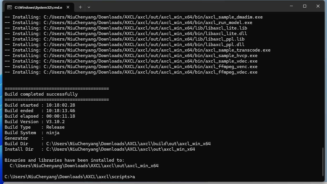

A successful build is shown below:

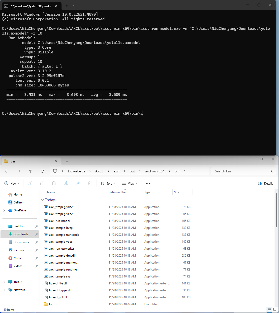

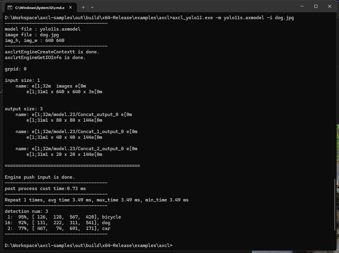

Navigate to the build output directory and execute axcl_run_model.exe -m yolo11s.axmodel -r 10. Please replace it with the actual model file path. Precompiled binaries and model download

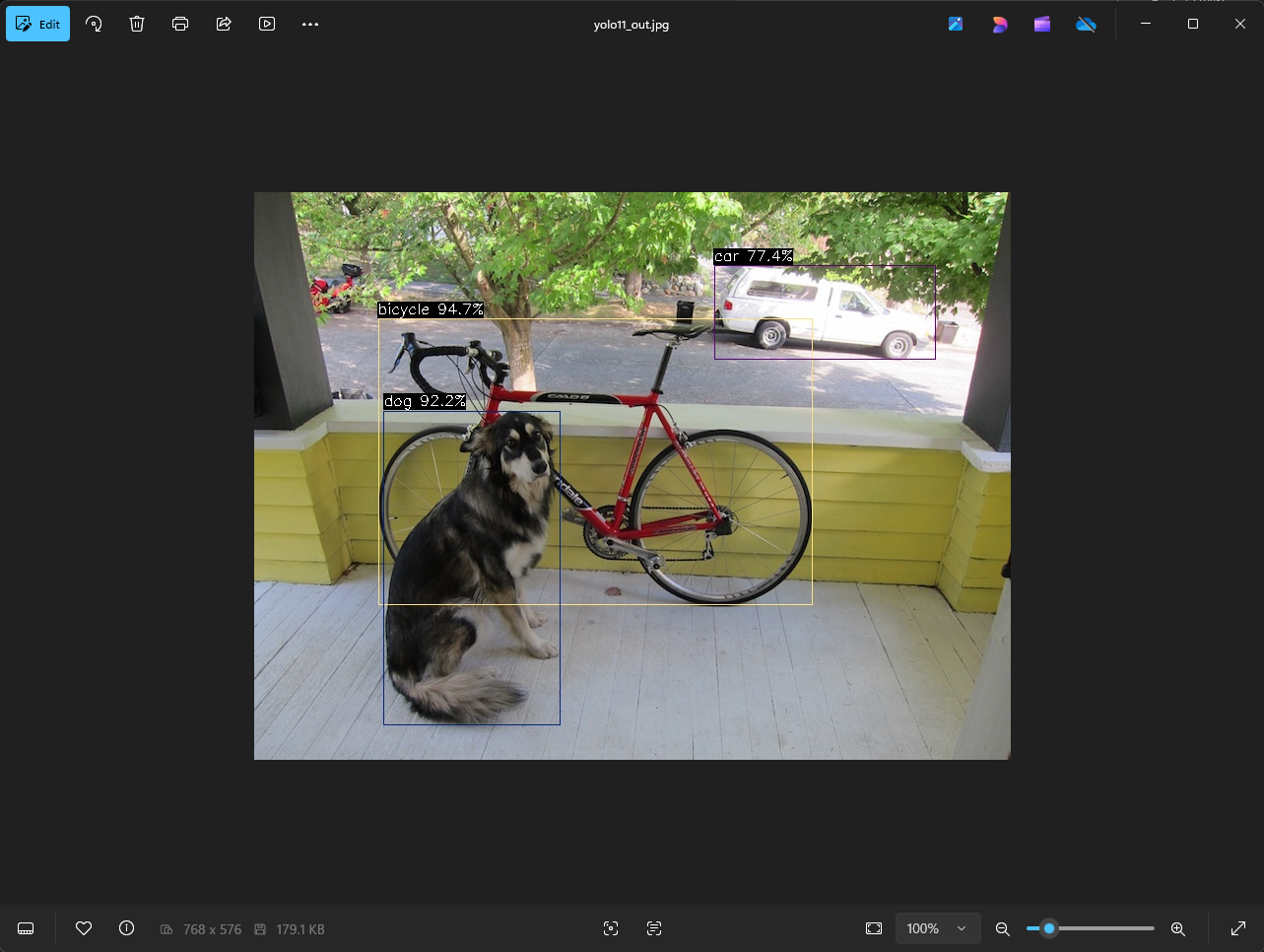

Below is a demonstration of axcl-sample. Precompiled binaries and model download
