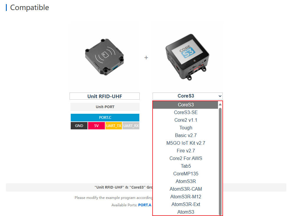

Pin Compatibility
Due to variations in pin configurations across different host devices, please consult the Pin Compatibility Table in the product documentation prior to use. Modify the sample program according to your specific pin connections.

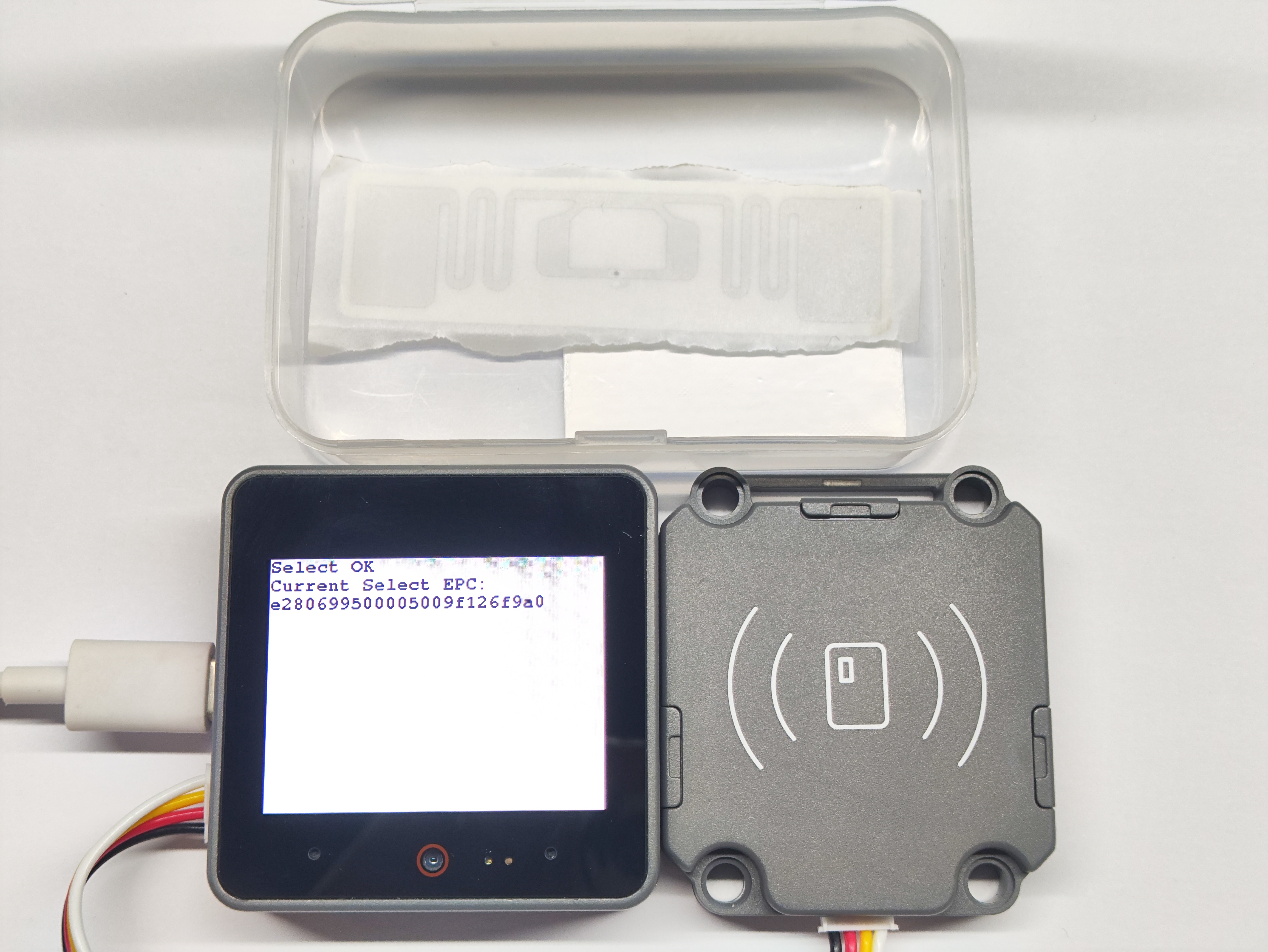

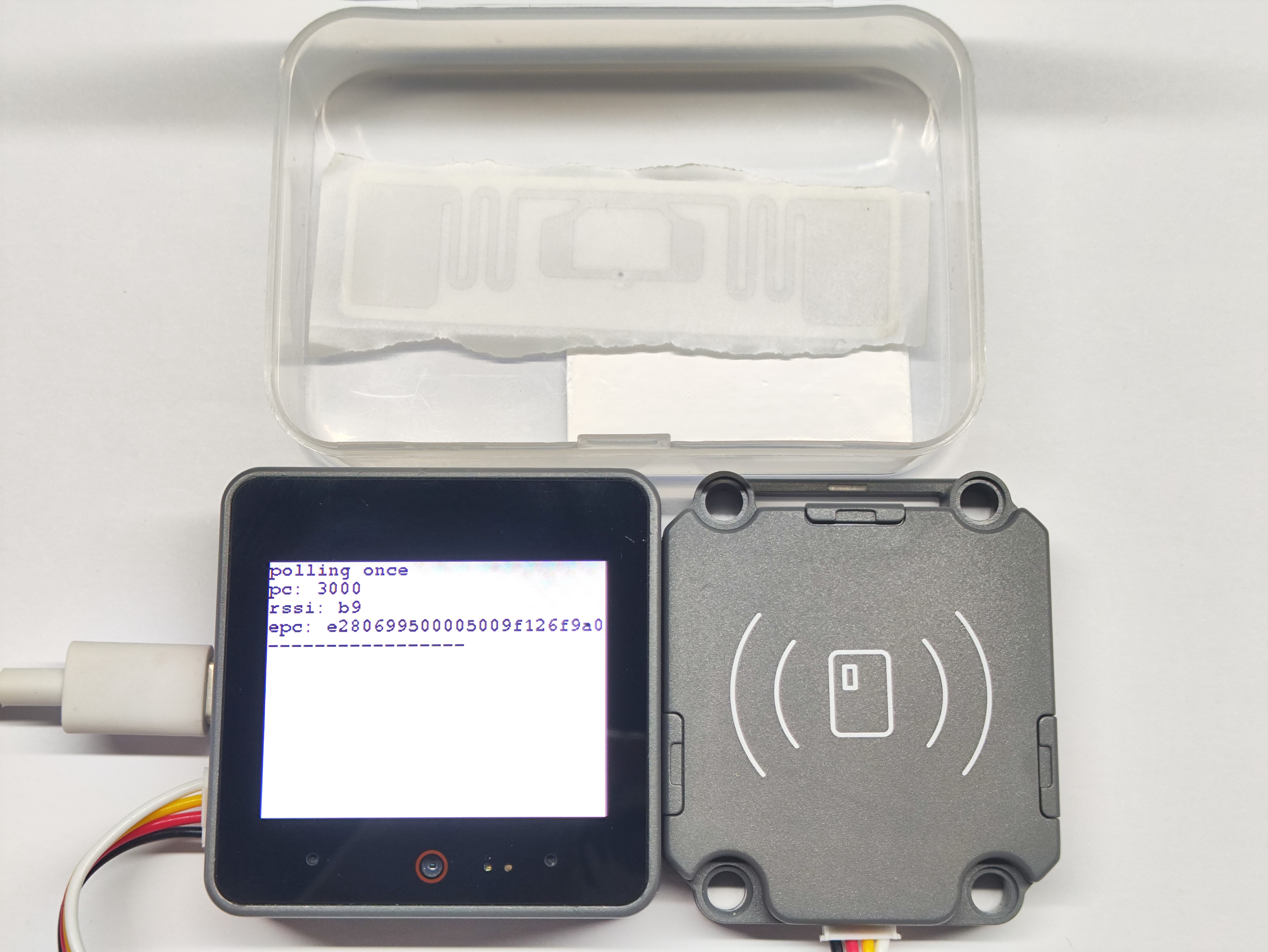

5. Tag Recognition
  • The program starts with a scanning phase. If the scan is successful, the RFID tag's protocol control word, received signal strength indicator, and electronic product code will be displayed on the screen.
  • When multiple tags are present, the RFID module supports selection function. After successful selection, the electronic code of the tag will be displayed.
  • The RFID module can directly read/write the tag's memory area. A successful write will display "Write OK", and a successful read will display "Read OK" and output the newly written data.
