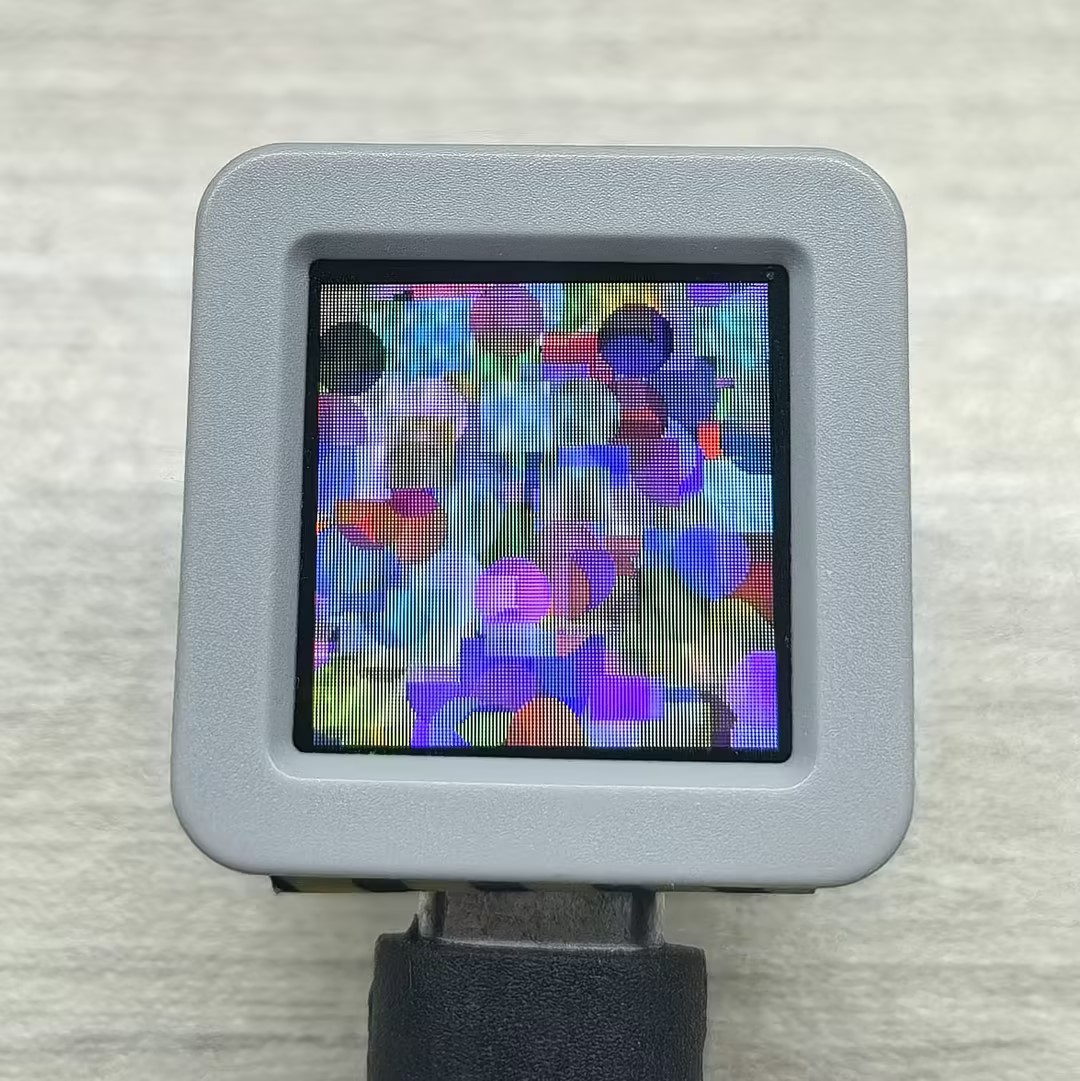

The effect of the example is shown below. The program draws circles and rectangles of different colors at random positions on the screen:
