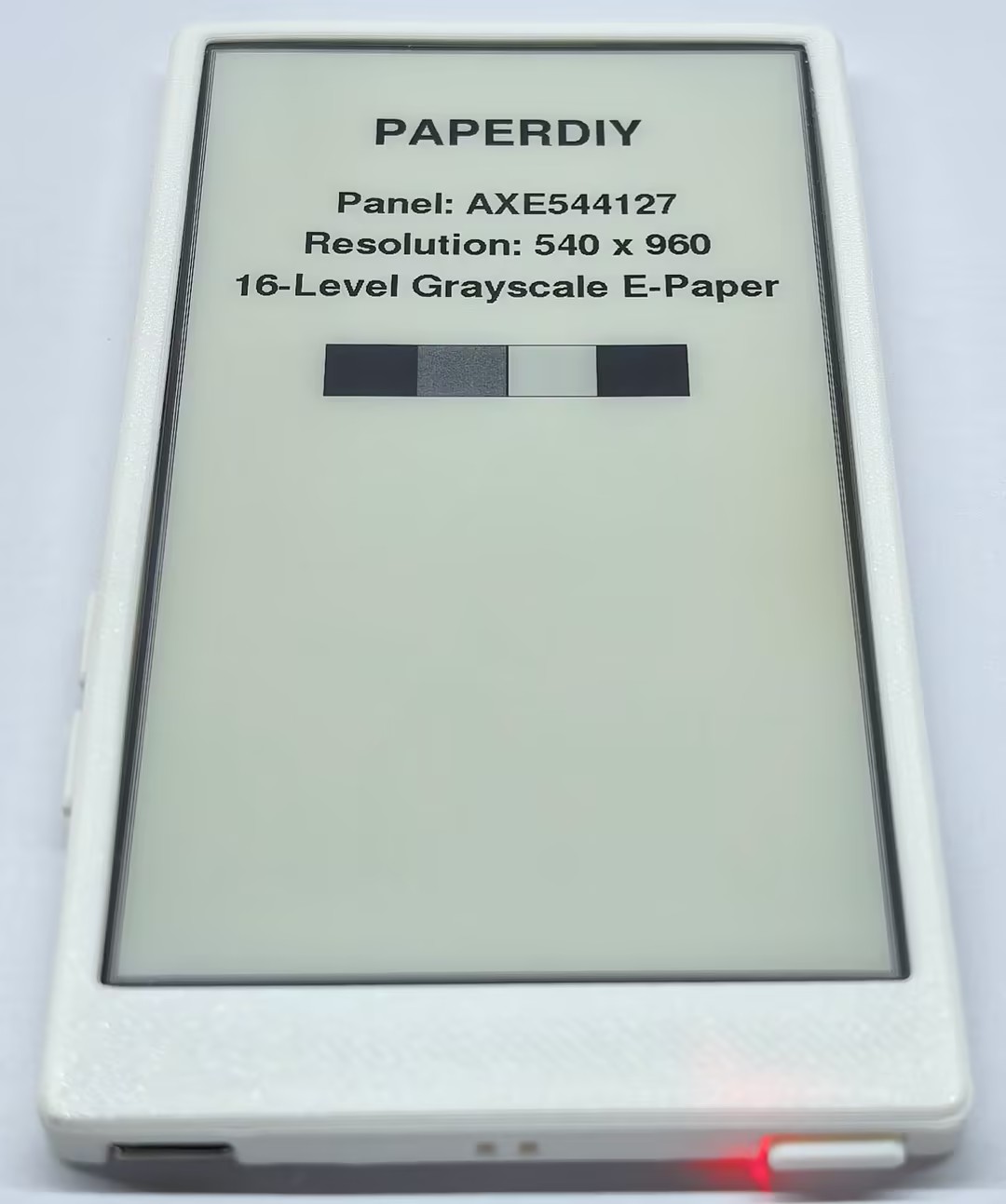

Basic Display
1 2 3 4 5 6 7 8 9 10 11 12 13 14 15 16 17 18 19 20 21 22 23 24 25 26 27 28 29 30 31 32 33 34 35 36 37 38 39 40 41 42 43 44 45 46 47 48 49 50 51 52 53 54 55 56 57 58 59 60 61 62 63 64 65 66 67 68 69 70 71 72 73 74 75
#include <Arduino.h>
#include <M5Unified.h>
M5Canvas canvas(&M5.Display);
static void drawBlackBorder()
    const int screenW = M5.Display.width();
    const int screenH = M5.Display.height();
    canvas.drawRect(0, 0, screenW, screenH, TFT_BLACK);
    canvas.drawRect(2, 2, screenW - 4, screenH - 4, TFT_BLACK);
    canvas.drawRect(4, 4, screenW - 8, screenH - 8, TFT_BLACK);
static void drawMainDemo()
    static const uint16_t diyColors[4] = {
        TFT_BLACK,
        TFT_DARKGREY,
        TFT_LIGHTGREY,
        TFT_BLACK
    canvas.fillSprite(TFT_WHITE);
    drawBlackBorder();
    canvas.setTextDatum(middle_center);
    canvas.setTextColor(TFT_BLACK);
    canvas.setFont(&fonts::FreeSansBold24pt7b);
    canvas.drawString("PAPERDIY", screenW / 2, 115);
    canvas.setFont(&fonts::FreeSansBold18pt7b);
    canvas.drawString("Panel: AXE544127", screenW / 2, 205);
    char resolutionBuf[32];
    snprintf(resolutionBuf, sizeof(resolutionBuf), "Resolution: %d x %d", screenW, screenH);
    canvas.drawString(resolutionBuf, screenW / 2, 255);
    canvas.drawString("16-Level Grayscale E-Paper", screenW / 2, 305);
    const int barX = 120;
    const int barY = 370;
    const int barW = screenW - 240;
    const int barH = 58;
    const int cellW = barW / 4;
    for (int i = 0; i < 4; ++i) {
        const int x = barX + i * cellW;
        const int w = (i == 3) ? (barX + barW - x) : cellW;
        canvas.fillRect(x, barY, w, barH, diyColors[i]);
        canvas.drawRect(x, barY, w, barH, TFT_BLACK);
    canvas.pushSprite(0, 0);
void setup()
    auto cfg = M5.config();
    cfg.clear_display = false;
    M5.begin(cfg);
    M5.Display.setEpdMode(epd_mode_t::epd_quality);
    canvas.createSprite(M5.Display.width(), M5.Display.height());
    drawMainDemo();
void loop()
    M5.update();
    delay(100);

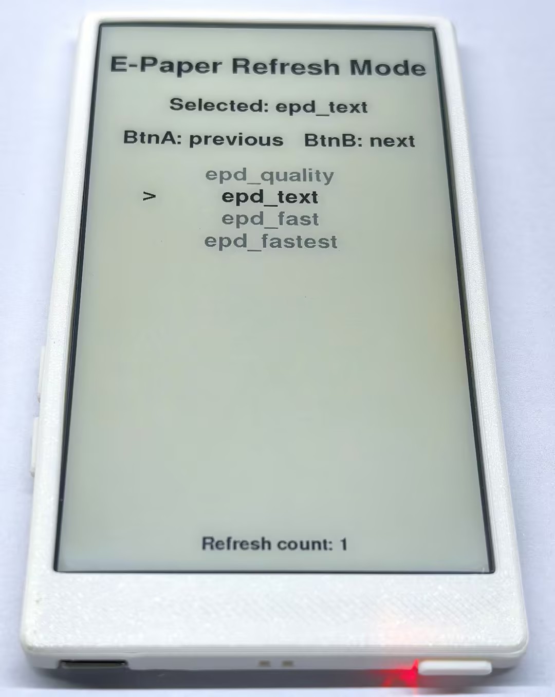

Refresh Modes
PaperDIY supports the following four e-paper refresh modes. Faster refresh usually provides lower display quality and weaker ghosting control, while the actual refresh time also depends on the image content. The program below uses the two user buttons to select a refresh mode and refreshes the screen once after each selection.
M5.Display.setEpdMode(epd_mode_t::epd_quality); // High quality, slowest refresh
M5.Display.setEpdMode(epd_mode_t::epd_text);    // Text mode, faster refresh
M5.Display.setEpdMode(epd_mode_t::epd_fast);    // Fast refresh
M5.Display.setEpdMode(epd_mode_t::epd_fastest); // Fastest refresh
After M5.Display.setEpdMode() is called, subsequent screen updates use the selected mode. epd_text is recommended for text interfaces, while epd_quality is suitable for images or scenes requiring better grayscale performance. After several consecutive partial fast refreshes, perform a full-screen high-quality refresh to reduce ghosting.
1 2 3 4 5 6 7 8 9 10 11 12 13 14 15 16 17 18 19 20 21 22 23 24 25 26 27 28 29 30 31 32 33 34 35 36 37 38 39 40 41 42 43 44 45 46 47 48 49 50 51 52 53 54 55 56 57 58 59 60 61 62 63 64 65 66 67 68 69 70 71 72 73 74 75 76 77 78 79 80 81 82 83 84 85 86 87
struct ModeOption {
    const char* name;
    epd_mode_t mode;
const ModeOption modeOptions[] = {
    {"epd_quality", epd_mode_t::epd_quality},
    {"epd_text", epd_mode_t::epd_text},
    {"epd_fast", epd_mode_t::epd_fast},
    {"epd_fastest", epd_mode_t::epd_fastest},
constexpr std::size_t MODE_COUNT = sizeof(modeOptions) / sizeof(modeOptions[0]);
std::size_t selectedMode = 0;
uint32_t refreshCount = 0;
void drawScreen()
    const int w = M5.Display.width();
    const int h = M5.Display.height();
    canvas.drawString("E-Paper Refresh Mode", w / 2, 90);
    char selectedText[48];
    snprintf(selectedText, sizeof(selectedText), "Selected: %s", modeOptions[selectedMode].name);
    canvas.drawString(selectedText, w / 2, 175);
    canvas.drawString("BtnA: previous   BtnB: next", w / 2, 245);
    for (std::size_t i = 0; i < MODE_COUNT; ++i) {
        const int y = 315 + static_cast<int>(i) * 42;
        const bool selected = i == selectedMode;
        canvas.setTextColor(selected ? TFT_BLACK : TFT_DARKGREY);
        canvas.drawString(selected ? ">" : " ", w / 2 - 180, y);
        canvas.drawString(modeOptions[i].name, w / 2, y);
    canvas.setFont(&fonts::FreeSansBold12pt7b);
    char countText[32];
    snprintf(countText, sizeof(countText), "Refresh count: %lu", (unsigned long)refreshCount);
    canvas.drawString(countText, w / 2, h - 35);
void selectMode(std::size_t index)
    selectedMode = index % MODE_COUNT;
    M5.Display.setEpdMode(modeOptions[selectedMode].mode);
    ++refreshCount;
    drawScreen();
void setup()
    M5.begin(cfg);
    drawScreen();
void loop()
    M5.update();
    if (M5.BtnA.wasPressed()) {
        selectMode(selectedMode + MODE_COUNT - 1);
    if (M5.BtnB.wasPressed()) {
        selectMode(selectedMode + 1);
    delay(20);
