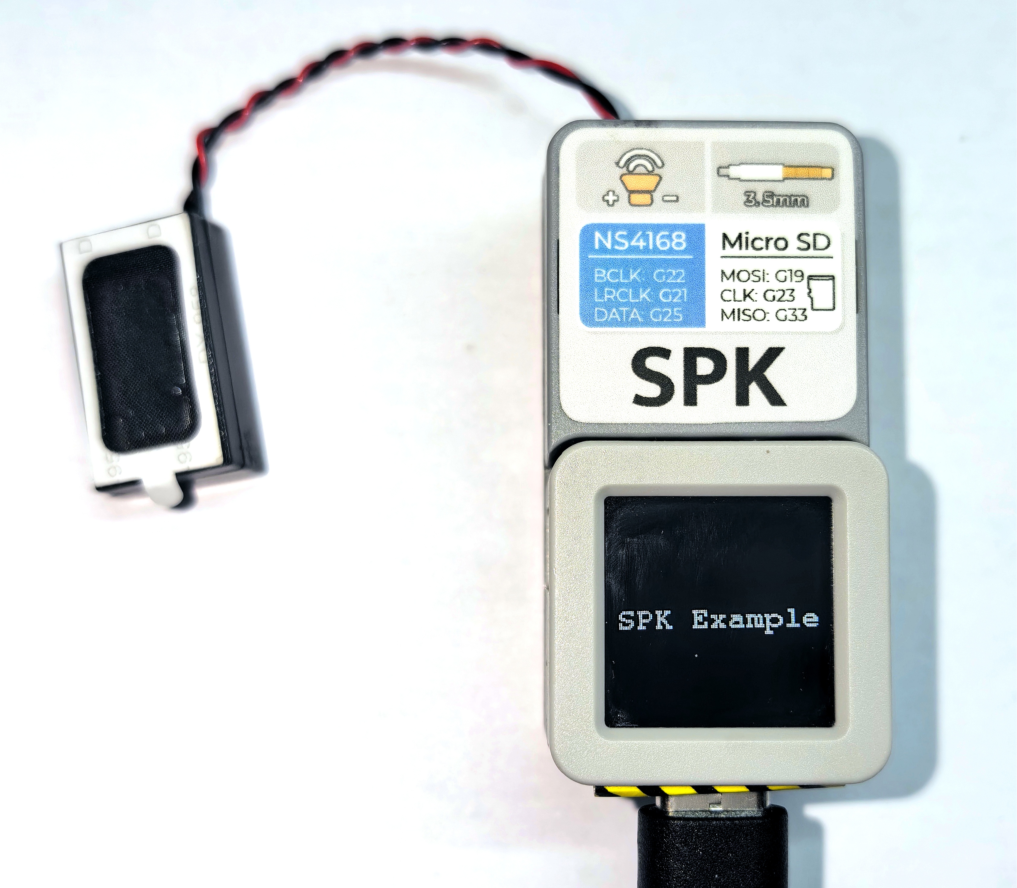

2.1 Basic Usage
Based on M5Unified Speaker API
1 2 3 4 5 6 7 8 9 10 11 12 13 14 15 16 17 18 19 20 21 22 23 24 25 26 27 28 29 30 31 32 33 34 35 36 37 38 39 40 41
#include <M5Unified.h>
#include <M5GFX.h>
// Define I2S audio pins connected to the speaker
#define PIN_DATA 38      // Data output pin for audio signal
#define PIN_BCLK 5       // Bit clock pin for I2S communication
#define PIN_LRCK 39      // Left/Right clock pin for channel selection
// Set audio output sample rate (44.1kHz is standard for audio)
static constexpr const size_t output_samplerate = 44100;
void setup() {
    M5.begin();
    M5.Display.setFont(&fonts::FreeMonoBold9pt7b);
    M5.Display.drawCenterString("SPK Example", 64, 60);
    // Configure speaker settings using I2S protocol
    m5::speaker_config_t spk_cfg = {
      .pin_data_out = PIN_DATA,          // Assign data pin
      .pin_bck = PIN_BCLK,               // Assign bit clock pin
      .pin_ws = PIN_LRCK,                // Assign left/right clock pin
      .sample_rate = output_samplerate,  // Set audio sample rate
      .dma_buf_len = 256,                // DMA buffer length (for smooth audio)
      .dma_buf_count = 6,                // Number of DMA buffers (double buffering)
      .i2s_port = i2s_port_t::I2S_NUM_0  // Specify I2S hardware port
    M5.Speaker.config(spk_cfg);  // Apply the speaker configuration
    M5.Speaker.begin();  // Initialize the speaker hardware
    M5.Speaker.setVolume(128);
void loop() {
    // Play 6000Hz tone for 100ms
    M5.Speaker.tone(6000, 100);
    delay(1000);
    // Play 2000Hz tone for 20ms
    M5.Speaker.tone(2000, 20);
    delay(1000);

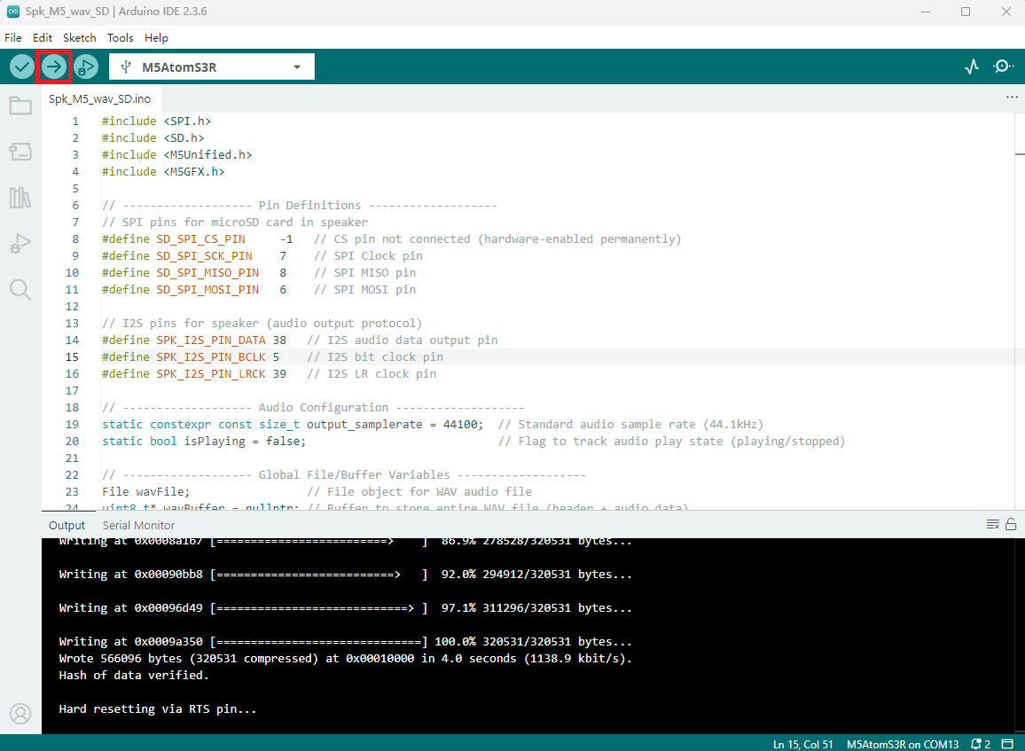

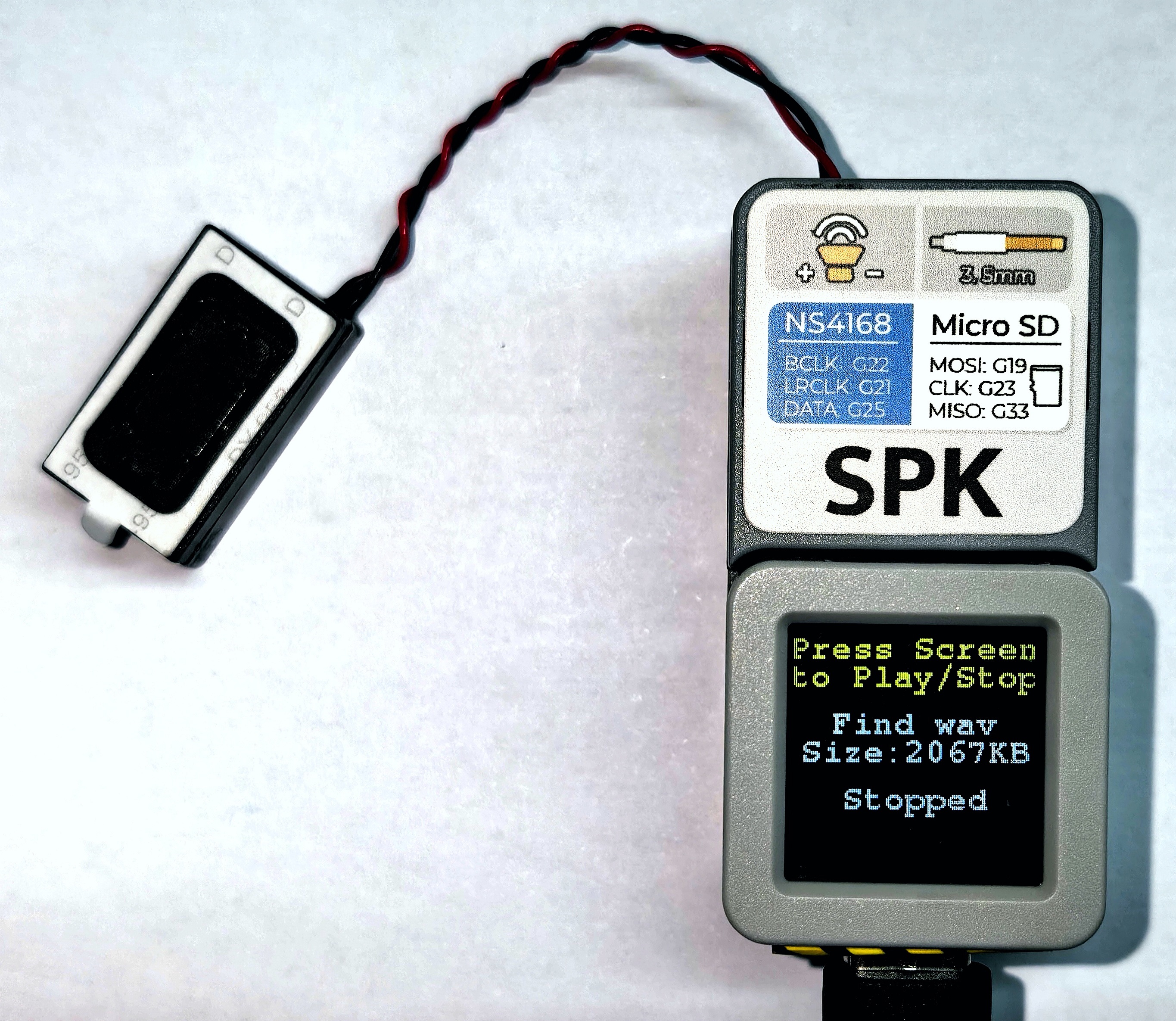

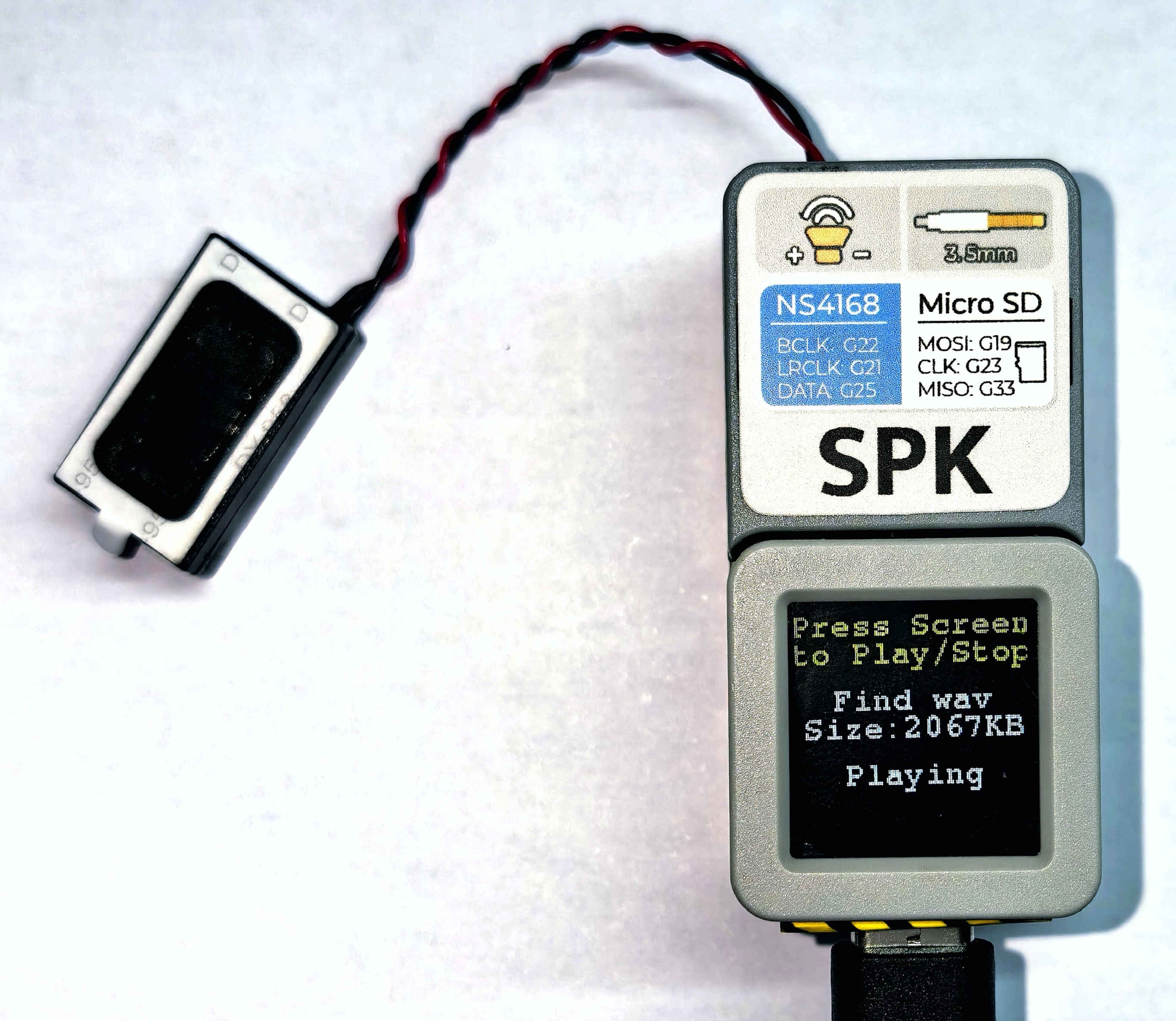

2.2 Play Audio Files (wav format) from SD Card
1 2 3 4 5 6 7 8 9 10 11 12 13 14 15 16 17 18 19 20 21 22 23 24 25 26 27 28 29 30 31 32 33 34 35 36 37 38 39 40 41 42 43 44 45 46 47 48 49 50 51 52 53 54 55 56 57 58 59 60 61 62 63 64 65 66 67 68 69 70 71 72 73 74 75 76 77 78 79 80 81 82 83 84 85 86 87 88 89 90 91 92 93 94 95 96 97 98 99 100 101 102 103 104 105 106 107 108 109 110 111 112 113 114 115 116 117 118 119 120 121 122 123 124 125 126 127 128 129 130 131
#include <SPI.h>
#include <SD.h>
#include <M5GFX.h>
// ------------------- Pin Definitions -------------------
// SPI pins for microSD card in speaker
#define SD_SPI_CS_PIN     -1   // CS pin not connected (hardware-enabled permanently)
#define SD_SPI_SCK_PIN    7    // SPI Clock pin
#define SD_SPI_MISO_PIN   8    // SPI MISO pin
#define SD_SPI_MOSI_PIN   6    // SPI MOSI pin
// I2S pins for speaker (audio output protocol)
#define SPK_I2S_PIN_DATA 38   // I2S audio data output pin
#define SPK_I2S_PIN_BCLK 5    // I2S bit clock pin
#define SPK_I2S_PIN_LRCK 39   // I2S LR clock pin
// ------------------- Audio Configuration -------------------
static constexpr const size_t output_samplerate = 44100;  // Standard audio sample rate (44.1kHz)
static bool isPlaying = false;                            // Flag to track audio play state (playing/stopped)
// ------------------- Global File/Buffer Variables -------------------
File wavFile;                 // File object for WAV audio file
uint8_t* wavBuffer = nullptr; // Buffer to store entire WAV file (header + audio data)
size_t wavBufferLen = 0;      // Total length of WAV data in buffer
void setup() {
    M5.begin();
    Serial.begin(115200);
    // ------------------- SD Card Initialization -------------------
    SPI.begin(SD_SPI_SCK_PIN, SD_SPI_MISO_PIN, SD_SPI_MOSI_PIN, SD_SPI_CS_PIN);
    M5.Display.drawCenterString("SD Init...", 64, 0);
    Serial.println("SD Init...");
    // Attempt SD card init (25MHz SPI speed); halt on failure
    if (!SD.begin(SD_SPI_CS_PIN, SPI, 25000000)) {
        M5.Display.clear();
        M5.Display.drawCenterString("SD Error!", 64, 50);
        Serial.println("SD Error!");
        while (1);  // Infinite loop = halt if SD card fails
    } else {
        M5.Display.clear();
        M5.Display.drawCenterString("SD Ready", 64, 0);
        Serial.println("SD Ready");
    // ------------------- Speaker Configuration (I2S) -------------------
        .pin_data_out = SPK_I2S_PIN_DATA,
        .pin_bck = SPK_I2S_PIN_BCLK,
        .pin_ws = SPK_I2S_PIN_LRCK,
        .dma_buf_len = 256,    // DMA buffer size (larger = smoother audio)
        .dma_buf_count = 6,    // Number of DMA buffers (double-buffering for stability)
        .i2s_port = i2s_port_t::I2S_NUM_0  // Use I2S hardware port 0
    M5.Speaker.config(spk_cfg);  // Apply speaker settings
    // Initialize speaker; halt on failure
    if(!M5.Speaker.begin()){
        M5.Display.drawCenterString("SPK Error!", 64, 50);
        Serial.println("SPK Error!");
        while (1);
    } else {
        M5.Display.drawCenterString("SPK Ready", 64, 15);
        Serial.println("SPK Ready\n");
    delay(1000);
    // ------------------- Display Initial Instructions -------------------
    M5.Display.clear();
    M5.Display.setTextColor(TFT_YELLOW);
    M5.Display.drawCenterString("Press Screen", 64, 0);
    M5.Display.drawCenterString("to Play/Stop", 64, 15);
    M5.Display.setTextColor(TFT_WHITE);
    // ------------------- Load WAV File from SD Card -------------------
    wavFile = SD.open("/twinkle_twinkle.wav", FILE_READ);  // Open WAV file
    // Halt if WAV file not found
    if (!wavFile) {
        M5.Display.drawCenterString("Find wav Error!", 64, 40);
        Serial.println("Find wav Error!");
        while (1);
    } else {
        M5.Display.drawCenterString("Find wav", 64, 40);
        Serial.println("Find wav");
    // Allocate buffer to store entire WAV file (avoids repeated SD reads)
    wavBufferLen = wavFile.size();  // Get total file size
    wavBuffer = (uint8_t*)malloc(wavBufferLen);  // Allocate memory

// -------------------- Pin Definitions --------------------
// SPI pins for microSD card (connected to speaker module)
#define SD_SPI_SCK_PIN    GPIO_NUM_7  // SPI Clock pin
#define SD_SPI_MISO_PIN   GPIO_NUM_8  // SPI MISO pin
#define SD_SPI_MOSI_PIN   GPIO_NUM_6  // SPI MOSI pin
#define SPK_I2S_PIN_DATA  GPIO_NUM_38  // I2S audio data output pin
#define SPK_I2S_PIN_BCLK  GPIO_NUM_5   // I2S bit clock pin
#define SPK_I2S_PIN_LRCK  GPIO_NUM_39  // I2S LR clock pin
static constexpr const size_t output_samplerate = 44100;  // Fixed audio sample rate (44.1kHz, standard for audio)
    M5.Display.clear();
    M5.Display.setTextColor(TFT_YELLOW);  // Highlight instructions in yellow
    M5.Display.setTextColor(TFT_WHITE);   // Reset text color to white for status
    wavFile = SD.open("/twinkle_twinkle.wav", FILE_READ);  // Open WAV file in read-only mode
    // Halt if WAV file is not found (critical error)
    if (!wavFile) {
        while (1);
    } else {
    // Allocate buffer to store entire WAV file (avoids repeated SD card reads during playback)
    wavBufferLen = wavFile.size();  // Get total file size (bytes)
    wavBuffer = (uint8_t*)malloc(wavBufferLen);  // Allocate memory for buffer
    // Halt if memory allocation fails (not enough RAM for audio data)
    if (wavBuffer == nullptr) {
        Serial.println("Memory Error!");
        wavFile.close();
        while (1);
    } else {
        wavFile.read(wavBuffer, wavBufferLen);  // Read entire file into buffer
        wavFile.close();                        // Close file (buffer now holds all data)
        // Display WAV file size (convert bytes to KB for readability)
        String str_buf = String("Size:") + wavBufferLen/1024 + "KB";
        M5.Display.drawCenterString(str_buf, 64, 55);
        Serial.printf("Size: %d KB\n", wavBufferLen/1024);
    M5.Display.drawCenterString("Stopped", 64, 80);  // Show initial state (stopped)

        if (isPlaying) {
            M5.Display.drawCenterString("Playing", 64, 80);
            playWav(wavBuffer, wavBufferLen, -1, -1, true);// Infinite loop

3. Compile & Upload
  • 1.Download Mode: Before flashing programs to different devices, download mode is required. This step may vary depending on the main control device used. For details, refer to the device program download tutorial list at the bottom of the Arduino IDE Getting Started Tutorial page to view the specific operation method.
  • For AtomS3R, press and hold the reset button (for about 2 seconds) until the internal green LED lights up, then release. At this point, the device has entered download mode and is ready for flashing.
  • 2.Select the device port, click the compile/upload button in the upper left corner of the Arduino IDE, and wait for the program to finish compiling and uploading to the device.

  • 1.Basic Usage
This example makes the speaker emit beeping sounds at intervals in a loop.
  • 2.Play WAV Files from SD Card
By pressing the screen of the main control device, you can control audio playback and stopping. The playback/stop states are displayed on the screen as shown below.
(This example plays a twinkle_twinkle.wav file in wav format stored in the SD card. Here you can download it, please change the file extension to .wav after downloading)
