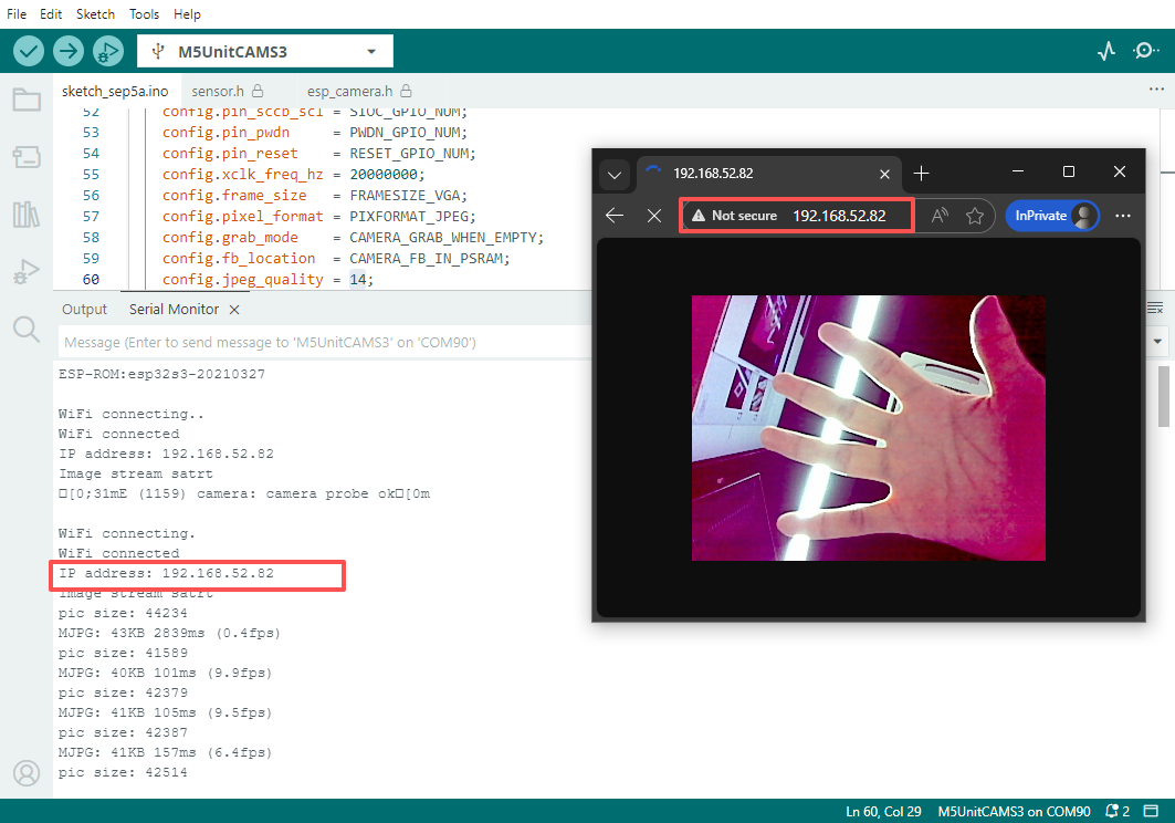

Unit CamS3-5MP has two versions of built-in firmware. Before use, please refer to Unit CamS3-5MP Quick Start to read version information, and configure the corresponding compilation environment according to the actual version in use.
Wi-Fi information needs to be configured before flashing. After completing the firmware flashing, check the device IP via the serial monitor and access it.
The current demo defaults to a resolution of FRAMESIZE_VGA(640x480). To modify to other resolutions, please refer to the configuration below. For large resolutions, due to the large size of image data, transmission will become slower.

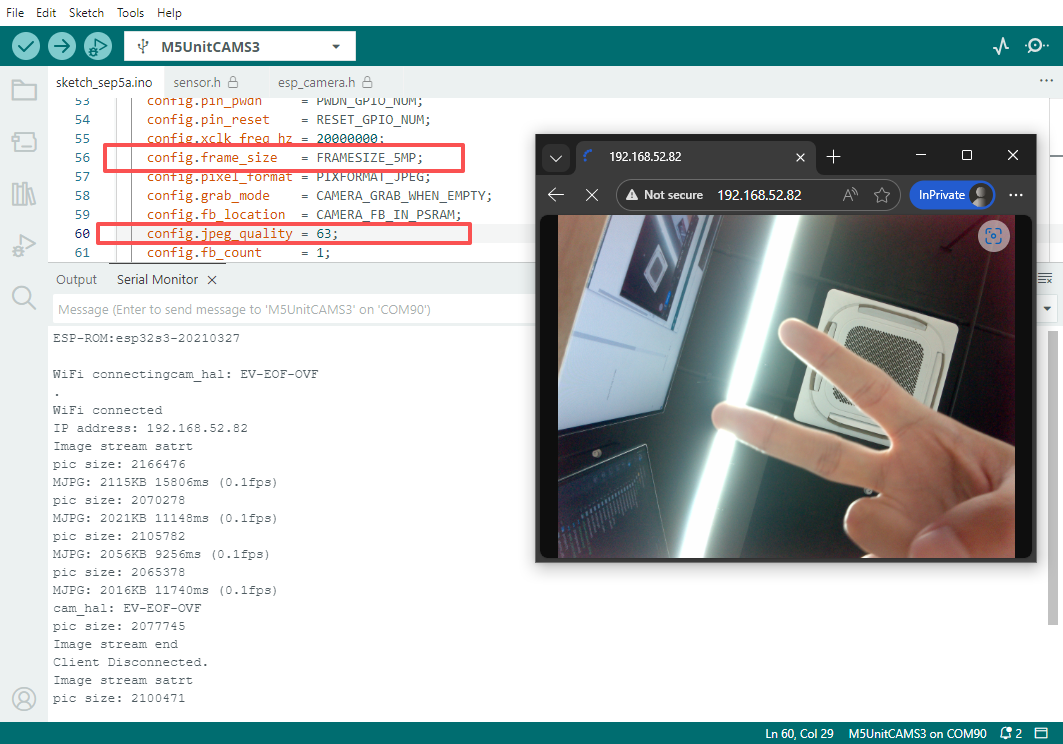

Pixel Switch
When using 5MP resolution, please modify the camera initialization configuration.
config.frame_size   = FRAMESIZE_5MP;
config.jpeg_quality = 63;
