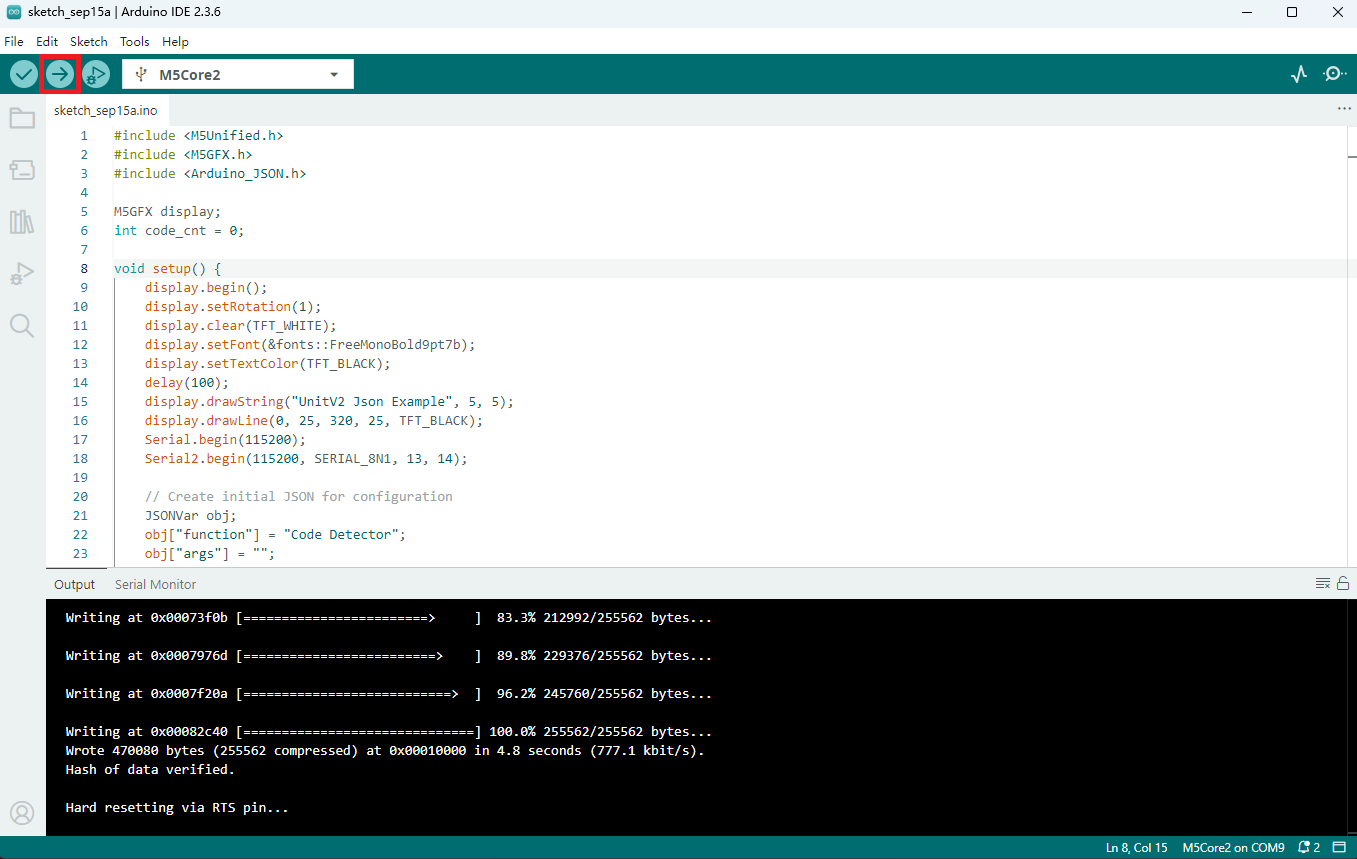

3. Compile and Upload
  • Copy and paste the example code below into your project code area as needed, then select the device port (for details refer to Program Compile and Flash), click the compile and upload button in the top left of Arduino IDE, and wait for the program to finish compiling and uploading to the device.

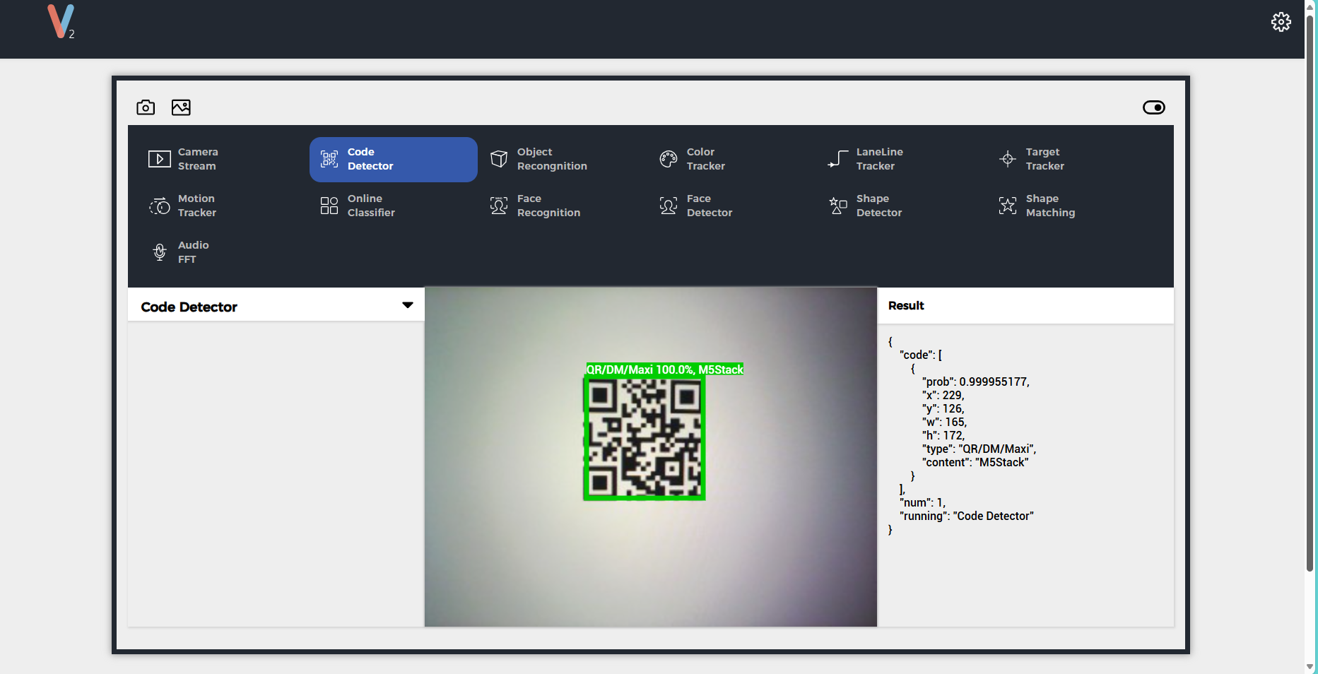

5.2 Code Detector
This example can configure UnitV2 to switch to the QR code recognition function. This function can recognize common codes such as QR codes, barcodes, DataMatrix codes, etc. In a browser, visit the domain name unitv2.py or IP 10.254.239.1 to access the function page. The page content is shown below:
For the JSON data format of the QR code recognition function, see here.

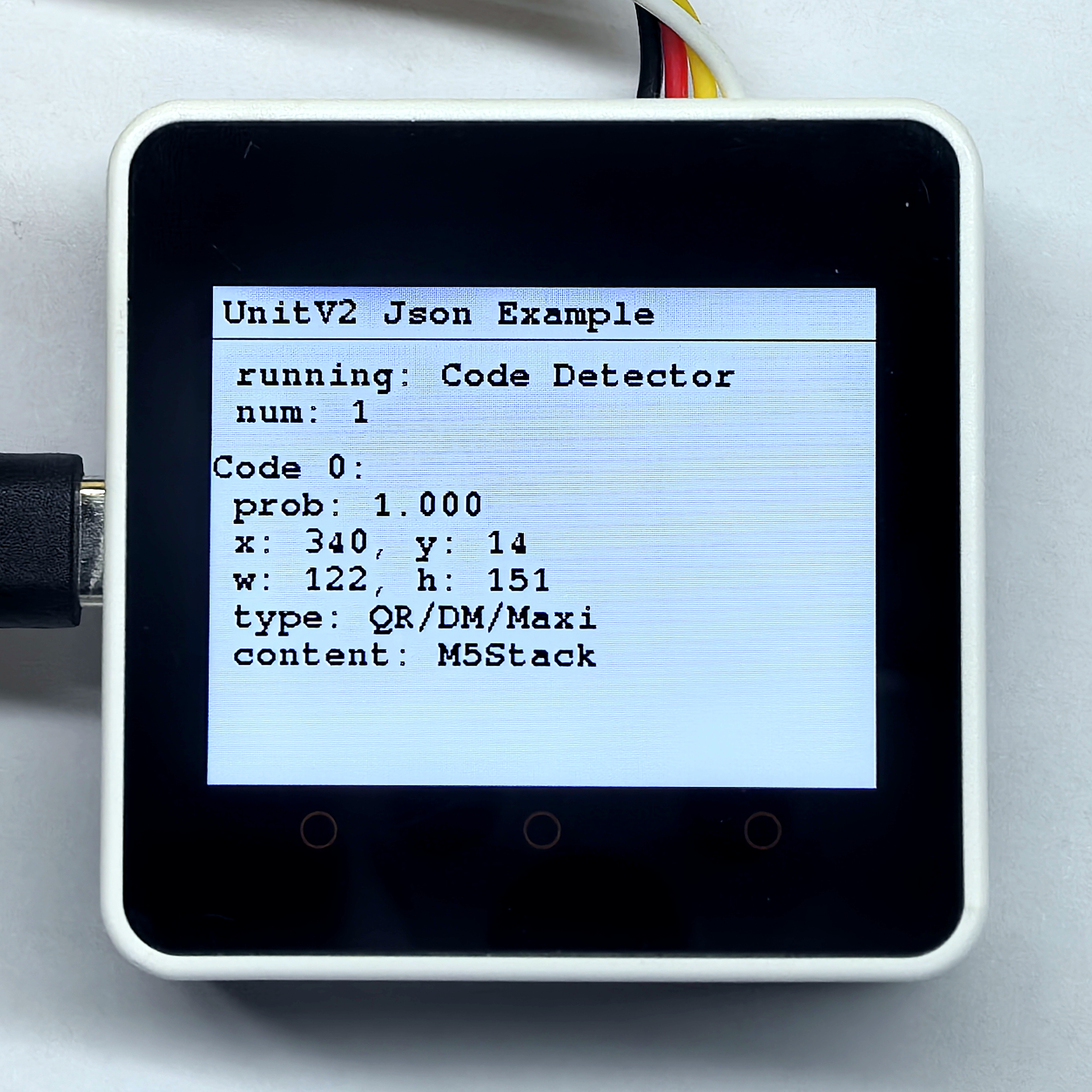

Scan the QR code on the left below; the recognition result is shown in the right image.

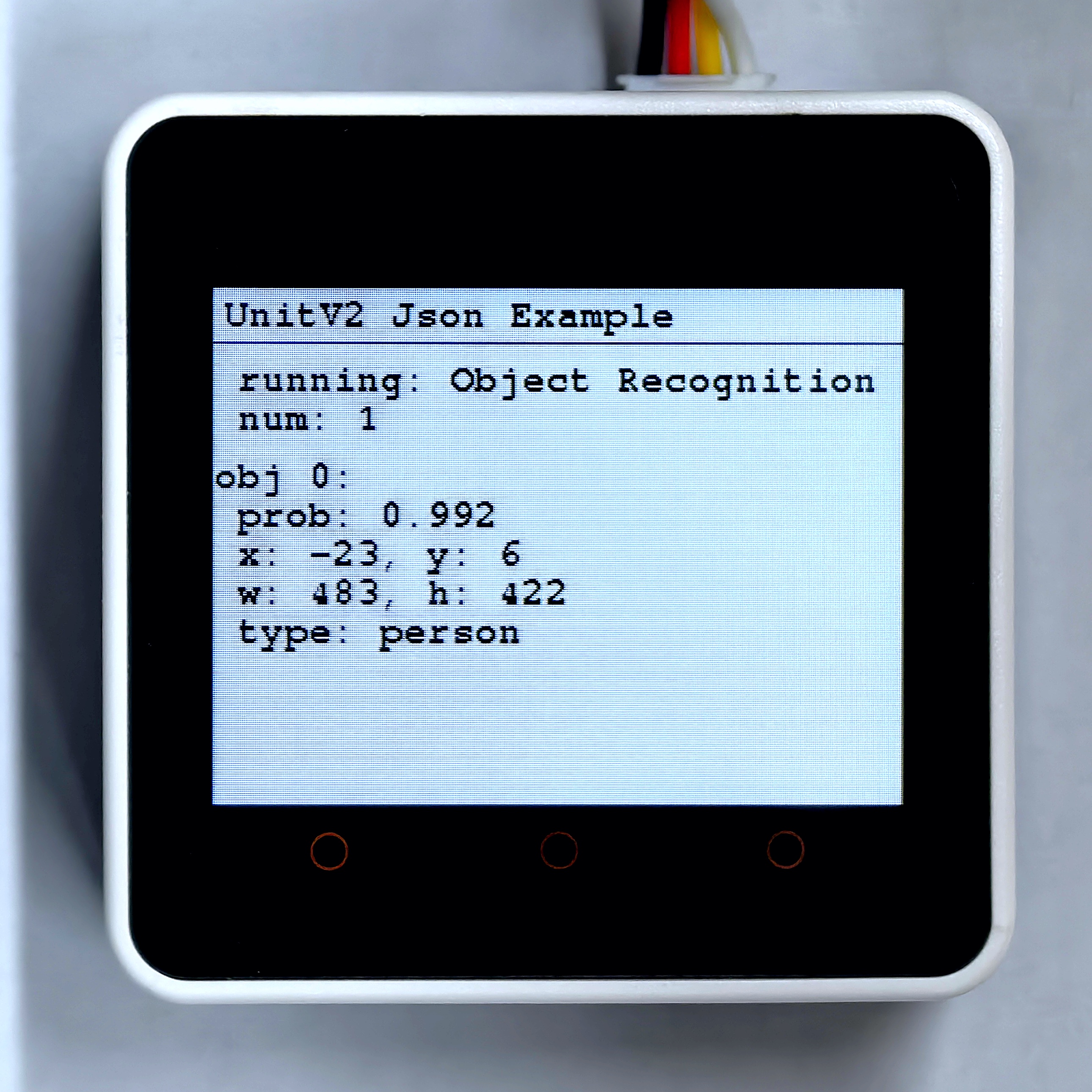

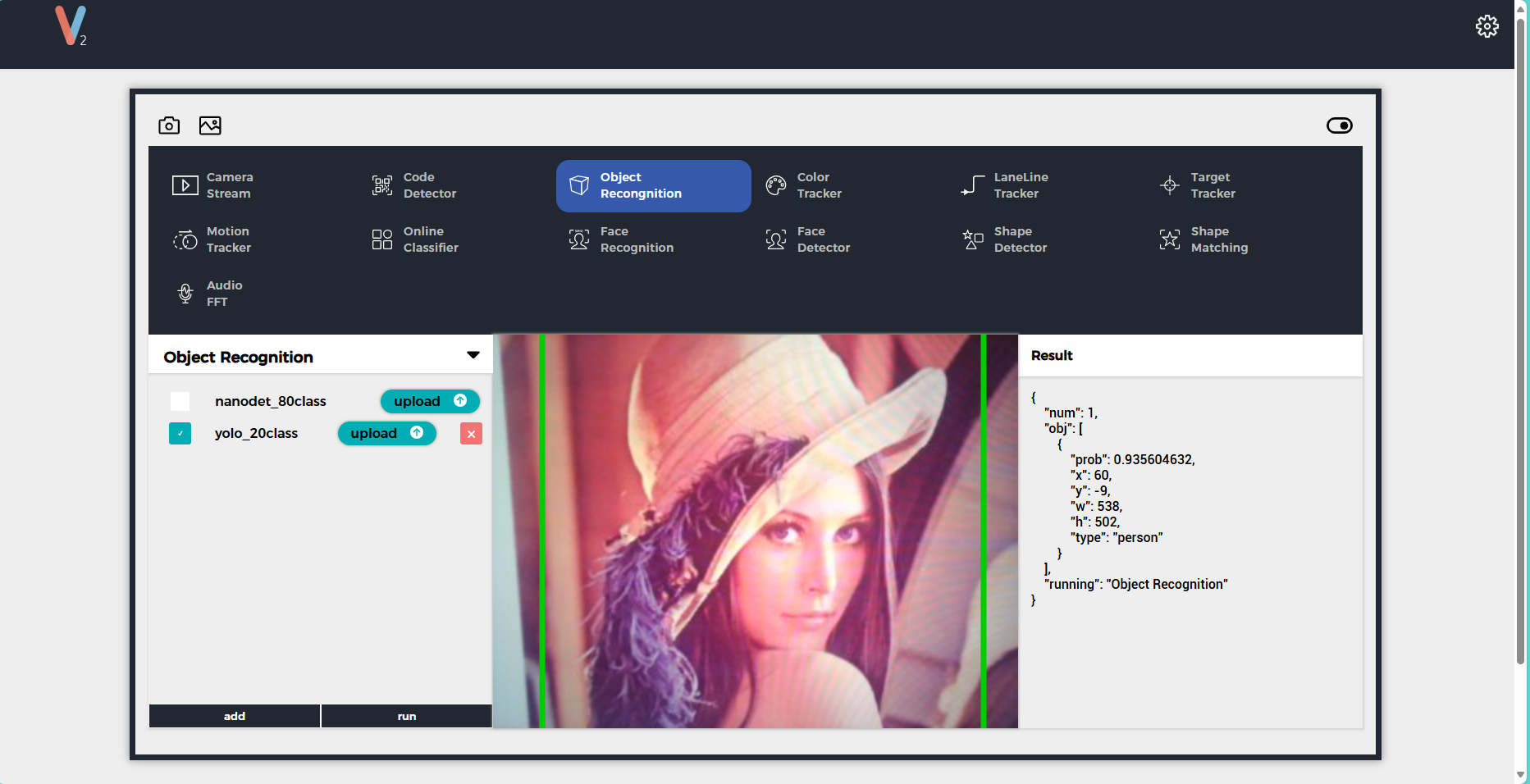

5.3 Object Recognition
This example can configure UnitV2 to switch to the object recognition function. The factory firmware comes with nanodet_80class and yolo_20class models, ready to use. If you wish to train a custom model, check the tutorial UnitV2 V-Training. In a browser, visit unitv2.py or IP 10.254.239.1 to access the function page. The page content is shown below:
For the JSON data format of the object recognition function, see here.

Scan the image on the left below; the recognition result is shown in the right image.

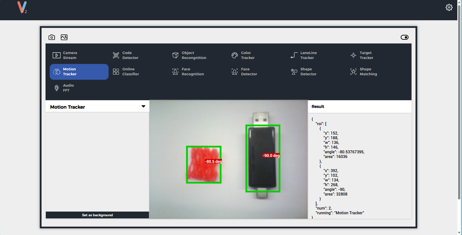

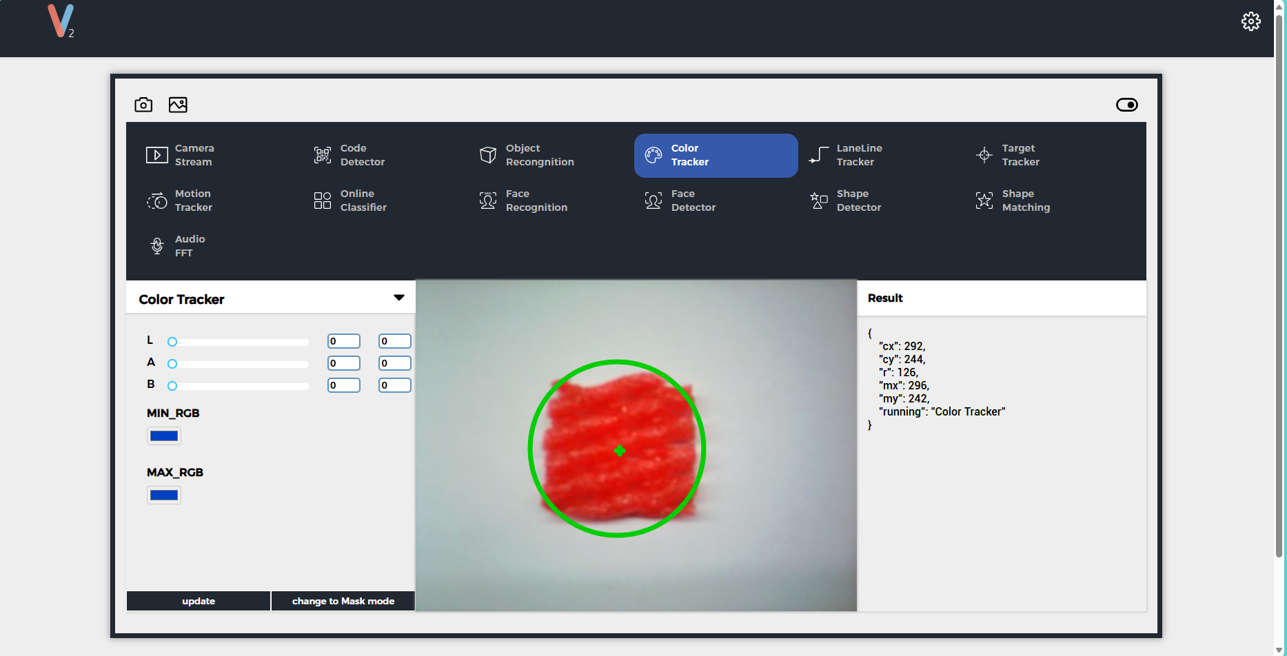

5.4 Color Tracker

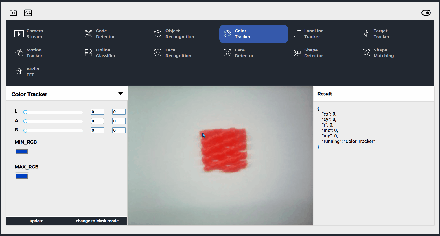

This example can configure UnitV2 to switch to the color tracking function. The color tracking function requires color parameter settings after powering on UnitV2 to work properly. There are two ways to set the color parameters:
1.Click and select the color area to track in the function page image (operation shown below) or enter L, A, B values on the left and click the update button to set.
2.Use JSON settings in the code below. You can set by defining an ROI and auto-analyzing the LAB color value, or by setting the LAB color value directly. The default code uses ROI; to switch to LAB, uncomment #define USING_LAB and enter LAB values as shown:
    LAB["l_min"] = 0;
    LAB["l_max"] = 255;
    LAB["a_min"] = 179;
    LAB["a_max"] = 201;
    LAB["b_min"] = 162;
    LAB["b_max"] = 184;
Access the function page at unitv2.py or IP 10.254.239.1. The page content is shown below:
For the JSON data format of the color tracking function, see here.

#include <M5Unified.h>
#include <M5GFX.h>
#include <Arduino_JSON.h>

            if (color_obj.hasOwnProperty("cx")) {
                int cx   = (int)color_obj["cx"];
                int cy   = (int)color_obj["cy"];
                int r   = (int)color_obj["r"];
                int mx   = (int)color_obj["mx"];
                int my   = (int)color_obj["my"];
                Serial.printf("cx = %d\n", cx);
                Serial.printf("cy = %d\n", cy);
                Serial.printf("r  = %d\n", r);
                Serial.printf("mx = %d\n", mx);
                Serial.printf("my = %d\n", my);
                display.setCursor(0, 60);
                display.printf(" cx = %d\n", cx);
                display.printf(" cy = %d\n", cy);
                display.printf(" r  = %d\n", r);
                display.printf(" mx = %d\n", mx);
                display.printf(" my = %d\n", my);
            Serial.println("<<<<<<<<<<<<<<<<<<<<<<<<<<<<<<<<<<");
When running successfully, the host will display the position, size, etc. of the tracked color block's center point in real time. Result:

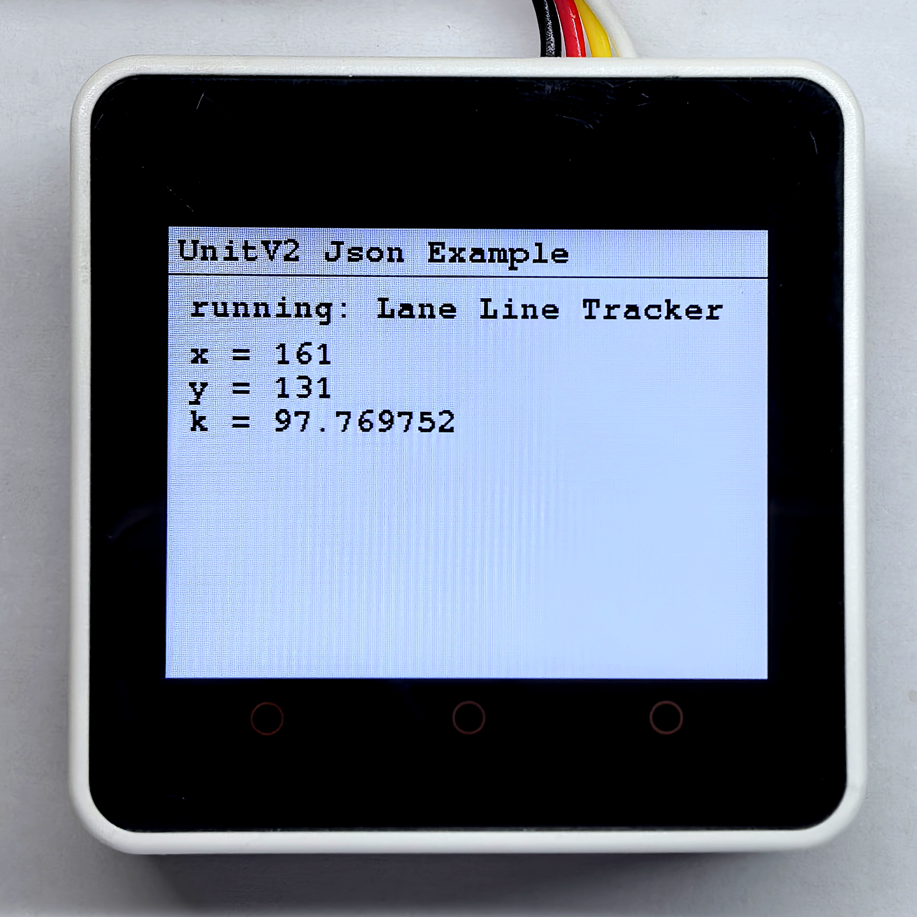

5.5 Lane Line Tracker
Similar to color tracking, lane line tracking requires setting color parameters after powering on UnitV2. See Color Tracking above for parameter setting methods. Visit unitv2.py or IP 10.254.239.1 to access the function page:
The code below uses the ROI method by default. If you want to use the LAB method instead, uncomment #define USING_LAB in the code, and enter the LAB color values in the section shown below.
    LAB["l_min"] = 0;
    LAB["l_max"] = 255;
    LAB["a_min"] = 176;
    LAB["a_max"] = 198;
    LAB["b_min"] = 155;
    LAB["b_max"] = 175;
For the JSON data format of the lane line tracking function, see here.

Scan the left image; result shown on the right:

5.7 Motion Tracker
This example configures UnitV2 for motion tracking. Before using, set a background once for effective tracking. Access via browser: unitv2.py or IP 10.254.239.1.
For JSON format, see here.

When UnitV2 detects motion, it returns position data in real time:

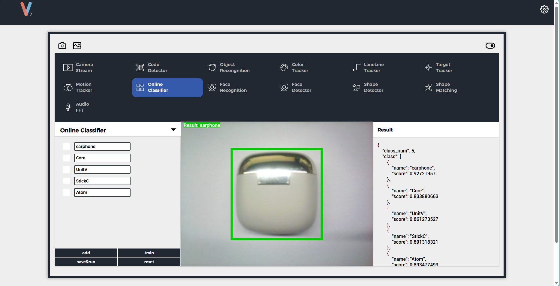

5.8 Online Classifier
This example configures UnitV2 for the online classification function. Factory firmware includes Core, UnitV, StickC, Atom categories. To customize: click add to create, train to train, save&run to save and exit. Access via unitv2.py or IP: 10.254.239.1.
You can also use code functions enter_training_mode, save_and_start. This example creates and trains an earphone category 10 times.
Note
The reset operation (click reset or call enter_training_mode_with_all_classes_clear) permanently deletes all trained categories, including defaults, and they will not be restored after power cycle.
1 2 3 4 5 6 7 8 9 10 11 12 13 14 15 16 17 18 19 20 21 22 23 24 25 26 27 28 29 30 31 32 33 34 35 36 37 38 39 40 41 42 43 44 45 46 47 48 49 50 51 52 53 54 55 56 57 58 59 60 61 62 63 64 65 66 67 68 69 70 71 72 73 74 75 76 77 78 79 80 81 82 83 84 85 86 87 88 89 90 91 92 93 94 95 96 97 98 99 100 101 102 103 104 105 106 107 108 109 110 111 112 113 114 115 116 117 118 119 120 121 122 123 124 125 126 127 128 129 130 131 132

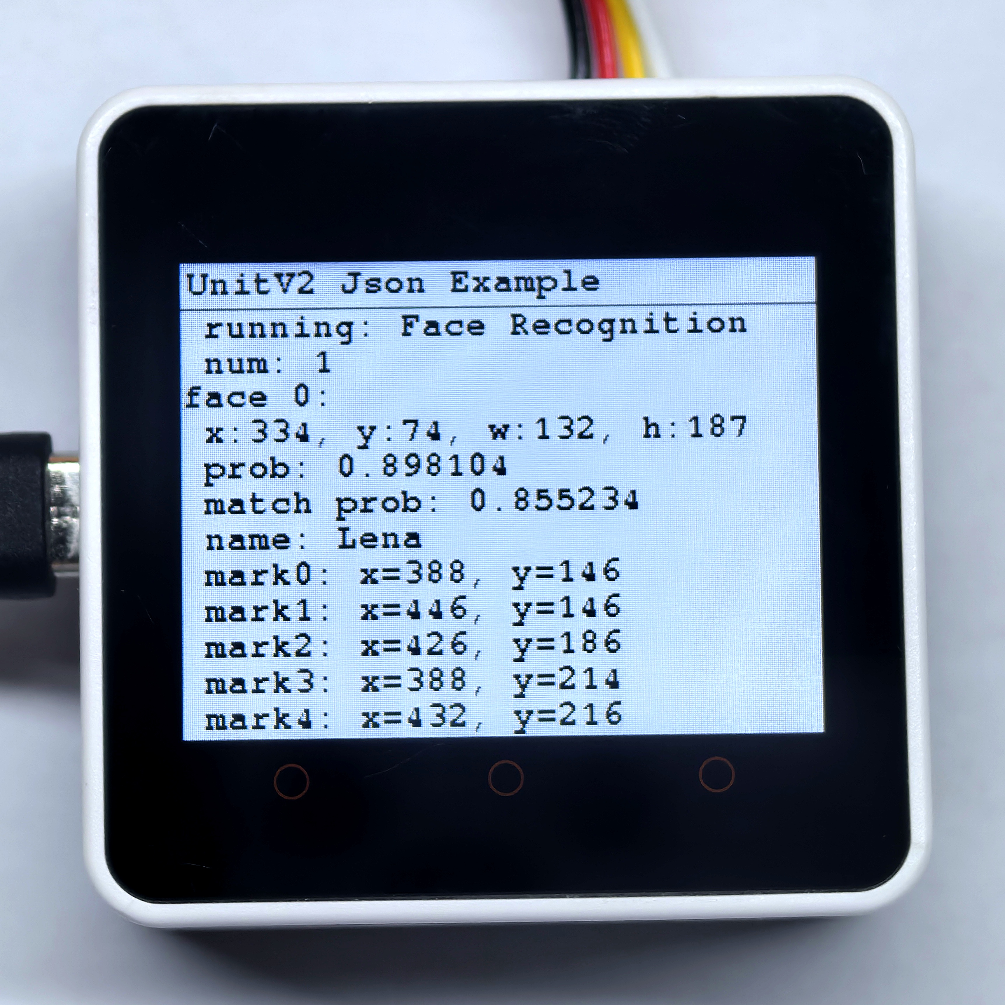

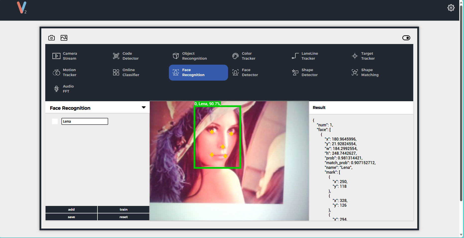

Scan the face on the left; recognition result on the right:

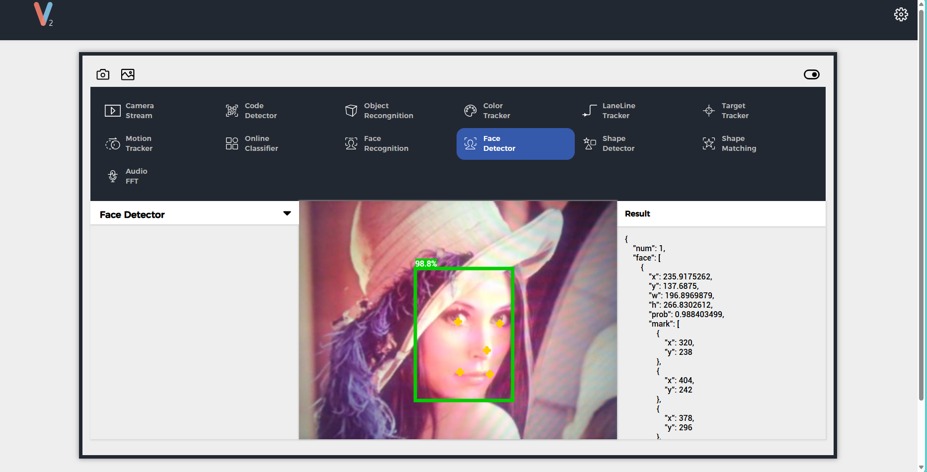

5.10 Face Detector
Configures UnitV2 to the face detection function. Access via unitv2.py or IP: 10.254.239.1.

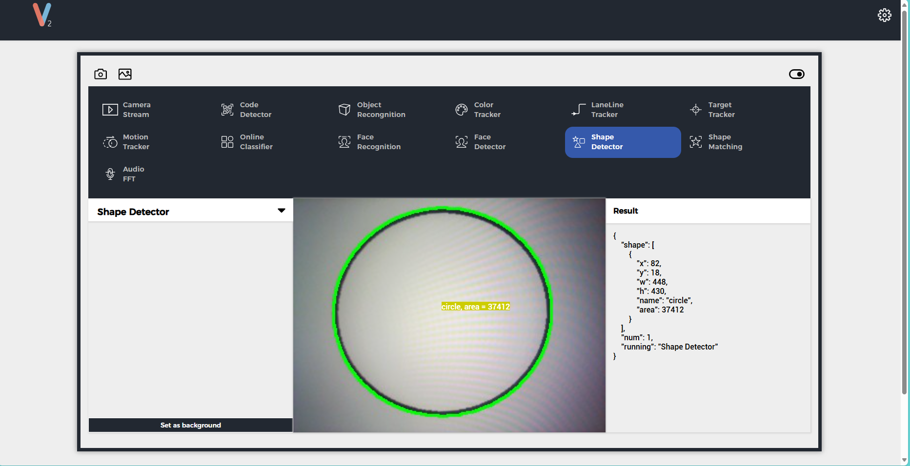

Scan the left face; detection result on the right:
5.11 Shape Detector
Configures UnitV2 to the shape detection function. Before use, set the background once. Access via browser: unitv2.py or IP: 10.254.239.1.

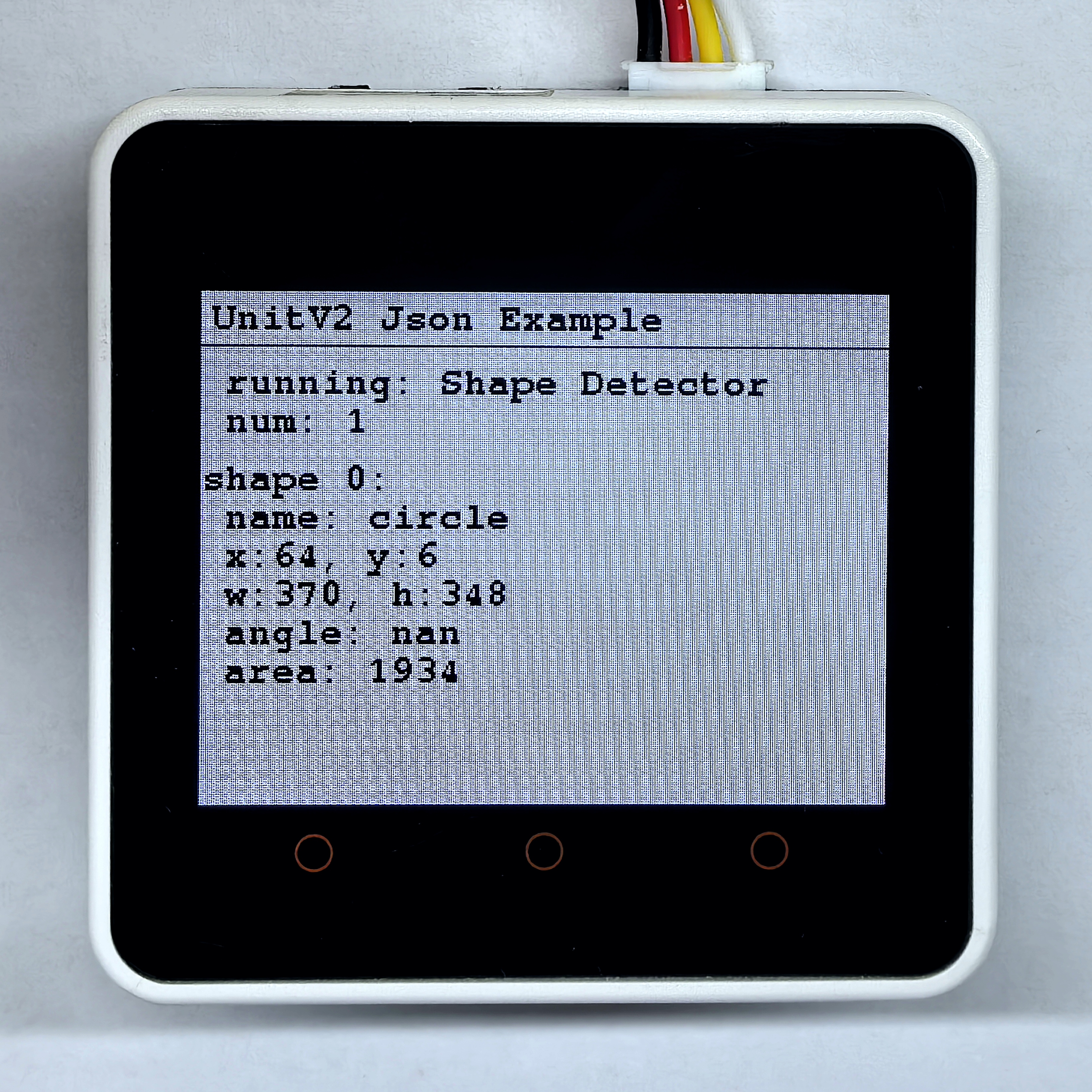

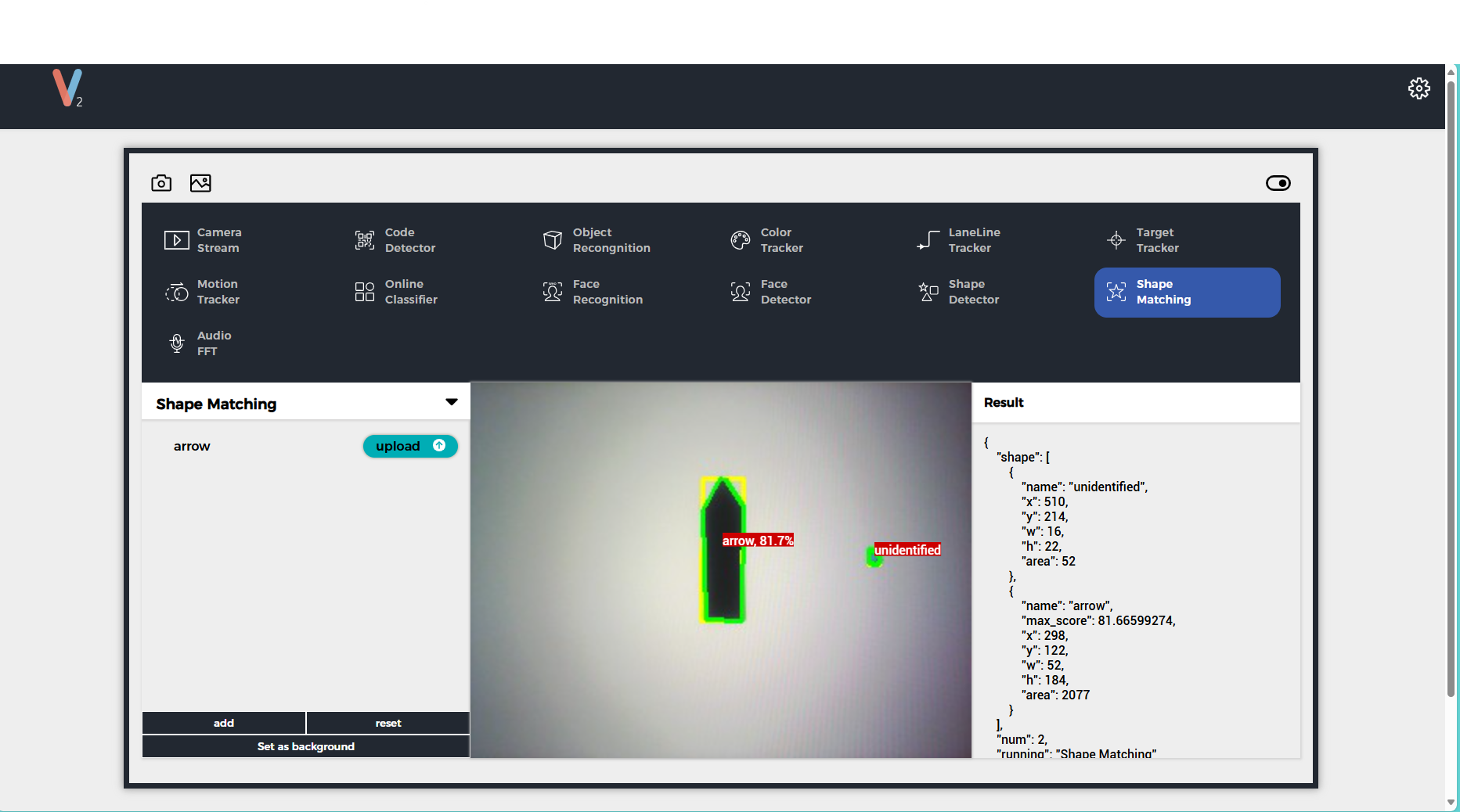

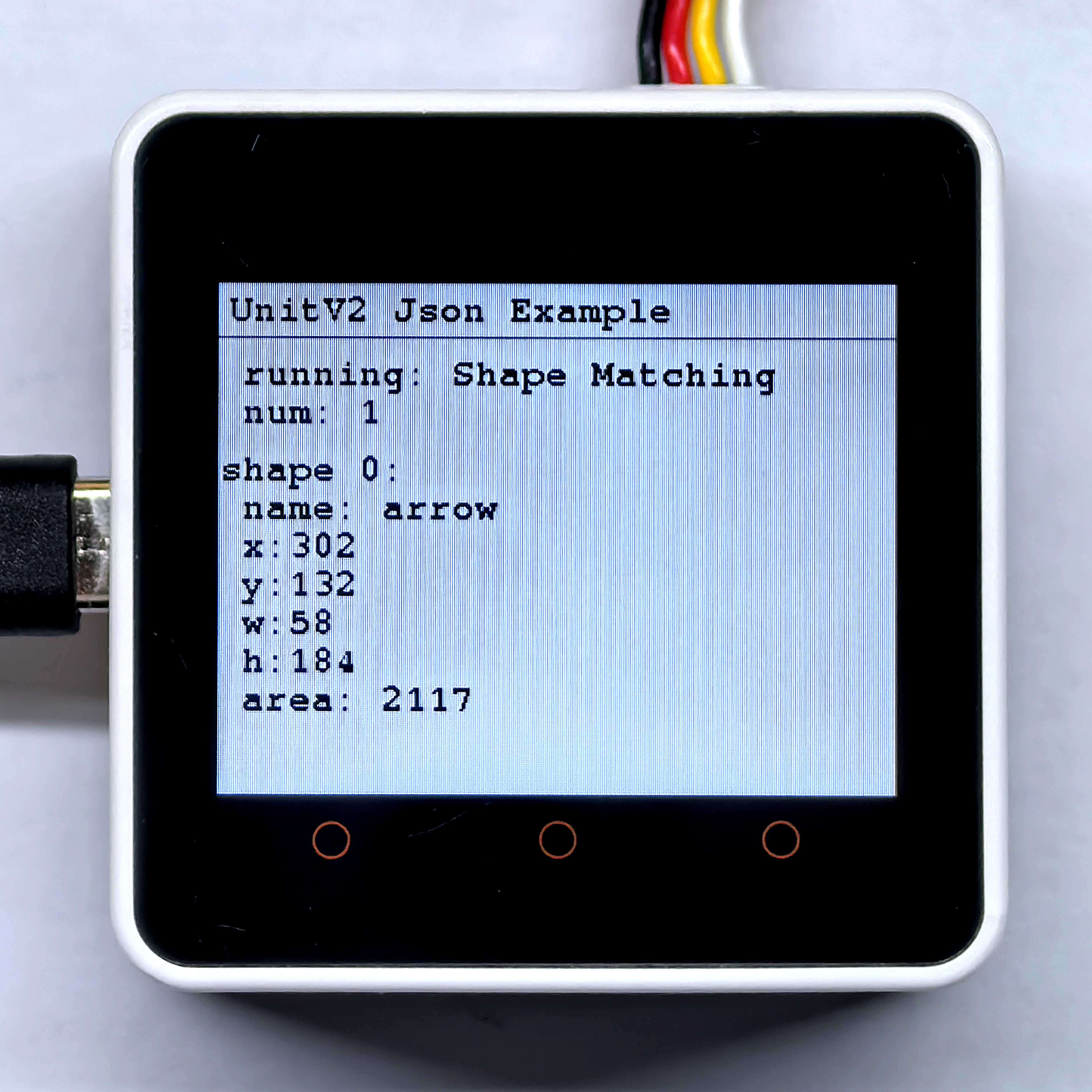

Scan the left image; detection result on the right:
5.12 Shape Matching
Configures UnitV2 to the custom shape matching function. Before use, set the background once. Factory firmware contains no shape data. To add shape data: click add, then upload a white background black shape PNG file. The shape name is taken from the file name. In this example: arrow.png → shape name arrow. After uploading successfully, you can use the shape matching function. Access via unitv2.py or IP: 10.254.239.1.
