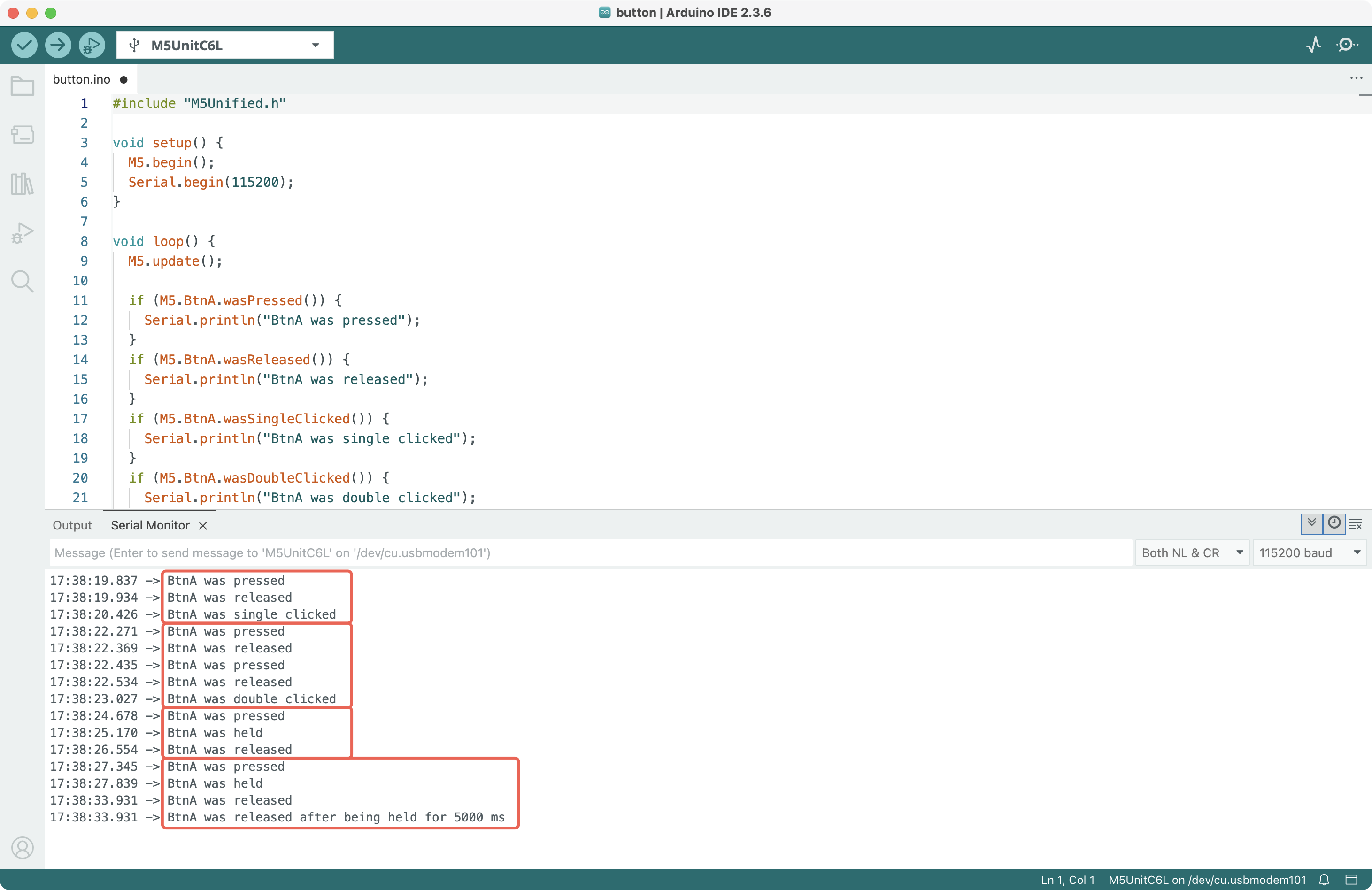

#include "M5Unified.h"
void setup() {
  M5.begin();
  Serial.begin(115200);
void loop() {
  M5.update();
  if (M5.BtnA.wasPressed()) {
    Serial.println("BtnA was pressed");
  if (M5.BtnA.wasReleased()) {
    Serial.println("BtnA was released");
  if (M5.BtnA.wasSingleClicked()) {
    Serial.println("BtnA was single clicked");
  if (M5.BtnA.wasDoubleClicked()) {
    Serial.println("BtnA was double clicked");
  if (M5.BtnA.wasHold()) {
    Serial.println("BtnA was held");
  if (M5.BtnA.wasReleaseFor(5000)) {  // ms
    Serial.println("BtnA was released after being held for 5000 ms");
This program will detect the status of the front button on the device (pressed, released, single short press, double short press, long press, released after a long press of 5000 ms), and print messages in the Serial Monitor:
