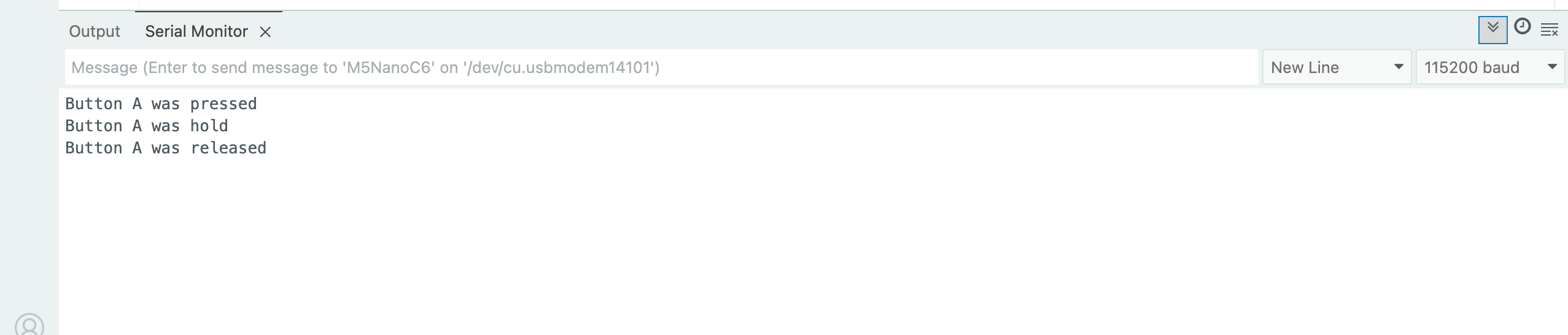

This program detects the status of the front button on the NanoC6 and prints button events in the serial monitor:
