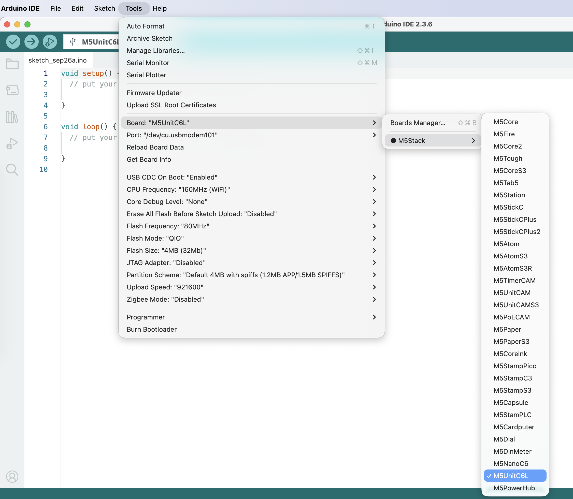

2.Port Selection
Connect the device to the computer using a USB-C cable. Press and hold the side reset button for 3 seconds until the green light turns red. The device will then enter download mode, and you can select the corresponding main controller and device port in Arduino IDE.

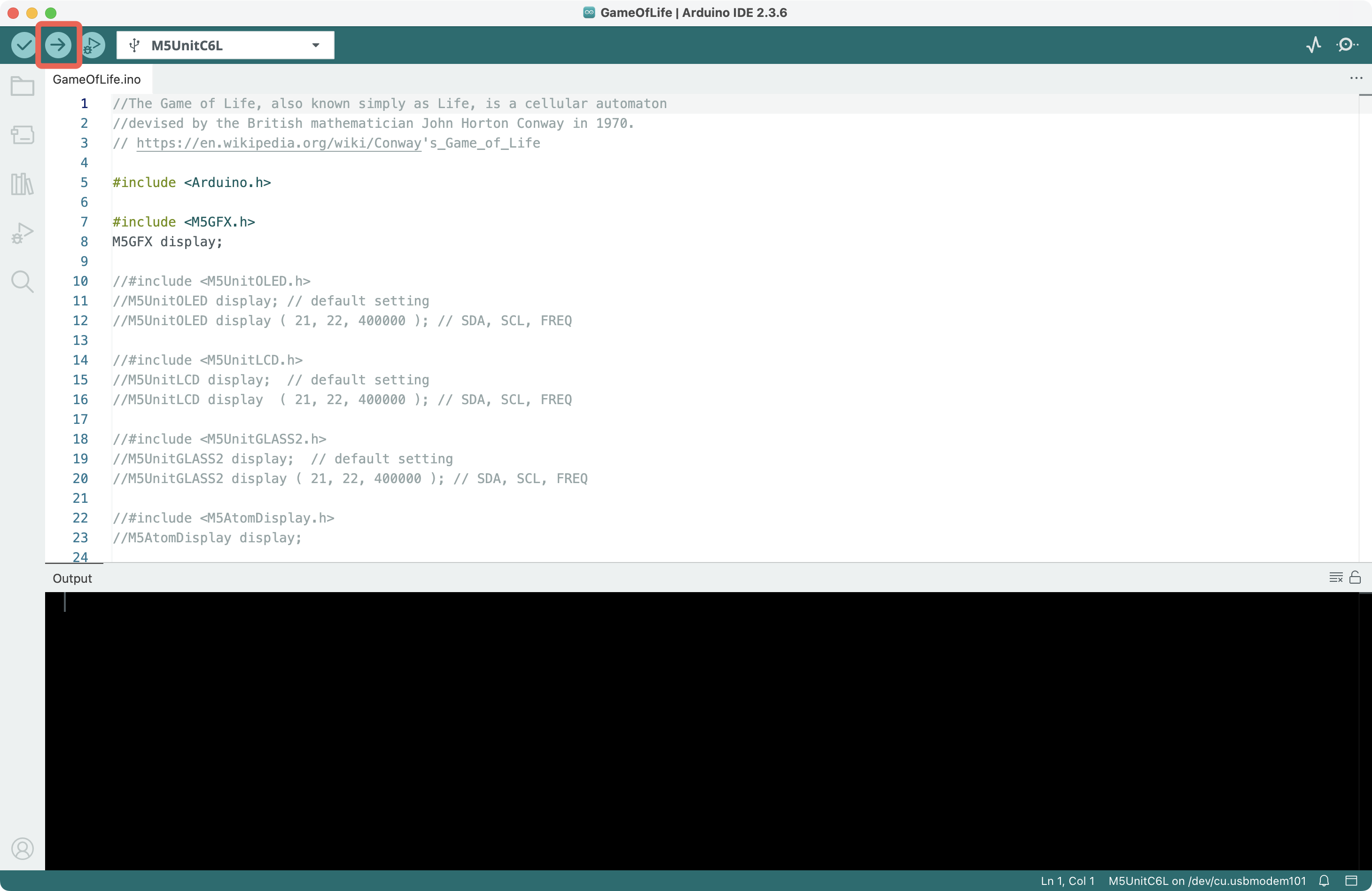

Open the example program Basic -> GameOfLife from the M5GFX library, then click the upload button. The program will be compiled and uploaded to Unit C6L.

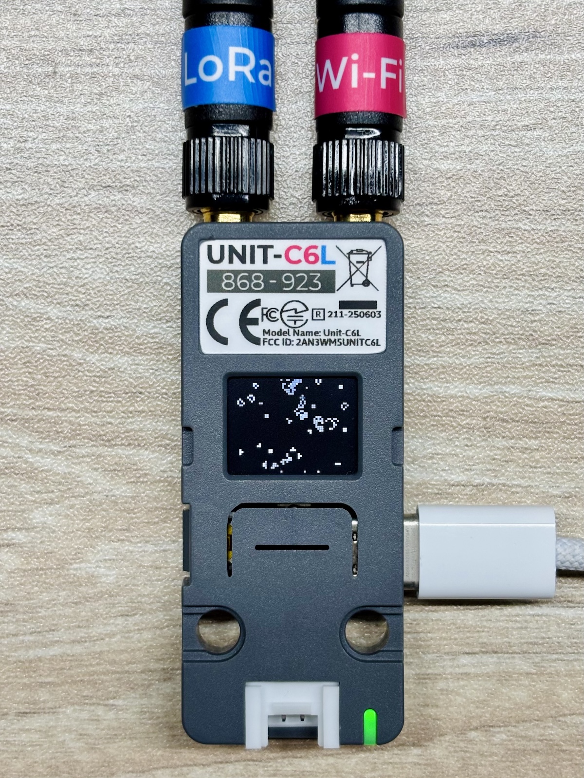

Execution Result:
