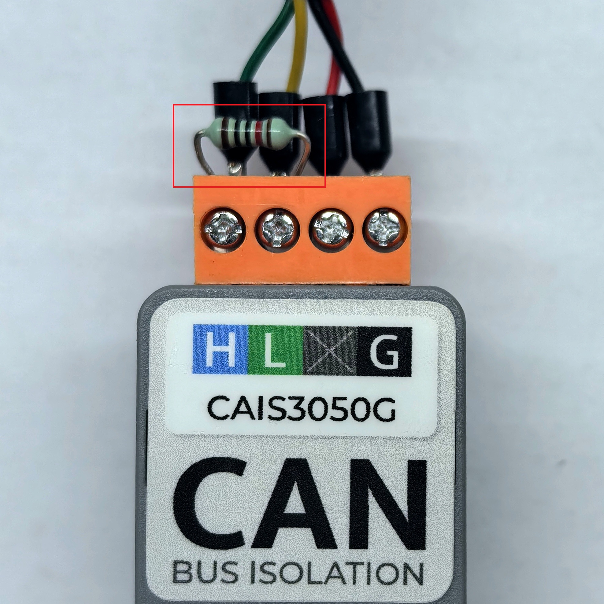

  • This module does not have a built-in 120Ω termination resistor; you can connect 120Ω resistors in parallel at both ends of the CAN bus as shown in the figure below.

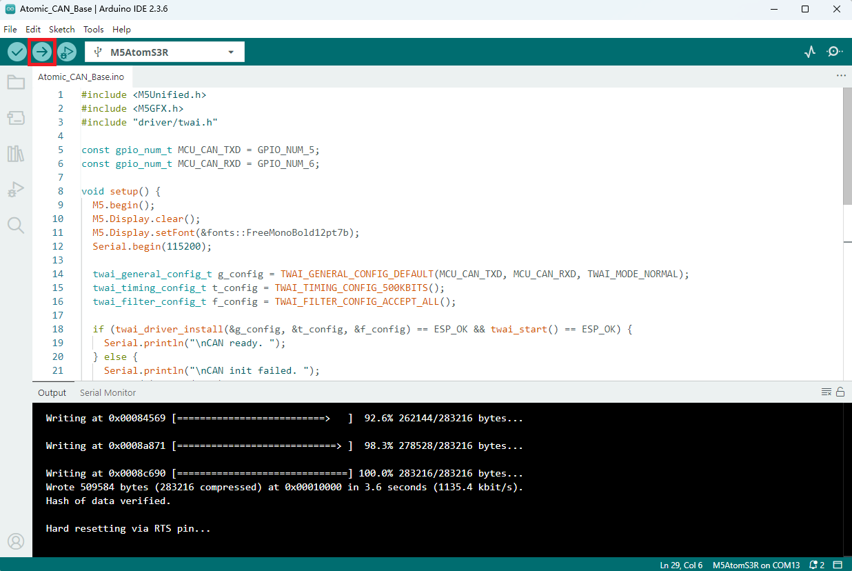

4. Compile and Upload
  • 1. Download mode: Devices must enter download mode before flashing the program; steps vary depending on the main controller. For details, refer to the device program download tutorial list at the bottom of the Arduino IDE Quick Start page.
  • For AtomS3R, press and hold the reset button (about 2 seconds) until the internal green LED lights up, then release. The device is now in download mode, waiting for flashing.
  • 2. Select the device port, click the compile/upload button in the upper left of Arduino IDE, and wait for compilation and upload to the device.

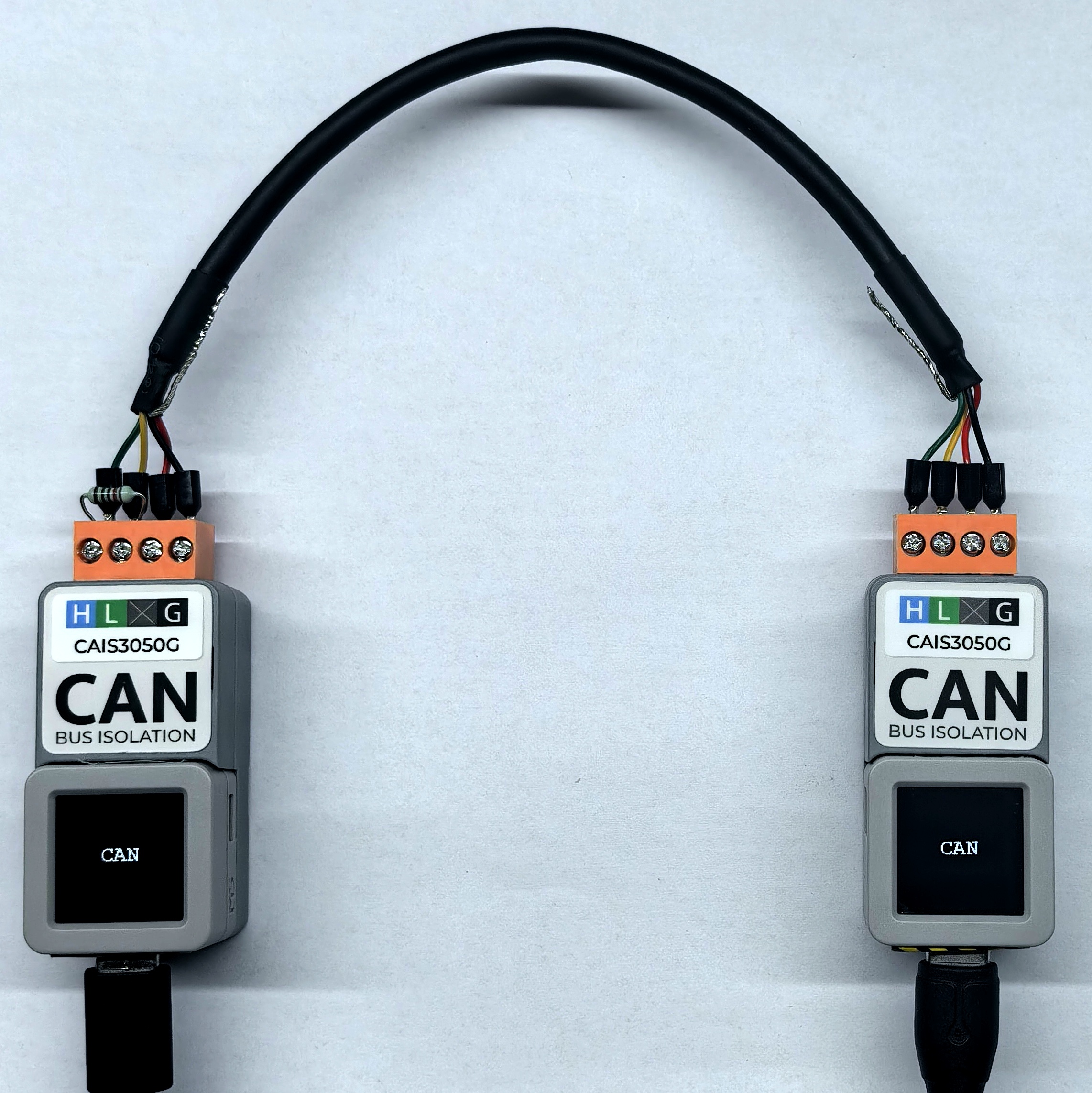

  • After powering on, the serial monitor will display the CAN bus transmit and receive information. The wiring is shown below.
  • Serial output:
    Transmitter: TX OK
    Receiver: RX: AA BB (ext=0, id=0x123, dlc=2)
