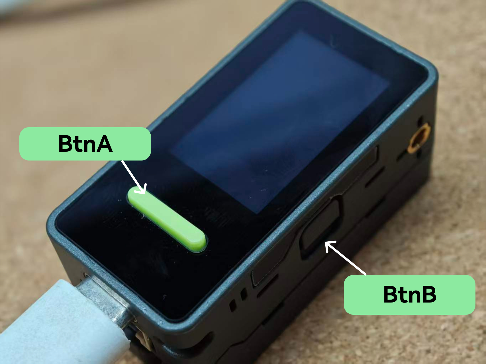

Arduino Nesso N1 Button
Arduino Nesso N1 button input-related API and example program.

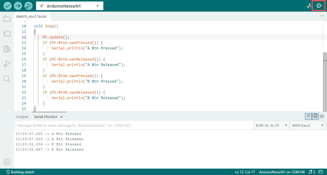

When in use, make sure to include the M5.update() function in the main loop to read status updates and minimize blocking as much as possible, otherwise button state changes may not be captured in time.
Example Program
Compilation Requirements
  • M5Stack board manager version >= 3.2.5
  • Board option = ArduinoNessoN1
  • M5GFX library version >= 0.2.17

#include "M5Unified.h"
void setup()
    auto cfg = M5.config();
    cfg.serial_baudrate = 115200;
    M5.begin(cfg);
void loop()
    M5.update();
    if (M5.BtnA.wasPressed()) {
        Serial.println("A Btn Pressed");
    if (M5.BtnA.wasReleased()) {
        Serial.println("A Btn Released");
    if (M5.BtnB.wasPressed()) {
        Serial.println("B Btn Pressed");
    if (M5.BtnB.wasReleased()) {
        Serial.println("B Btn Released");
