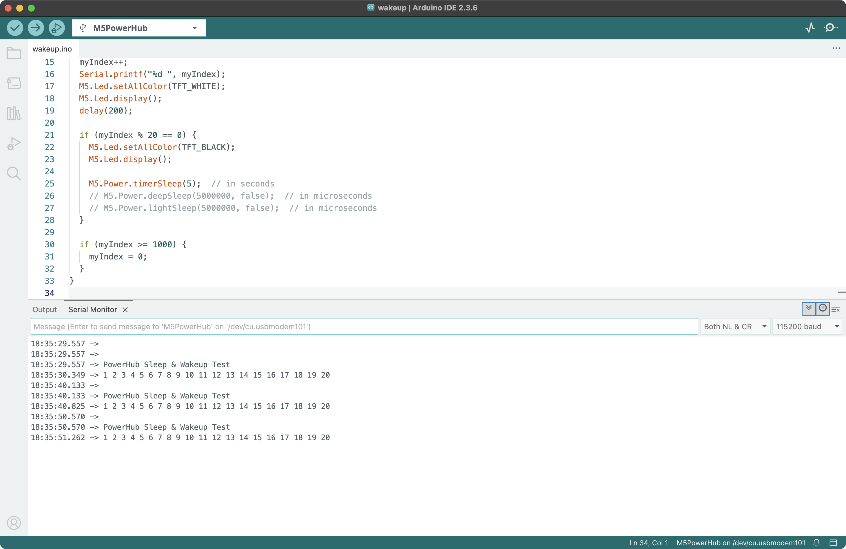

1 2 3 4 5 6 7 8 9 10 11 12 13 14 15 16 17 18 19 20 21 22 23 24 25 26 27 28 29 30 31 32 33
#include <M5Unified.h>
int myIndex = 0;
void setup() {
  M5.begin();
  M5.Led.setBrightness(255);
  Serial.begin(115200);
  Serial.println("\n\nPowerHub Sleep & Wakeup Test");
  delay(1000);
void loop() {
  myIndex++;
  Serial.printf("%d ", myIndex);
  M5.Led.setAllColor(TFT_WHITE);
  M5.Led.display();
  delay(200);
  if (myIndex % 20 == 0) {
    M5.Led.setAllColor(TFT_BLACK);
    M5.Led.display();
    M5.Power.timerSleep(5);  // in seconds
    // M5.Power.deepSleep(5000000, false);  // in microseconds
    // M5.Power.lightSleep(5000000, false);  // in microseconds
  if (myIndex >= 1000) {
    myIndex = 0;
This program will turn on the LED and print a counter that starts from 0 and increments by 1 in the serial monitor. Each time the counter reaches a multiple of 20, the device will enter timed sleep mode for 5 seconds (LED turns off), then wake up, restart the program, and light up the LED again.
