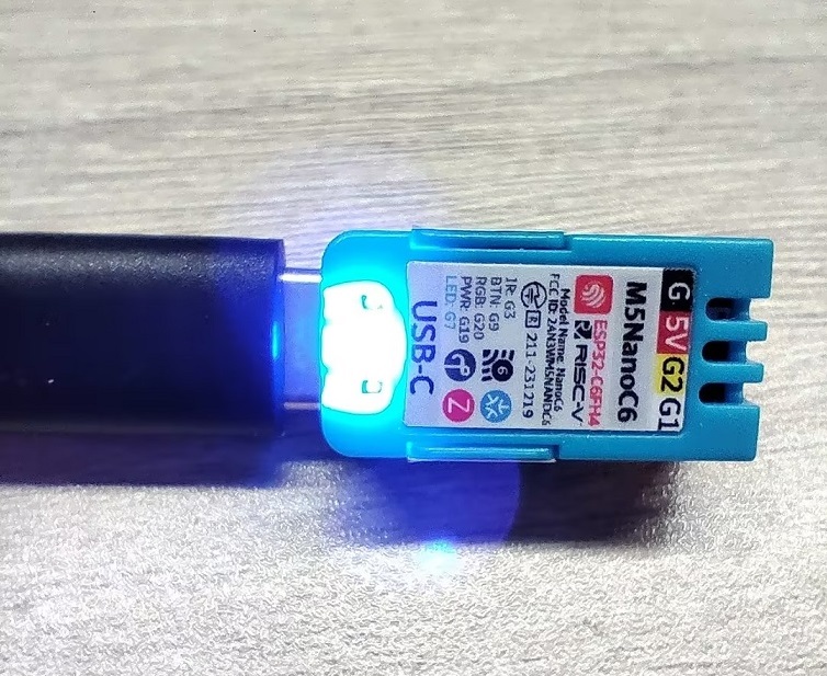

This program controls the blue LED on the device to blink at 1-second intervals, which can be used for status indication or debugging:
