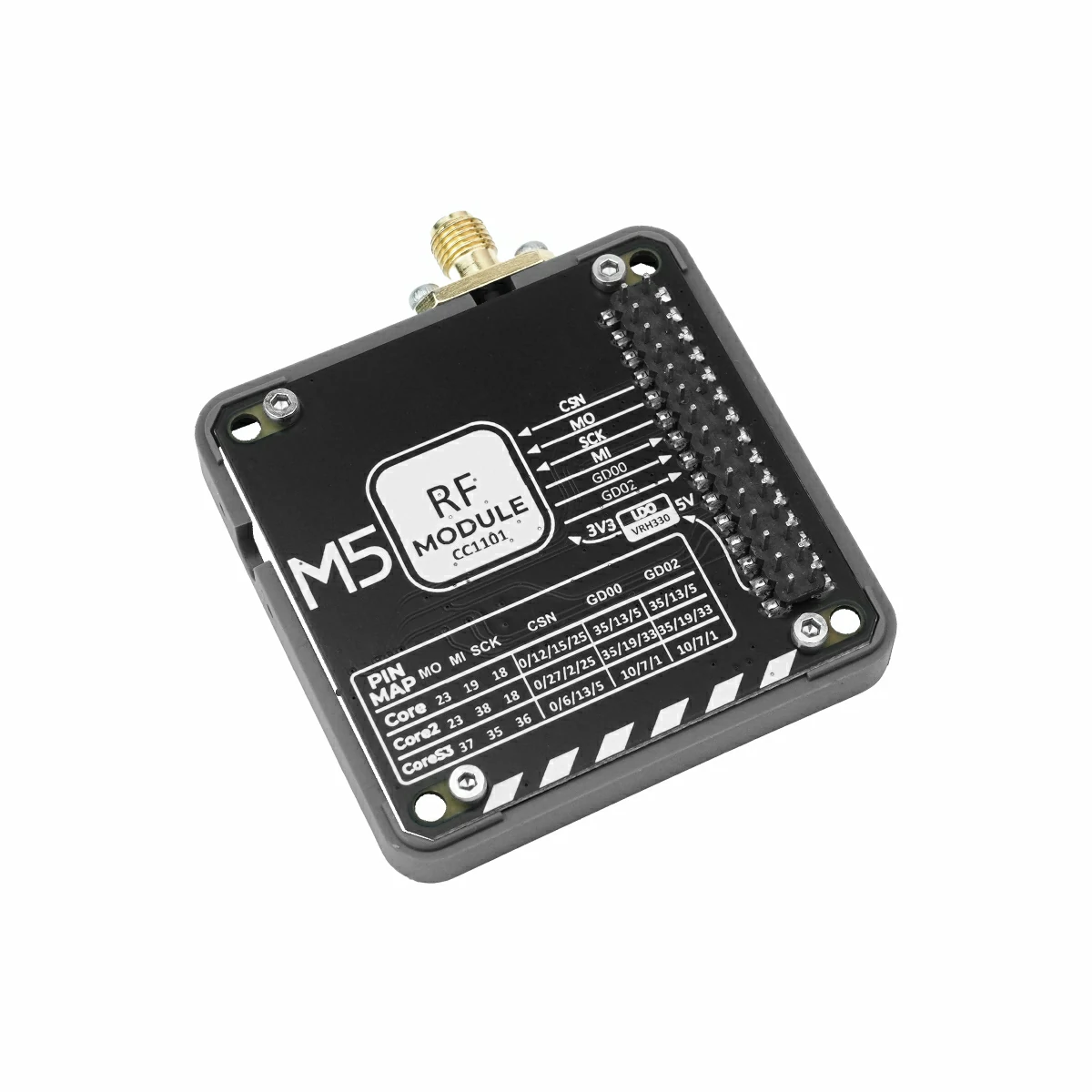

Pin Compatibility
Due to the different pin configurations of each host device, please refer to the Pin Compatibility Table in the product documentation before use, and modify the example program according to the actual pin connection situation.

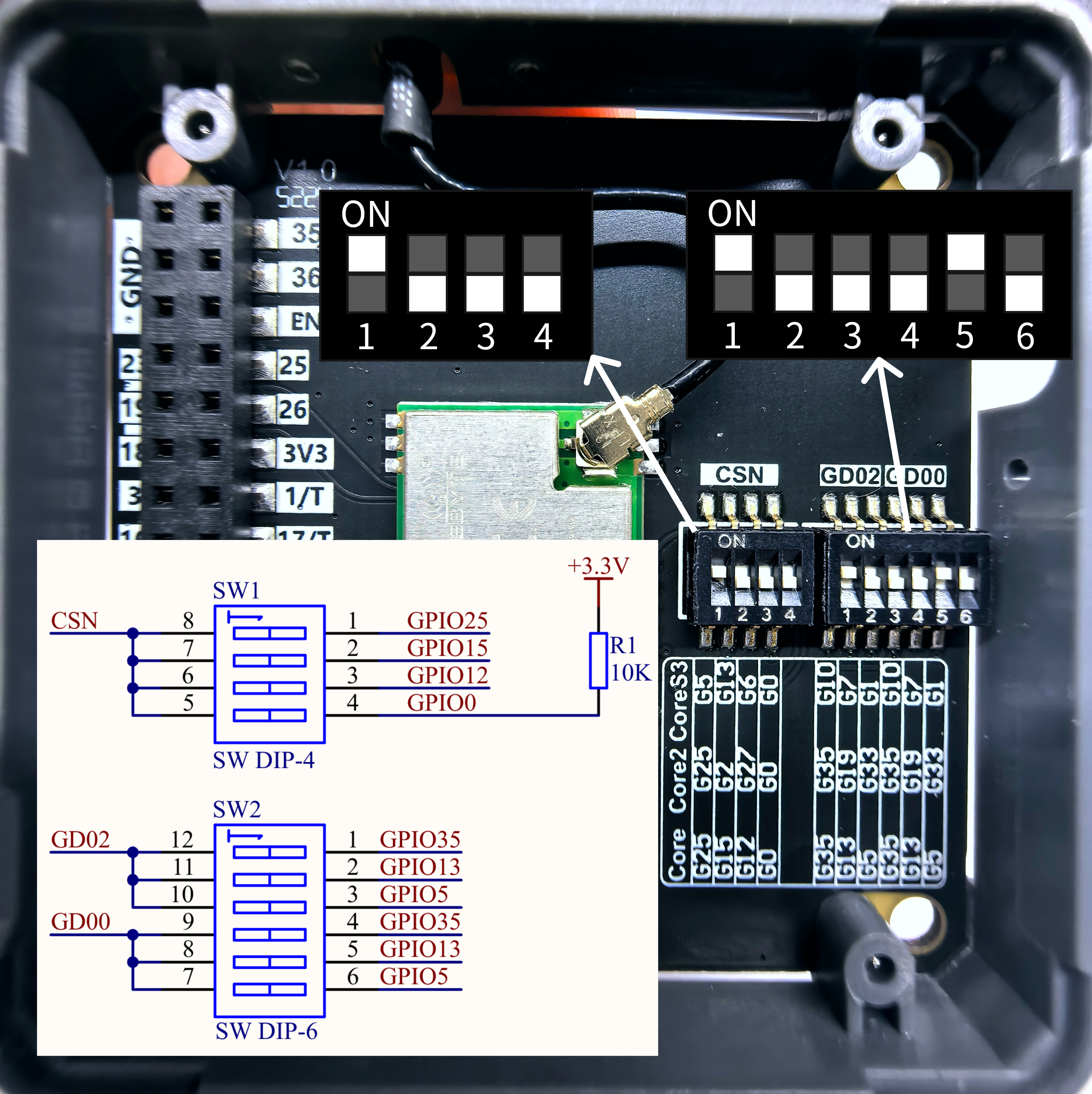

3.1 Pin DIP Switch
Module CC1101 communicates via SPI. Please modify the pin definitions in the program according to the actual circuit connections. After the device is connected, the corresponding SPI IO pins are G5 (CSN), G37 (MOSI), G35 (MISO), and G36 (SCK); the interrupt IO pins are G7 (GD00) and G10 (GD02). The physical setup is shown in the figure below:

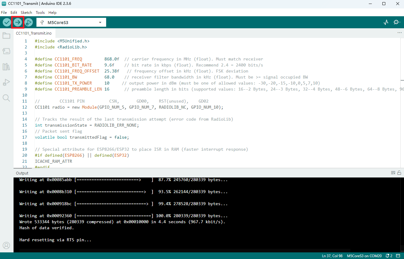

4. Compile and Upload
  • Download Mode: Before flashing the program on different devices, you need to enter download mode. This step may vary depending on the main control device. For details, refer to the list of device program download tutorials at the bottom of the Arduino IDE Quick Start Tutorial page to see the specific operation method.
  • For CoreS3, press and hold the reset button (for about 2 seconds) until the internal green LED lights up, then release. At this point, the device has entered download mode and is ready for flashing. The red light turns off after the button is released, confirming that the device is in download mode.
  • Select the device port, click the Compile and Upload button in the upper left of Arduino IDE, and wait for the program to complete compilation and upload to the device.

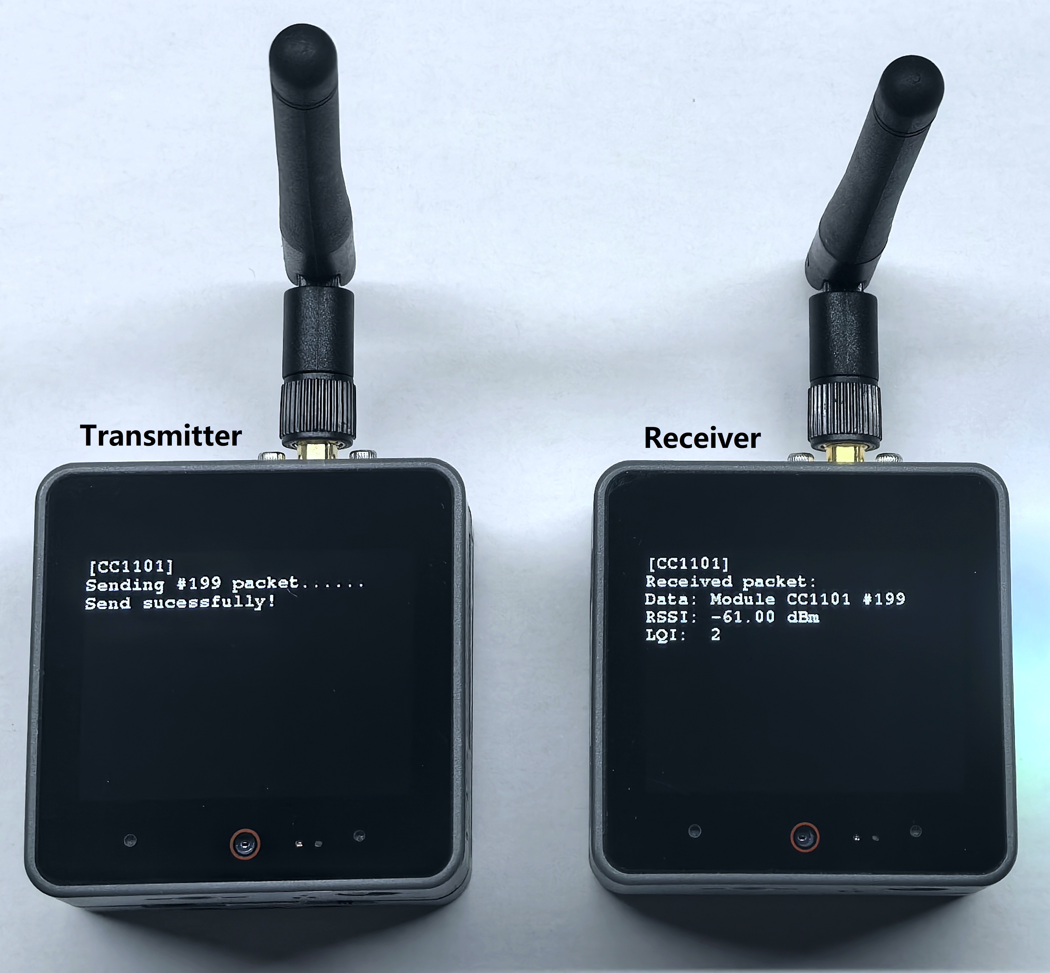

5. Information Transmission and Reception Demonstration
The above example shows that the transmitter sends a string containing a counter once per second, while the receiver prints the received string and displays RSSI and other information.
  • Transmitter serial output:
    [CC1101] Sending #199 packet ... Transmission finished!
  • Receiver serial output:
    [CC1101] Received packet:
    [CC1101] Data:            Module CC1101 #199
    [CC1101] RSSI:            -61.00 dBm
    [CC1101] LQI:             2
