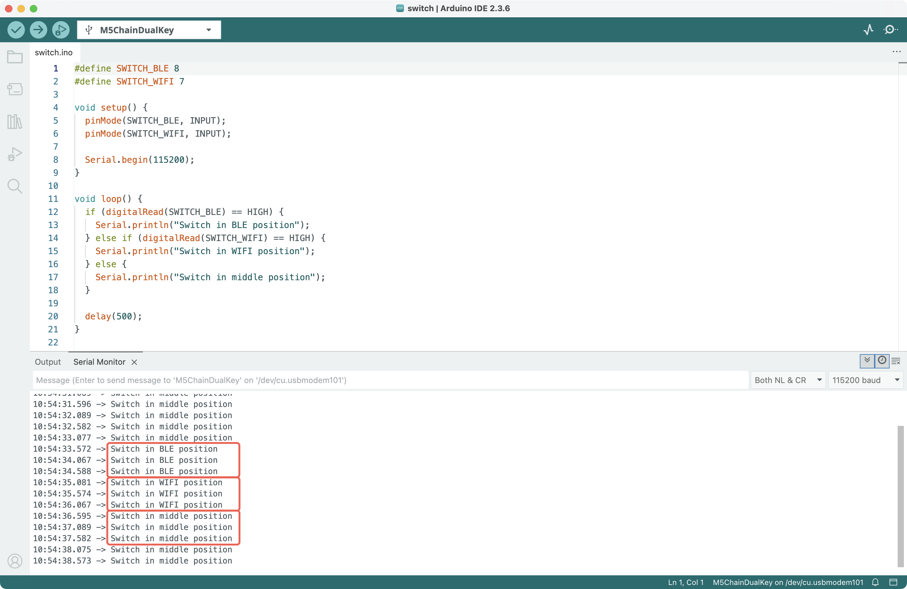

Example Program
Build Requirements
  • M5Stack Board Manager version ≥ 3.2.4
  • Board option = M5ChainDualKey
1 2 3 4 5 6 7 8 9 10 11 12 13 14 15 16 17 18 19 20 21
#define SWITCH_BLE  8
#define SWITCH_WIFI 7
void setup() {
  pinMode(SWITCH_BLE,  INPUT);
  pinMode(SWITCH_WIFI, INPUT);
  Serial.begin(115200);
void loop() {
  if (digitalRead(SWITCH_BLE) == HIGH) {
    Serial.println("Switch in BLE position");
  } else if (digitalRead(SWITCH_WIFI) == HIGH) {
    Serial.println("Switch in WIFI position");
  } else {
    Serial.println("Switch in middle position");
  delay(500);
This program checks the switch position every 500 milliseconds and prints the current state message to the Serial Monitor:
