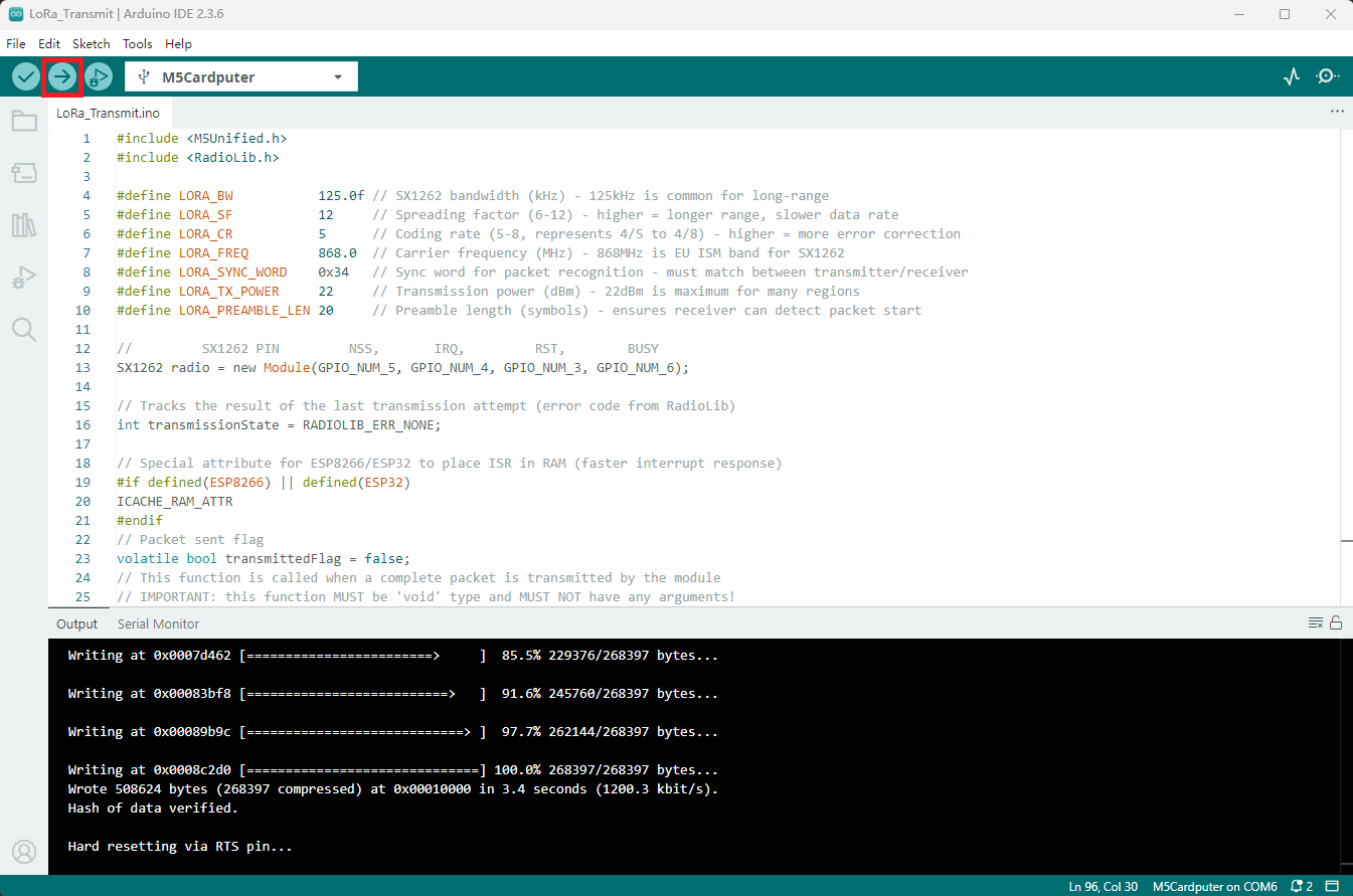

2. Compile & Upload

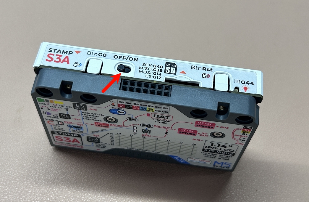

  • Set the power switch on the side of the Cardputer-Adv to the OFF position, then press and hold the G0 button before powering on the device, and release it after powering on from the back of the device. The device will then enter download mode, waiting for flashing.
  • Select the device port, click the compile/upload button in the upper left corner of the Arduino IDE, and wait for the program to be compiled and uploaded to the device.

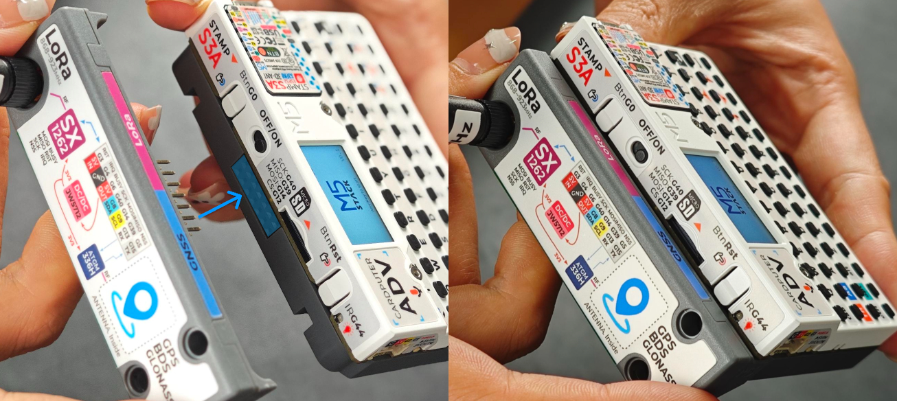

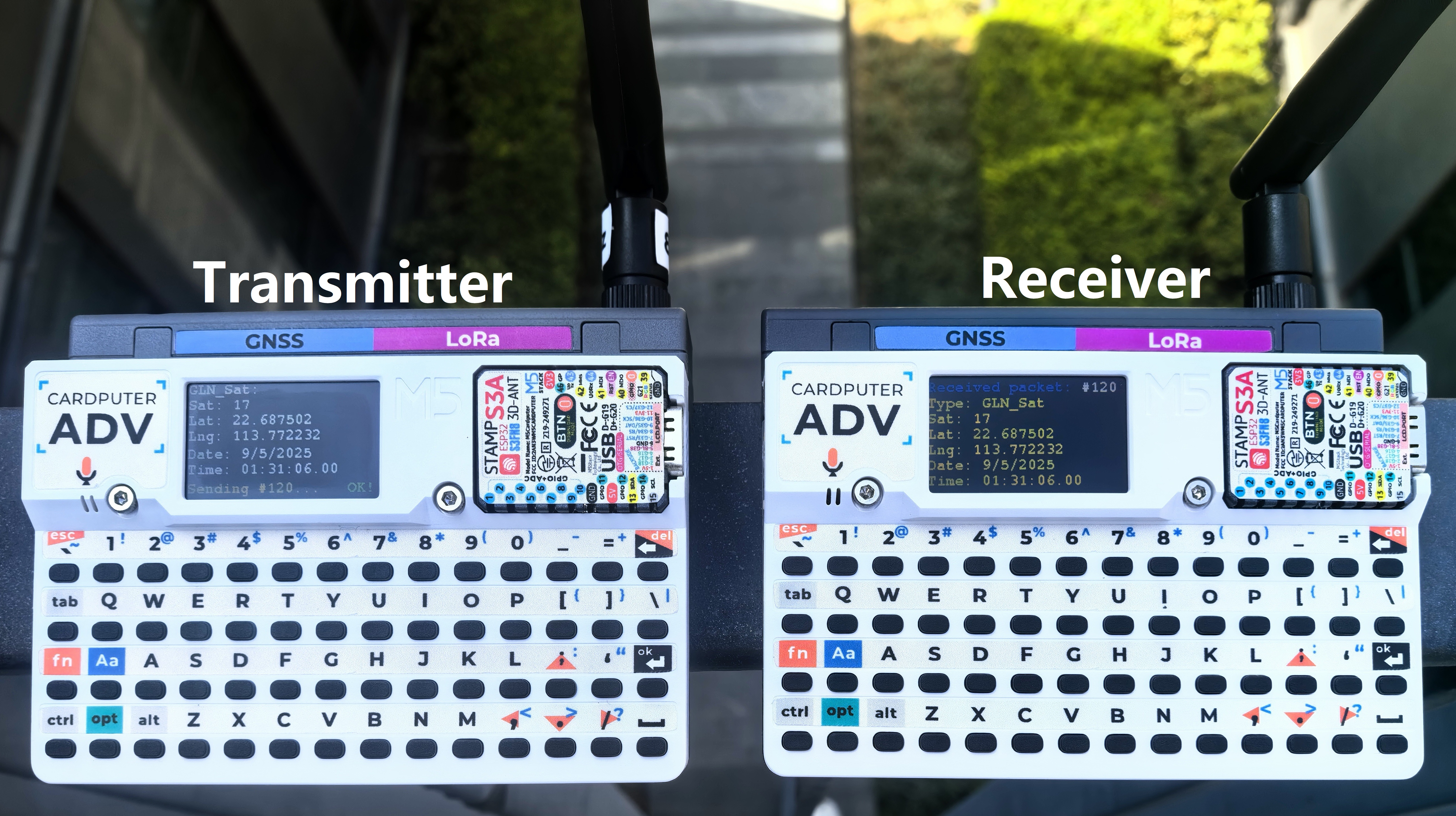

  • The main controller used in this tutorial is Cardputer-Adv, paired with Cap LoRa868. The LoRa module of Cap LoRa868 communicates via SPI, while the GPS module communicates via UART. Please modify the pin definitions in the program according to the actual circuit connections. After the device is connected, the corresponding LoRa SPI IO pins are G5 (NSS), G14 (MOSI), G39 (MISO), and G40 (SCK); other IO pins are G4 (IRQ), G3 (RST), and G6 (BUSY); the UART IO pins are G15 (RX) and G13 (TX).
The physical connection assembly is shown in the figure below:

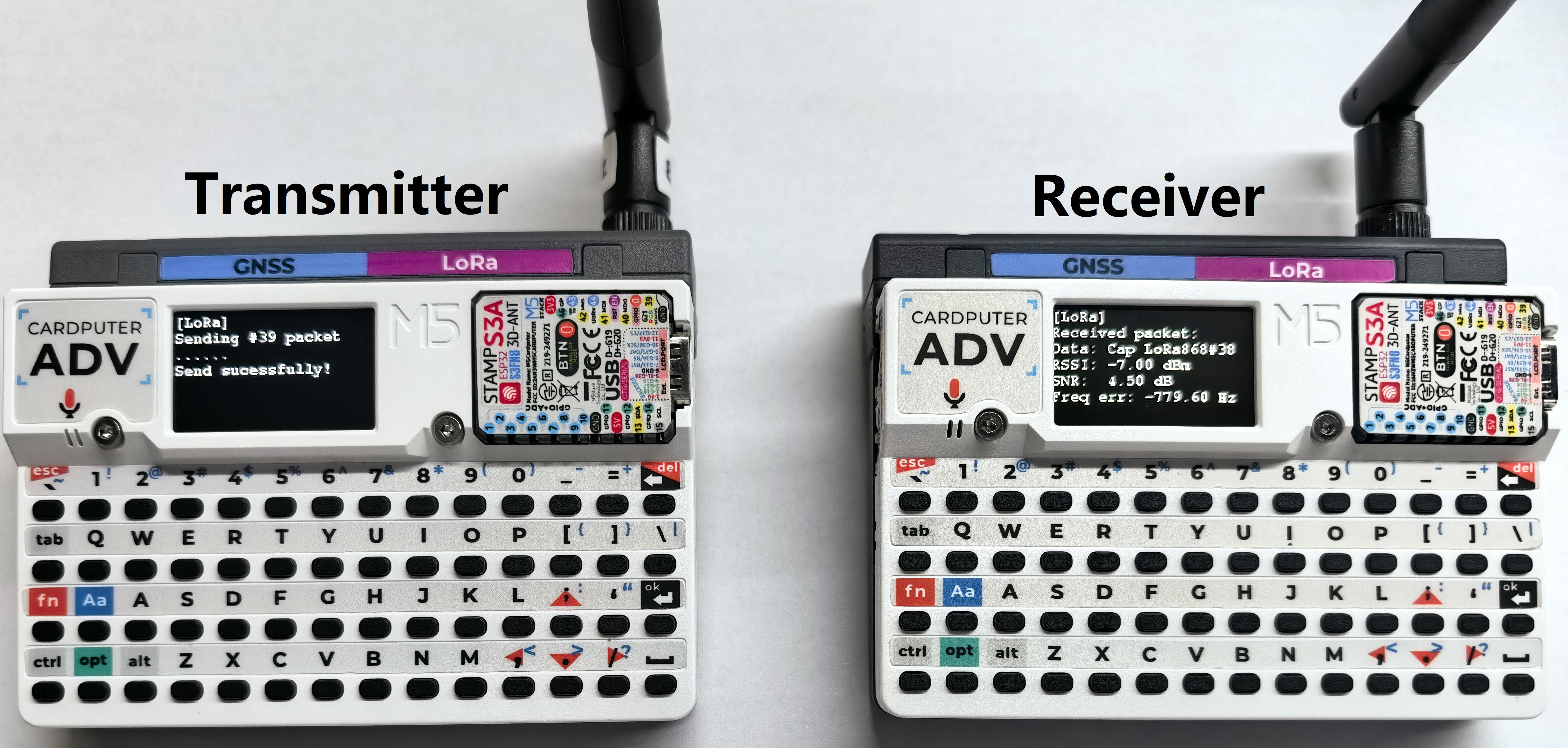

The above example’s effect: the sending end will send a string containing a counter every second; the receiving end will print the received string and display RSSI, SNR, and frequency error information.
  • Transmitter serial output:
[LoRa868] Sending #39 packet ... Transmission finished!
  • Receiver serial output:
[LoRa868] Received packet:
[LoRa868] Data:            Cap LoRa868#38
[LoRa868] RSSI:            -7.00 dBm
[LoRa868] SNR:             4.50 dB
[LoRa868] Frequency error: -779.60 Hz

3.3 Using LoRa Communication to Transmit GPS Information
When LoRa and GPS are used simultaneously, the LoRa signal may interfere with GPS positioning, causing unstable GPS positioning signal reception. It is recommended to limit the LoRa transmission power in actual use to achieve a balance between GPS positioning and LoRa communication.
Transmitter
1 2 3 4 5 6 7 8 9 10 11 12 13 14 15 16 17 18 19 20 21 22 23 24 25 26 27 28 29 30 31 32 33 34 35 36 37 38 39 40 41 42 43 44 45 46 47 48 49 50 51 52 53 54 55 56 57 58 59 60 61 62 63 64 65 66 67 68 69 70 71 72 73 74 75 76 77 78 79 80 81 82 83 84 85 86 87 88 89 90 91 92 93 94 95 96 97 98 99 100 101 102 103 104 105 106 107 108 109 110 111 112 113 114 115 116 117 118 119 120 121 122 123 124 125 126 127 128 129 130 131 132 133 134 135 136 137 138 139 140 141 142 143 144 145 146 147 148 149 150 151 152 153 154 155 156 157 158 159 160 161 162 163 164 165 166 167 168 169 170 171 172 173 174 175 176 177 178 179 180 181 182 183 184 185 186 187 188 189 190 191 192 193 194 195 196 197 198 199 200 201 202 203 204 205 206 207 208 209 210 211 212
#include <RadioLib.h>
#include "utility/PI4IOE5V6408_Class.hpp"
#include "MultipleSatellite.h"
// LoRa configuration parameters
#define LORA_BW           125.0f // Bandwidth (kHz)
#define LORA_SF           12     // Spreading factor (6-12)
#define LORA_CR           5      // Coding rate (5-8)
#define LORA_FREQ         868.0  // Frequency (MHz)
#define LORA_SYNC_WORD    0x34   // Sync word
#define LORA_TX_POWER     16     // Transmission power (dBm)
#define LORA_PREAMBLE_LEN 20     // Preamble length
// LoRa pin definition
SX1262 radio = new Module(GPIO_NUM_5, GPIO_NUM_4, GPIO_NUM_3, GPIO_NUM_6);
// GPS configuration parameters
static const int RXPin = 15, TXPin = 13;
static const uint32_t GPSBaud = 115200;
MultipleSatellite gps(Serial1, GPSBaud, SERIAL_8N1, RXPin, TXPin);
// Global variables
int transmissionState = RADIOLIB_ERR_NONE;
volatile bool transmittedFlag = false;
int count = 0;
satellite_mode_t currentMode = SATELLITE_MODE_GLONASS;
float lastLat = 0.0f, lastLng = 0.0f;
int lastSatellites = 0;
String lastDate = "", lastTime = "";
// LoRa transmission completion callback function
#if defined(ESP8266) || defined(ESP32)
ICACHE_RAM_ATTR
#endif
void setFlag(void) {
    transmittedFlag = true;
// Function to get satellite system prefix
const char* getSatPrefix(satellite_mode_t mode) {
    switch (mode) {
        case SATELLITE_MODE_GPS:      return "GPS_Sat";
        case SATELLITE_MODE_BDS:      return "BDS_Sat";
        case SATELLITE_MODE_GLONASS:  return "GLN_Sat";
        case SATELLITE_MODE_GALILEO:  return "GAL_Sat";
        case SATELLITE_MODE_QZSS:     return "QZS_Sat";
        default:                      return "Unknown";
// Function to update display information
String displayInfo(void) {
    M5.Display.setTextColor(TFT_WHITE);
    Serial.println("\n=========================================");
    Serial.print(F("Location: "));
    // Update satellite count
    lastSatellites = gps.satellites.value();
    Serial.printf("satellites:%d\n", lastSatellites);
    String gps_mode = gps.getSatelliteMode();
    Serial.printf("GNSS Mode:%s\r\n", gps_mode.c_str());
    const char* satPrefix = getSatPrefix(currentMode);
    // Update location information
    if (gps.location.isUpdated()) {
        lastLat = gps.location.lat();
        lastLng = gps.location.lng();
        Serial.print(lastLat, 6); Serial.print(F(","));
        Serial.print(lastLng, 6);Serial.print(F("\n"));
        // Display GPS information
        M5.Display.fillRect(0, 0, 240, 135, TFT_BLACK);
        M5.Display.setCursor(0, 0);
        M5.Display.printf("%s: \nSat: %d\nLat: %.6f\nLng: %.6f\n",
                          satPrefix, lastSatellites, lastLat, lastLng);
        M5.Display.printf("%s\nSat: ----\nLat: ----\nLng: ----\n", satPrefix);
        Serial.print(F("LOCATION INVALID\n"));
    // Update date information
    Serial.print(F("Date/Time: "));
    if (gps.date.isUpdated()) {
        lastDate = String(gps.date.month()) + "/" +
                  String(gps.date.day()) + "/" +
                  String(gps.date.year());
        Serial.print(lastDate);
        Serial.print(F(" "));
        M5.Display.setCursor(0, 75);
        M5.Display.printf("Date: %s\n", lastDate.c_str());
        lastDate = "DATE INVALID";
        Serial.print(F("DATE INVALID "));
    // Update time information
    if (gps.time.isUpdated()) {
        lastTime = (gps.time.hour() < 10 ? "0" : "") + String(gps.time.hour()) + ":" +
           (gps.time.minute() < 10 ? "0" : "") + String(gps.time.minute()) + ":" +
           (gps.time.second() < 10 ? "0" : "") + String(gps.time.second()) + "." +
           (gps.time.centisecond() < 10 ? "0" : "") + String(gps.time.centisecond());
        Serial.print(lastTime);
        M5.Display.printf("Time: %s\n", lastTime.c_str());
        lastTime = "TIME INVALID";
        Serial.print(F("TIME INVALID"));
    Serial.println();
    return String("Type:") + satPrefix +
           " Count:" + String(count) +
           " Sat:" + String(lastSatellites) +
           " Lat:" + String(lastLat, 6) +
           " Lng:" + String(lastLng, 6) +
           " Date:" + lastDate +
           " Time:" + lastTime;
String LoRaName;
m5::PI4IOE5V6408_Class ioe(0x43, 400000, &m5::In_I2C);
    // Initialize M5 device
    // Cap LoRa-1262 Detection
    if (!m5::In_I2C.begin()) {
        Serial.println("I2C init failed");
        while (true) delay(1000);
    if (ioe.begin()) {
        Serial.printf("Using Cap LoRa-1262\n");
        LoRaName = "LoRa-1262";
        ioe.setDirection(0, true);      // Output
        ioe.setHighImpedance(0, false); // Disable high-impedance so pin can actually drive
        ioe.digitalWrite(0, true);      // High Level
        Serial.printf("Using Cap LoRa868\n");
        LoRaName = "LoRa868";
    // Initialize LoRa module
    Serial.printf("[%s] Initializing ...", LoRaName);
    int state = radio.begin(LORA_FREQ, LORA_BW, LORA_SF, LORA_CR,
                           LORA_SYNC_WORD, LORA_TX_POWER, LORA_PREAMBLE_LEN, 3.0, true);
    if (state == RADIOLIB_ERR_NONE) {
        Serial.println(F("Init success!"));
        Serial.print(F("Init failed, code: "));
        Serial.println(state);
        while (true) { delay(10); }
    radio.setCurrentLimit(140);
    radio.setPacketSentAction(setFlag);
    // Send first data packet
    Serial.printf("[%s] Sending first packet...", LoRaName);
    transmissionState = radio.startTransmit("GPS Initializing...");
    M5.Display.setCursor(5,0);
    M5.Display.printf("GPS Initializing...\n");
    // Initialize GPS module
    gps.begin();
    gps.setSystemBootMode(BOOT_FACTORY_START);
    gps.setSatelliteMode(currentMode);
    Serial.println(F("<----------Cap LoRa868/1262 Example---------->"));
    Serial.print(F("Testing TinyGPSPlus library v. "));
    Serial.println(TinyGPSPlus::libraryVersion());
    String version = gps.getGNSSVersion();
    Serial.printf("GNSS SW=%s\r\n", version.c_str());
    // Handle LoRa transmission completion event
    if (transmittedFlag) {
        if (transmissionState == RADIOLIB_ERR_NONE) {
            // Update GPS data and display
            Serial.println(F("      Transmission finished!"));
            M5.Display.setTextColor(TFT_GREEN);
            M5.Display.println("  OK!");
            Serial.print(F("Send failed, code: "));
            Serial.println(transmissionState);
            M5.Display.print("\nSend failed\ncode:");
            M5.Display.println(transmissionState);
        radio.finishTransmit();
        // delay(500);
        gps.updateGPS();
        String gpsData = displayInfo();
        // Send GPS data
        Serial.printf("[%s] Sending GPS data:\n %s\n", LoRaName, gpsData.c_str());
        transmissionState = radio.startTransmit(gpsData);
        // Update display
        M5.Display.fillRect(0, 115, 240, 20, TFT_BLACK);
        M5.Display.setCursor(0,115);
        M5.Display.setTextColor(TFT_YELLOW);
        M5.Display.printf("Sending #%d... ", count++);
Receiver

Since the GPS of this product uses a built-in antenna without an external one, please try to use the sending device in open outdoor areas such as playgrounds or rooftops. For first-time use, the wait time is relatively long, about a few minutes, so please be patient while the device searches for satellites and obtains coordinates.
The result of a successful run of the above example is as follows:
Location: satellites:17
GNSS Mode:GLN_Sat
22.687502,113.772232
Date/Time: 9/5/2025 01:31:06.00
[LoRa868] Sending GPS data:
 Type:GLN_Sat Count:120 Sat:17 Lat:22.687502 Lng:113.772232 Date:9/5/2025 Time:01:31:06.00
[LoRa868] Data:            Type:GLN_Sat Count:120 Sat:17 Lat:22.687502 Lng:113.772232 Date:9/5/2025 Time:01:31:06.00
[LoRa868] RSSI:            -2.00 dBm
[LoRa868] SNR:             6.50 dB
[LoRa868] Frequency error: -789.77 Hz
