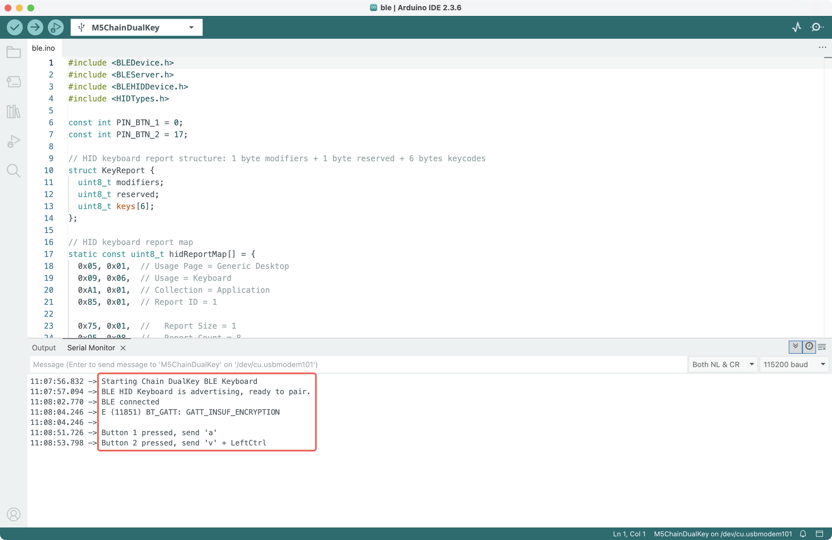

Copy the code above into Arduino IDE, then compile and upload it to Chain DualKey. After the upload is complete, go to the Bluetooth settings on your PC, phone, or other host device, and pair with the keyboard named Chain DualKey Keyboard. Pressing Key1 will input the letter a, and pressing Key2 will trigger the Ctrl + V key combination to paste on Windows (for macOS Command key usage, refer to the comments in the code).
The serial output looks like this:
If there is no serial output after uploading, or if the Bluetooth device cannot be found, you can restart the device. To do so, move the switch to the middle position, unplug the USB-C cable and reconnect it (do not hold Key1).
