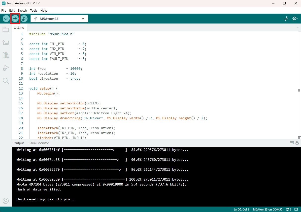

3. Compile and Upload
  • 1. To enter download mode on AtomS3: press and hold the reset button for about 2 seconds until the internal green LED lights, then release — the device will enter download mode and is ready for flashing. The green LED turns off after the button is released, confirming that the device is in download mode.
Note
Different devices require different steps to enter download mode before flashing. See the device-specific download instructions at the bottom of the Arduino IDE Quick Start Tutorial page for details.
  • 2. Select the device port, click the Compile and Upload button in the upper left of Arduino IDE, and wait for the program to complete compilation and upload to the device.
