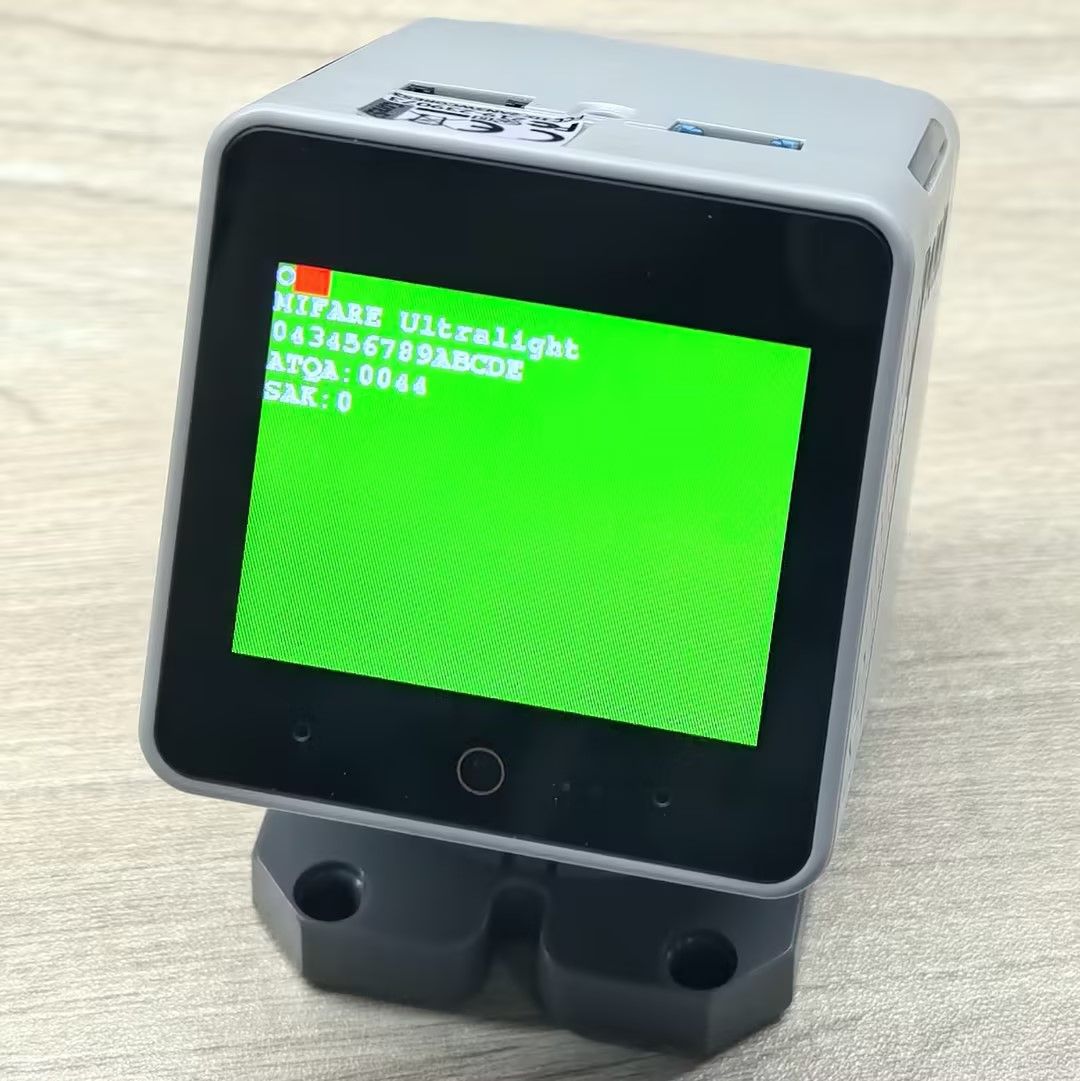

Tag Information Definition
1 2 3
constexpr Type type{Type::MIFARE_Ultralight};  // Select tag type to emulate (e.g., MIFARE_Ultralight or NTAG_213)
constexpr uint8_t uid[] = {0x04, 0x34, 0x56, 0x78, 0x9A, 0xBC, 0xDE};  // 7-byte UID
uint8_t picc_memory[64]{};  // Emulated tag memory buffer (size depends on card type)

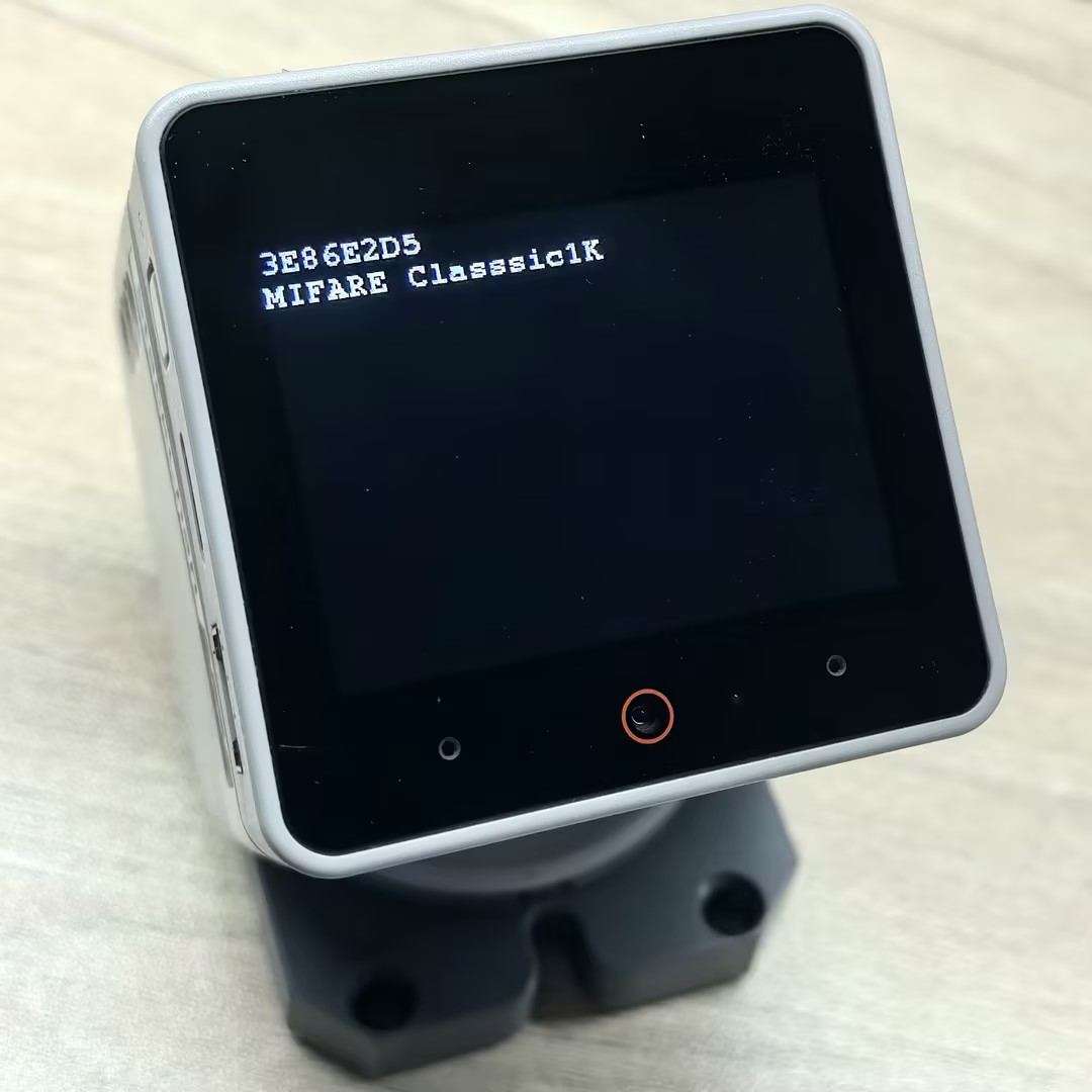

Quick Scan Identification
This example demonstrates how to quickly scan and identify NFC cards. The program continuously detects cards within the reader range. For each detected card, it executes a two-step identification process: first using detect() for preliminary classification, then using identify() for precise identification. After successful identification, it outputs card information including UID, type, ATQA, and SAK. This is a fundamental step for implementing NFC applications.
1 2 3 4 5 6 7 8 9 10 11 12 13 14 15 16 17 18 19 20 21 22 23 24 25 26 27 28 29 30 31 32 33 34 35 36 37 38 39 40 41 42 43 44 45 46 47 48 49 50 51 52 53 54 55 56 57 58 59 60 61 62 63 64 65 66 67 68 69 70 71 72 73 74 75 76 77 78 79
#include <M5StackChan.h>
#include <M5UnitUnified.h>
#include <M5UnitUnifiedNFC.h>
#include <M5Utility.h>

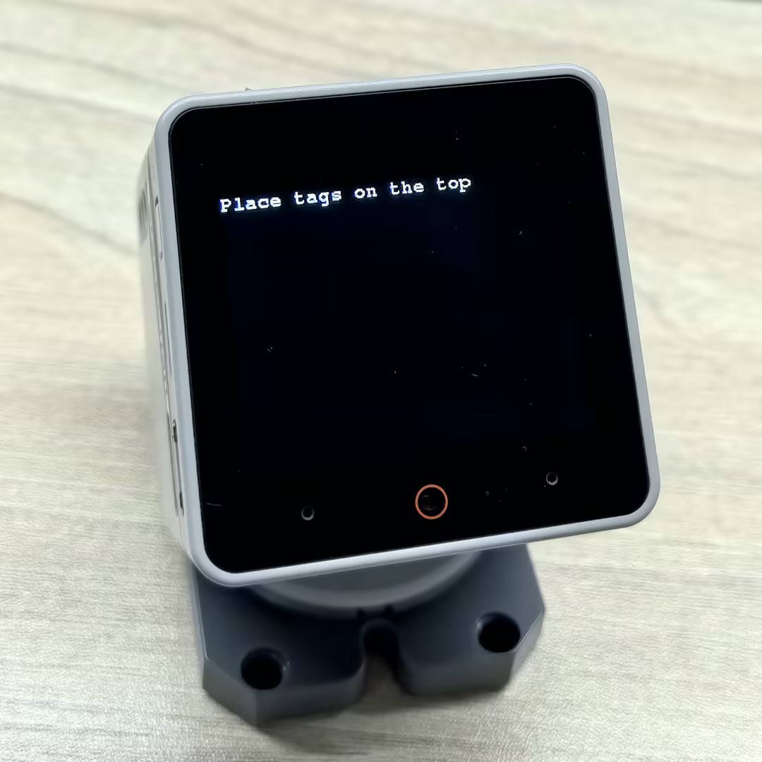

    lcd.printf("Place tag on the top\nand touch screen to detect");
    M5.Log.printf("Place tag on the top and touch screen to detect\n");

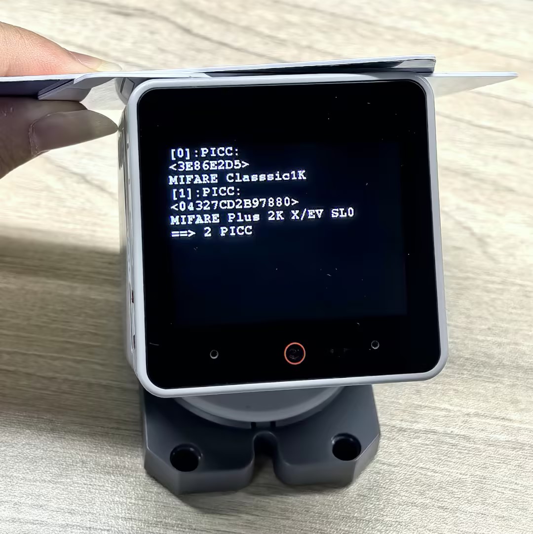

After uploading the above code to the main controller, open the serial monitor and place one or more tag cards near the top sensing surface of StackChan to see the identification results.
Serial monitor output example:
PICC:3E86E2D5 MIFARE Classsic1K 0004/08 752/1024
PICC:04327CD2B97880 MIFARE Plus 2K X/EV SL0 0044/20 1520/2048
==> 2 PICC

Tag Emulation
This example demonstrates NFC tag emulation functionality. When other NFC readers (such as a smartphone) approach the top of StackChan, they can detect and read the emulated NFC tag. The program supports emulation of two common tag card types: MIFARE Ultralight and NTAG 213, each with corresponding UID and memory data (including NDEF messages).
Key points:
  • During emulation, update() must be called continuously in the main loop to update state
  • State changes (Off→Idle→Ready→Active→Halt) are displayed in real-time via screen indicator
  • Card data can include NDEF messages supporting multiple content types (URI, text, images, etc.)
1 2 3 4 5 6 7 8 9 10 11 12 13 14 15 16 17 18 19 20 21 22 23 24 25 26 27 28 29 30 31 32 33 34 35 36 37 38 39 40 41 42 43 44 45 46 47 48 49 50 51 52 53 54 55 56 57 58 59 60 61 62 63 64 65 66 67 68 69 70 71 72 73 74 75 76 77 78 79 80 81 82 83 84 85 86 87 88 89 90 91 92 93 94 95 96 97 98 99 100 101 102 103 104 105 106 107 108 109 110 111 112 113 114 115 116 117 118 119 120 121 122 123 124 125 126 127 128 129 130 131 132 133 134 135 136 137 138 139 140 141 142 143 144 145 146 147 148 149 150 151 152 153 154 155 156 157 158 159 160 161 162 163 164 165 166 167 168 169 170 171 172 173 174 175 176 177 178 179 180 181 182 183 184 185 186 187 188 189 190 191 192 193 194 195 196 197 198 199 200 201 202 203 204 205 206 207 208 209 210 211 212 213 214 215 216 217 218 219

After uploading the above code to the main controller, the top of StackChan will emulate as an NFC tag. When a smartphone or other NFC reader approaches it, they can detect the NFC tag and read the stored NDEF message content (URL + Text). The serial monitor will output the emulated tag's type, UID, ATQA, and SAK information. Meanwhile, the top-left corner of the main controller screen will display state indicators (Idle/Ready/Active, etc.).
Example of tag information read by smartphone:
Serial monitor output examples:
  • MIFARE Ultralight
Emulation:MIFARE Ultralight 043456789ABCDE ATQA:0044 SAK:0
O
I
R
H
R
H
R
O
  • NTAG 213
Emulation:NTAG 213 99887766554433 ATQA:0044 SAK:0
O
I
R
H
R
H
R
O
  • Click (cross-block read/write test):
PICC:3E86E2D5 MIFARE Classsic1K 752/1024
================================ WRITE block:1 len:112
00)[000]:3E 86 E2 D5 8F 08 04 00 62 63 64 65 66 67 68 69 [0 0 0]
   [001]:54 68 69 73 20 69 73 20 61 20 73 61 6D 70 6C 65 [0 0 0]
   [002]:20 6D 65 73 73 61 67 65 20 62 75 66 66 65 72 20 [0 0 0]
   [003]:00 00 00 00 00 00 FF 07 80 69 FF FF FF FF FF FF [0 0 1]
================================ VERIFY:OK
================================ CLEAR
   [001]:00 00 00 00 00 00 00 00 00 00 00 00 00 00 00 00 [0 0 0]
   [002]:00 00 00 00 00 00 00 00 00 00 00 00 00 00 00 00 [0 0 0]
  • Hold (single block read/write test):
Non rechargeable

  • Hold (Rechargeable Wallet):
Rechargeable
==== Initial value
15)[060]:00 00 00 00 00 00 00 00 00 00 00 00 00 00 00 00 [0 0 0]
   [061]:00 00 00 00 00 00 00 00 00 00 00 00 00 00 00 00 [0 0 0]
   [062]:87 D6 12 00 78 29 ED FF 87 D6 12 00 3E C1 3E C1 [1 1 0] V:1234567 A: 62
   [063]:00 00 00 00 00 00 3B 47 8C 69 00 00 00 00 00 00 [0 1 1]
==== Decrement done
   [062]:B0 C4 12 00 4F 3B ED FF B0 C4 12 00 3E C1 3E C1 [1 1 0] V:1230000 A: 62
==== Increment done
   [062]:13 C5 12 00 EC 3A ED FF 13 C5 12 00 3E C1 3E C1 [1 1 0] V:1230099 A: 62
==== Copy from 62 to 61
   [061]:13 C5 12 00 EC 3A ED FF 13 C5 12 00 3E C1 3E C1 [0 0 0] V:1230099 A: 62
==== To be normal block
   [062]:00 00 00 00 00 00 00 00 00 00 00 00 00 00 00 00 [0 0 0]
   [063]:00 00 00 00 00 00 FF 07 80 69 FF FF FF FF FF FF [0 0 1]
Please remove the PICC from the reader
