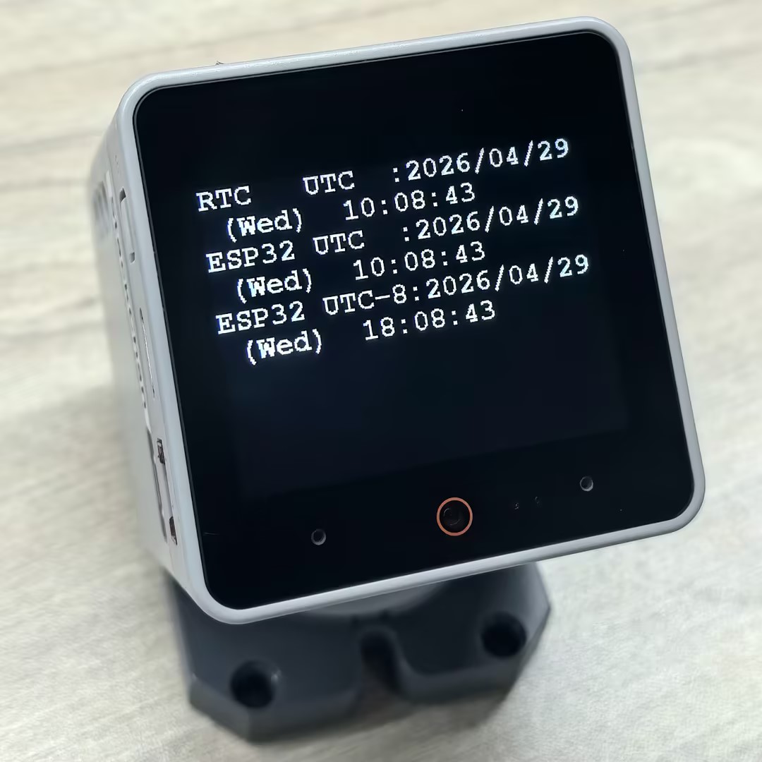

After flashing successfully, the StackChan screen will display the current RTC time and the ESP32 internal clock time. The RTC time is set via NTP synchronization, while the ESP32 internal clock is retrieved using system time functions — both should remain in sync.
