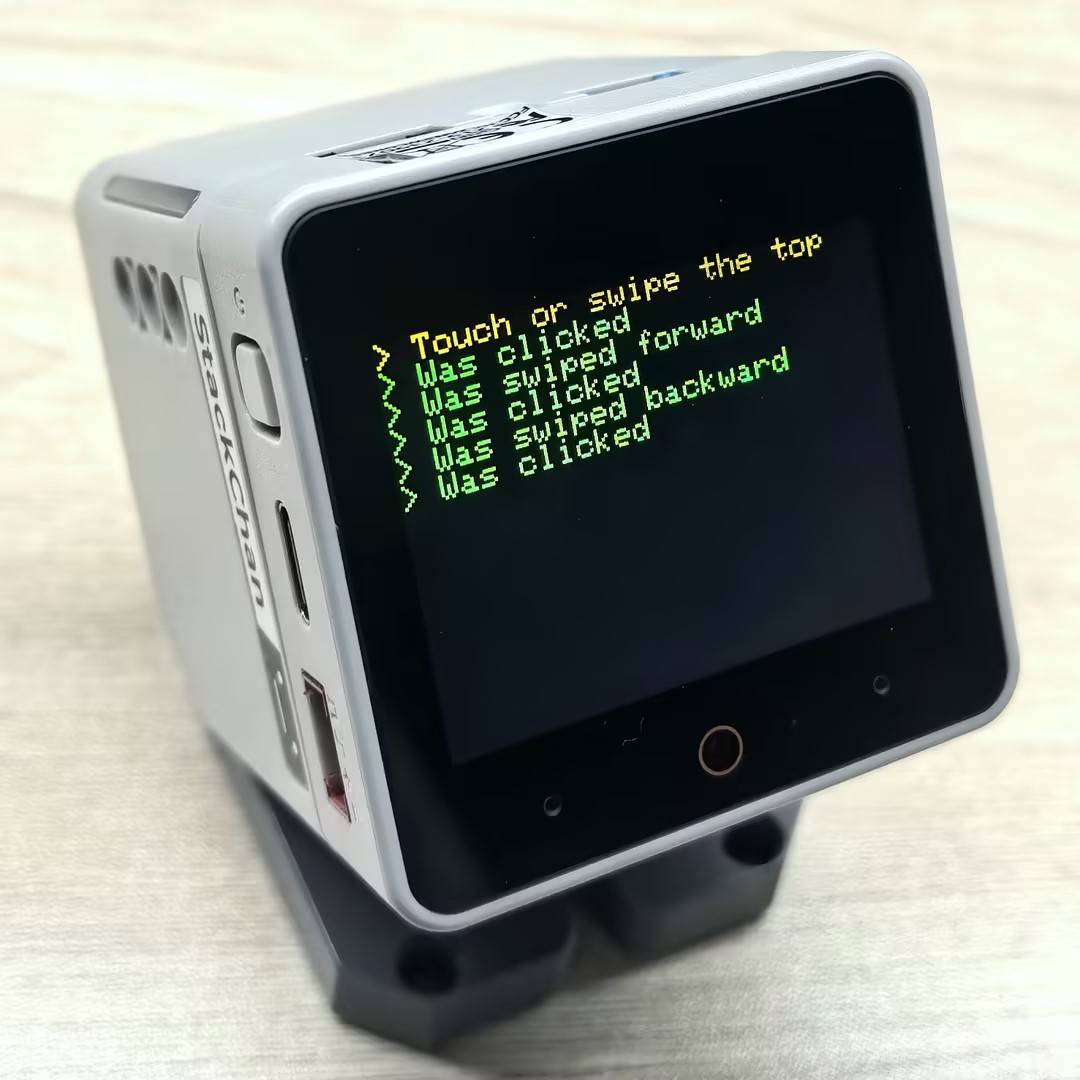

After a successful upload, you can interact with the device by touching the touch sensor on the top of StackChan. When you tap the sensor, the screen will display "Was clicked"; when you swipe forward on the sensor, "Was swiped forward" will be shown; when you swipe backward, "Was swiped backward" will appear on the screen.
