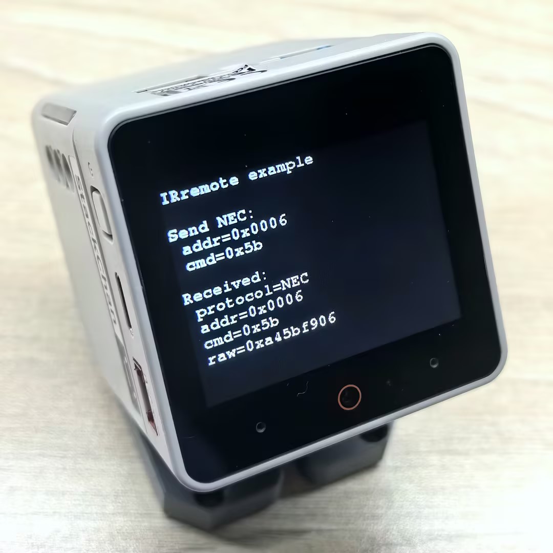

Arduino Quick Start
#include <IRremote.hpp>
#include <M5StackChan.h>
#define IR_SEND_PIN 5 // GPIO pin for IR transmitter
#define IR_RECEIVE_PIN 10 // GPIO pin for IR receiver
// Demo parameters for NEC protocol
uint16_t address = 0x0000; // Starting device address
uint8_t command = 0x55; // Starting command value
uint8_t repeats = 0; // Number of repeat transmissions
void setup() {
M5StackChan.begin(); // Initialize M5Stack device
Serial.begin(115200); // Start serial communication at 115200 baud
delay(200); // Wait for serial port to stabilize
// Configure Display() settings
M5StackChan.Display().setTextFont(&fonts::FreeMonoBold9pt7b);
M5StackChan.Display().clear();
M5StackChan.Display().setCursor(0,0);
M5StackChan.Display().printf("IRremote example");
Serial.println("IRremote example");
// Initialize IR communication
IrReceiver.begin(IR_RECEIVE_PIN); // Start IR receiver
IrSender.begin(DISABLE_LED_FEEDBACK); // Initialize IR sender without LED feedback
IrSender.setSendPin(IR_SEND_PIN); // Assign transmitter pin
Serial.printf("IR Send Pin: %d, IR Recv Pin: %d\n", IR_SEND_PIN, IR_RECEIVE_PIN);
delay(500); // Wait for hardware components to stabilize
void loop() {
// 1. Send infrared signal using NEC protocol
Serial.printf("Send NEC: addr=0x%04x, cmd=0x%02x\n", address, command);
IrSender.sendNEC(address, command, repeats);
// Update Display with transmission info
M5StackChan.Display().fillRect(0, 20, 320, 90, TFT_BLACK); // Clear previous content
M5StackChan.Display().setCursor(0, 40);
M5StackChan.Display().printf("Send NEC:\n addr=0x%04x\n cmd=0x%02x\n", address, command);
IrReceiver.restartAfterSend(); // Re-enable receiver after transmission
// 2. Wait for possible reflection (short-range testing)
delay(20); // Brief pause to allow signal reception
// Attempt to decode received IR signal
if (IrReceiver.decode()) {
// Print received data to serial monitor
Serial.printf("Received: protocol=%s, addr=0x%04x, cmd=0x%02x, raw=0x%08lx\n",
getProtocolString(IrReceiver.decodedIRData.protocol),
IrReceiver.decodedIRData.address,
IrReceiver.decodedIRData.command,
(unsigned long)IrReceiver.decodedIRData.decodedRawData);
// Display received data on screen
M5StackChan.Display().fillRect(0, 110, 320, 130, TFT_BLACK); // Clear previous content
M5StackChan.Display().setCursor(0, 110);
M5StackChan.Display().printf("Received:\n protocol=%s\n addr=0x%04x\n cmd=0x%02x\n raw=0x%08lx\n",
IrReceiver.resume(); // Enable reception of next signal
} else {
// Handle case where no signal was received
Serial.println("No IR received.");
M5StackChan.Display().println("No IR received.");
// Update transmission parameters for next cycle
address += 0x0001; // Increment device address
command += 0x01; // Increment command code
repeats = 0; // Disable repeat frames (set >0 to test repeats)
delay(2000); // Main loop delay (2 seconds)
}This program controls StackChan to send and receive infrared NEC encoding and displays related NEC encoding information on the screen.
