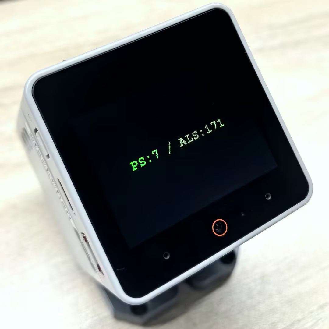

After flashing successfully, you can view the PS (Proximity) and ALS (Ambient Light) readings from the LTR553 proximity sensor on both the serial monitor and the screen.
