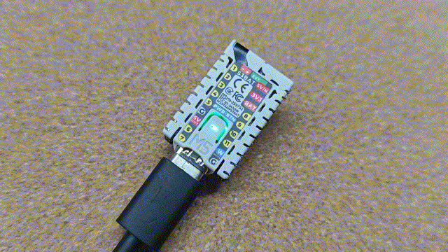

Stamp-S3Bat RGB LED Status Light
Stamp-S3Bat example program.
Tutorial
Compilation Requirements
  • M5Stack Board Manager Version >= 3.2.6
  • Board Option = M5StampS3Bat
  • M5PM1 Library Version >= 1.0.7
RGB LED
