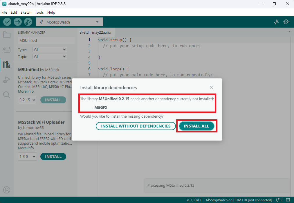

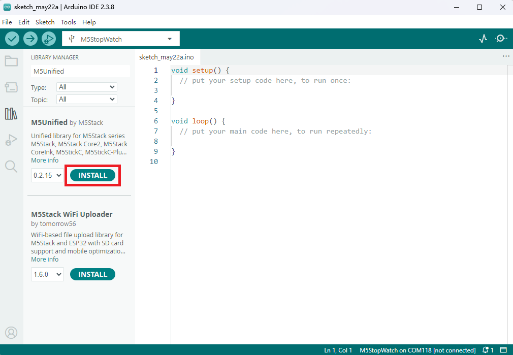

  • 3. Dependency Library Installation: Refer to the Library Manager Installation Tutorial to complete the installation of the M5Unified and M5GFX libraries, and install all dependent libraries as prompted.

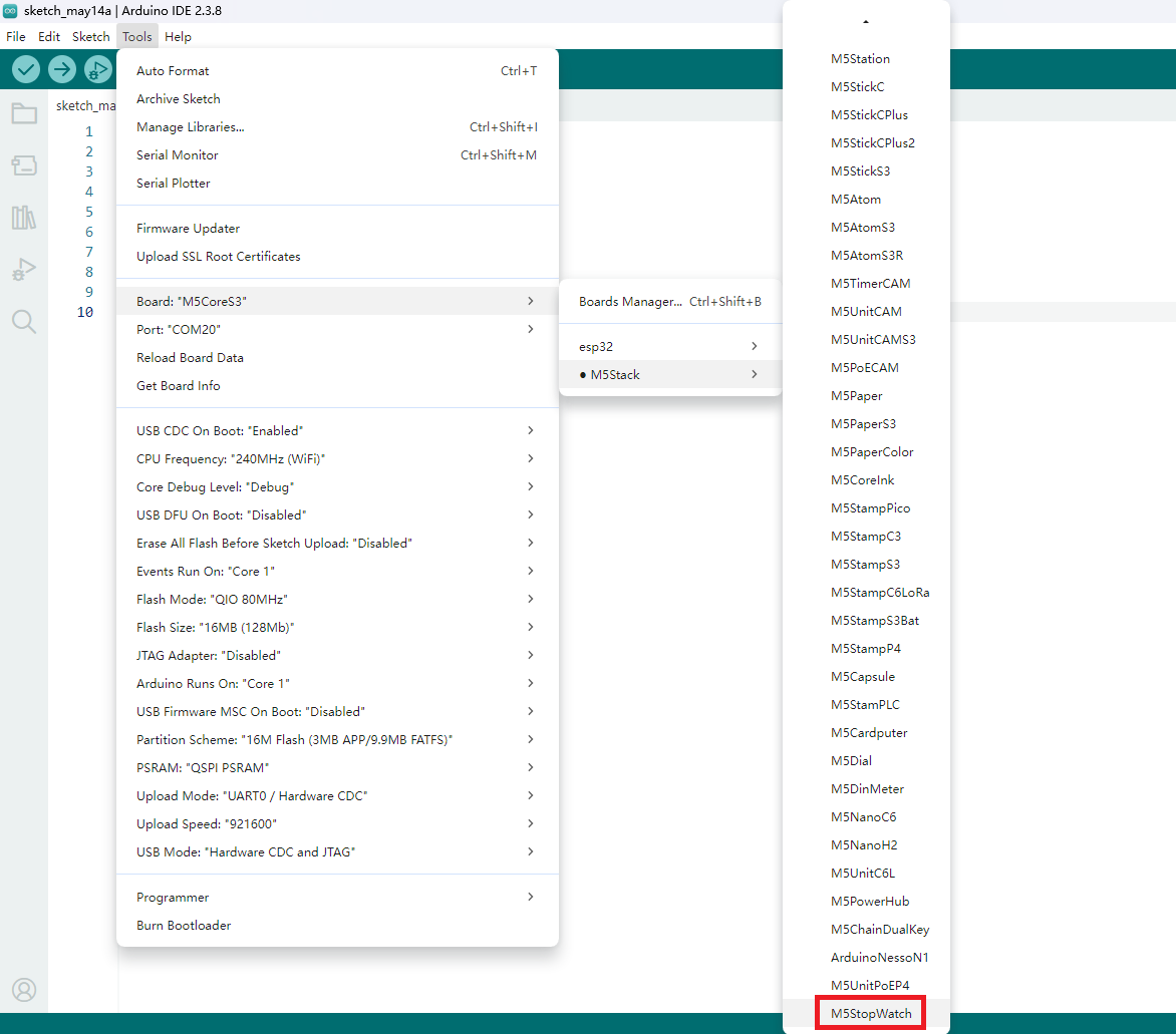

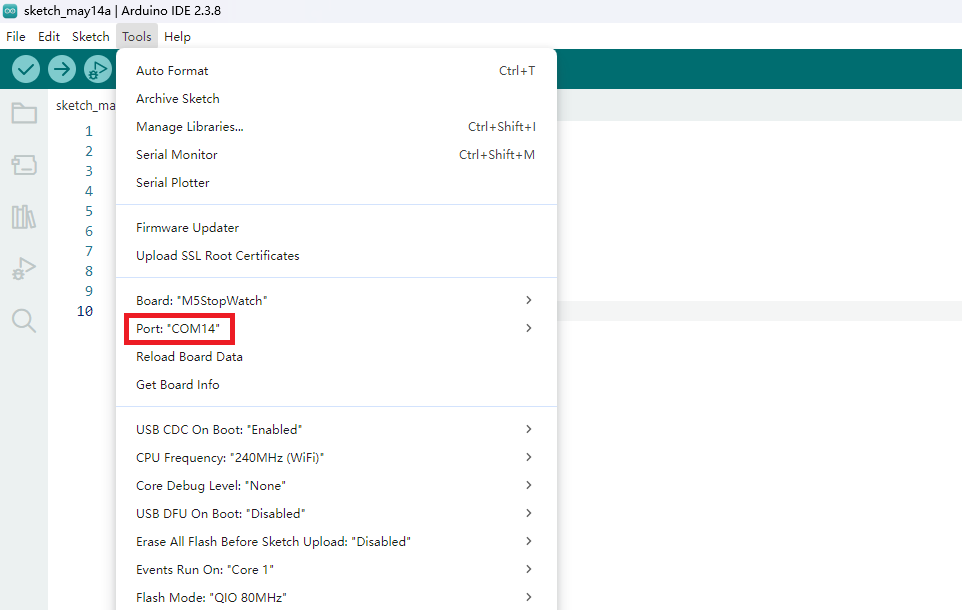

3. Port Selection
Connect the device to the computer with a USB cable, then select the corresponding device port in Arduino IDE.

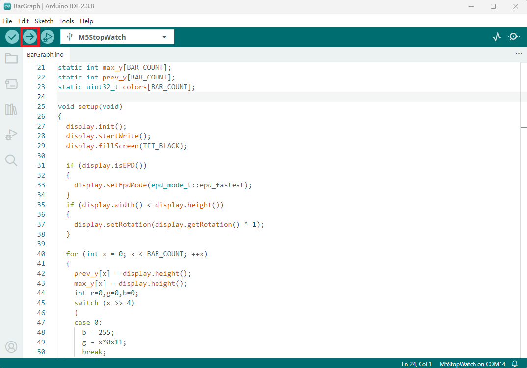

4. Program Compilation & Upload

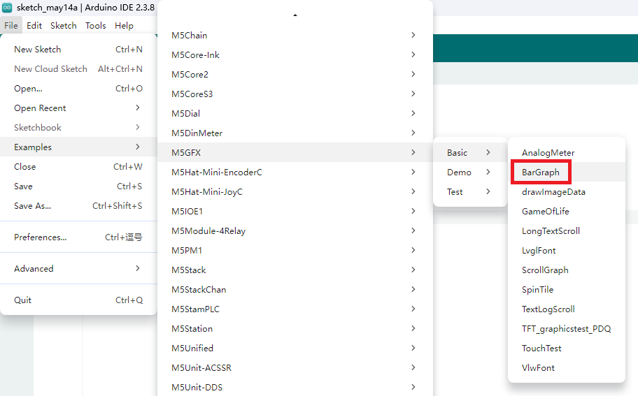

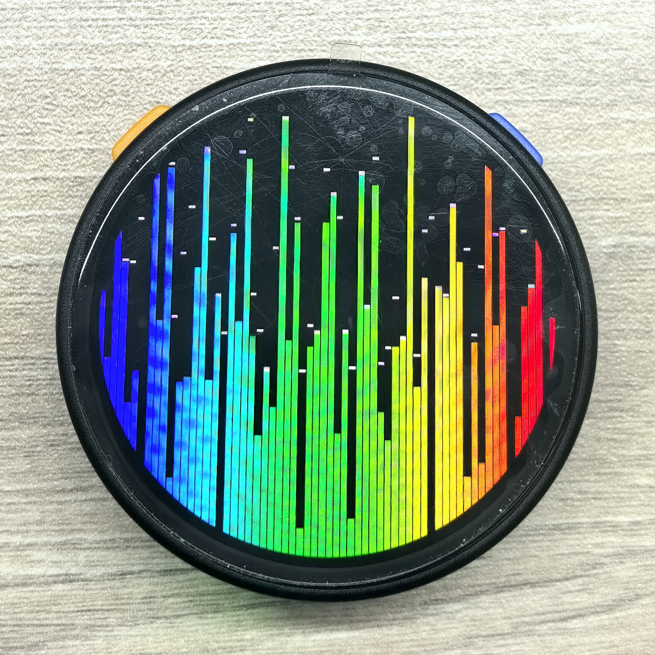

Open the example program ?BarGraph? in the library and click the upload button. The IDE will automatically compile and upload the program.
The example effect is shown below:
