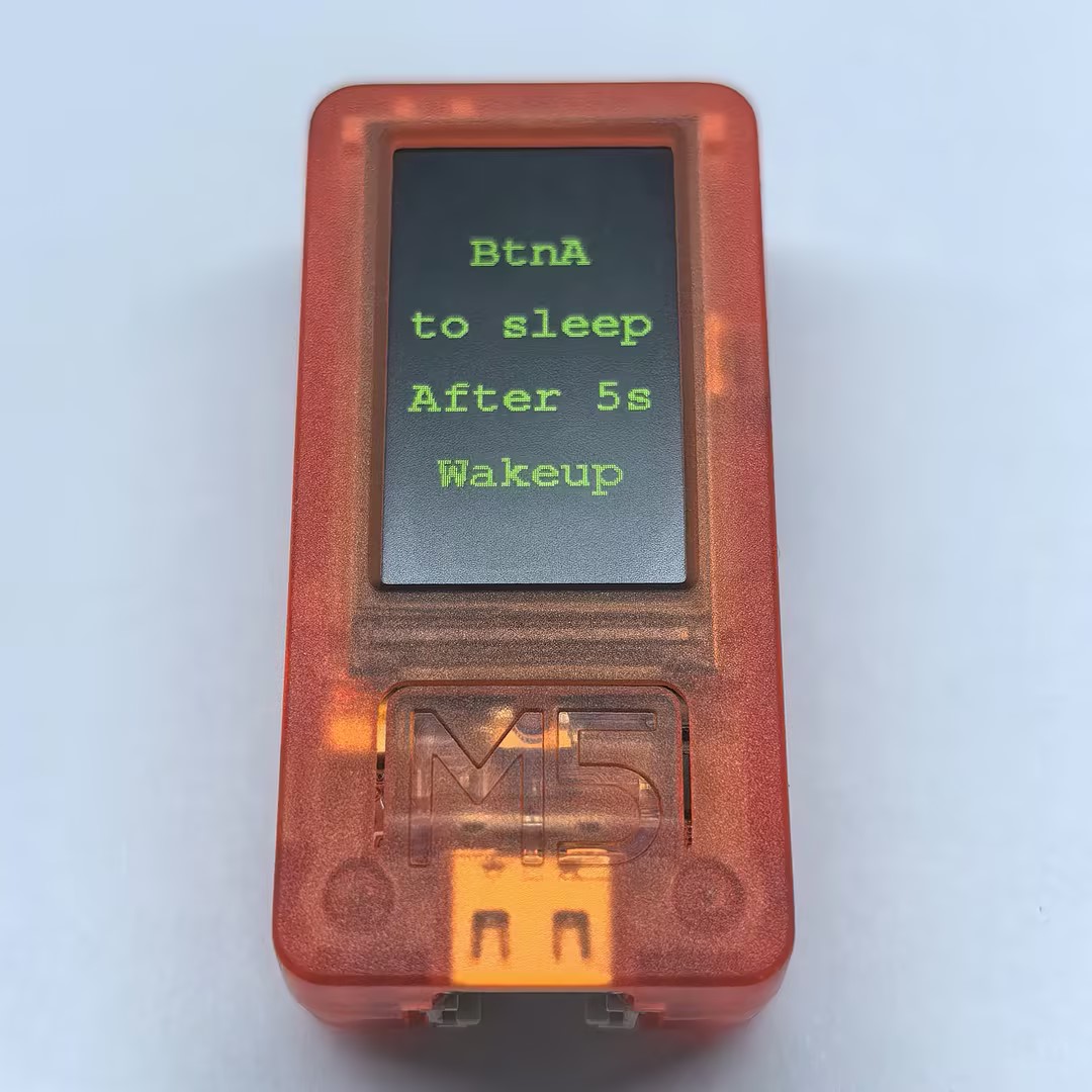

    M5.Display.setTextColor(GREEN);
    M5.Display.setFont(&fonts::FreeMonoBold18pt7b);
    M5.Display.setTextSize(1);
    M5.Display.drawString("BtnA", M5.Display.width() / 2,
                              M5.Display.height() / 2 - 60);
    M5.Display.drawString("to sleep", M5.Display.width() / 2,
                              M5.Display.height() / 2 - 20);
    M5.Display.drawString("After 5s", M5.Display.width() / 2,
                              M5.Display.height() / 2 + 20);
    M5.Display.drawString("Wakeup", M5.Display.width() / 2,
                              M5.Display.height() / 2 + 60);

After flashing, press BtnA on the front of the StickC-Plus SE to enter sleep mode. The device automatically wakes up after 5 seconds.
