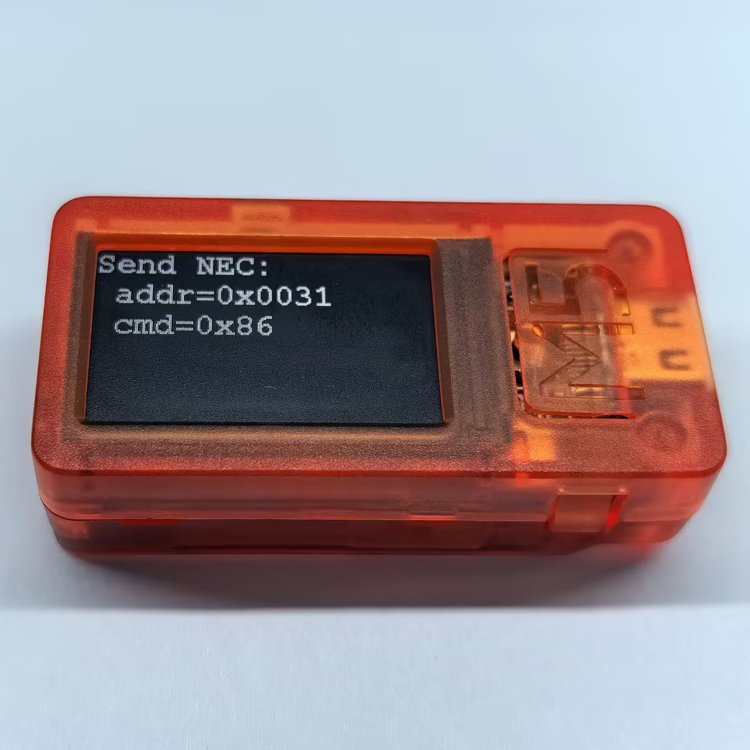

StickC-Plus SE sends an NEC infrared signal every 2 seconds. The address and command values increment from 0x0000 and 0x55 respectively. Use an infrared receiver that supports the NEC protocol to verify reception.
