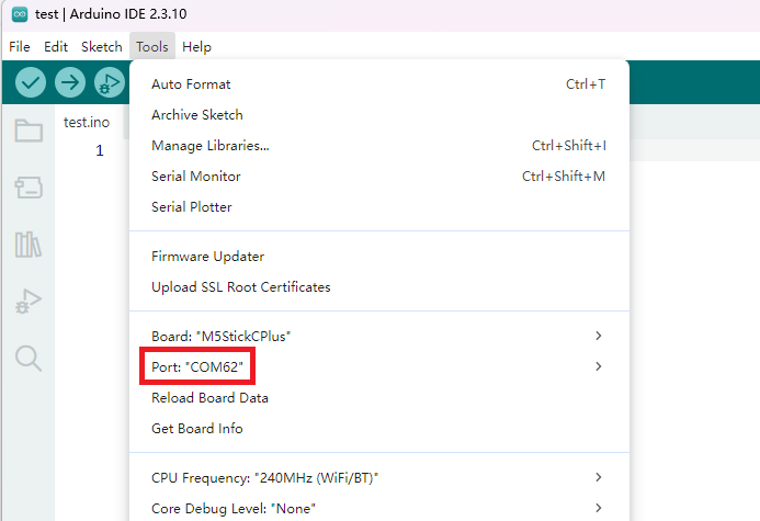

3. Port Selection
Connect the device to the computer with a USB cable. After the driver is installed, select the corresponding device port in Arduino IDE.

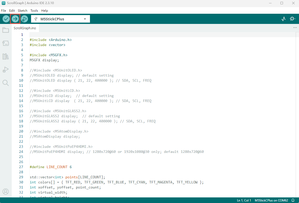

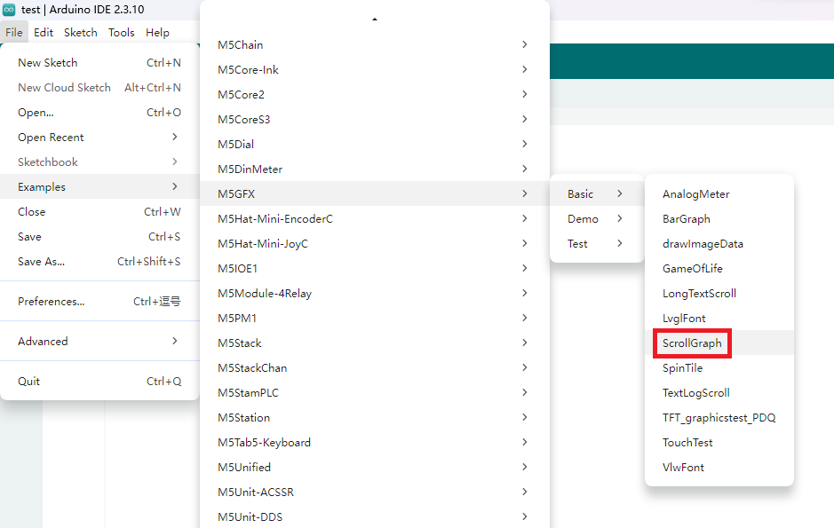

4. Compiling and Flashing
Open the ScrollGraph example from the driver library and click Upload. Arduino IDE will compile and flash the program automatically.

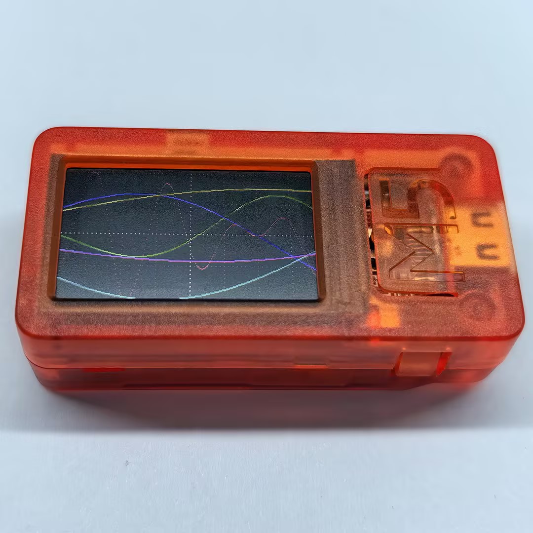

The display output is shown below:
