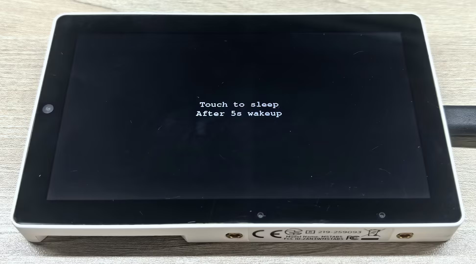

Second-Level Timed Wakeup
Second-level wakeup uses the internal RTC timer of the ESP32. The wakeup time precision is at the second level, and the program restarts after wakeup.

After the program runs successfully, touch the screen and Tab5 will enter sleep mode, then wake up after about 5 seconds. The screen display is shown below:

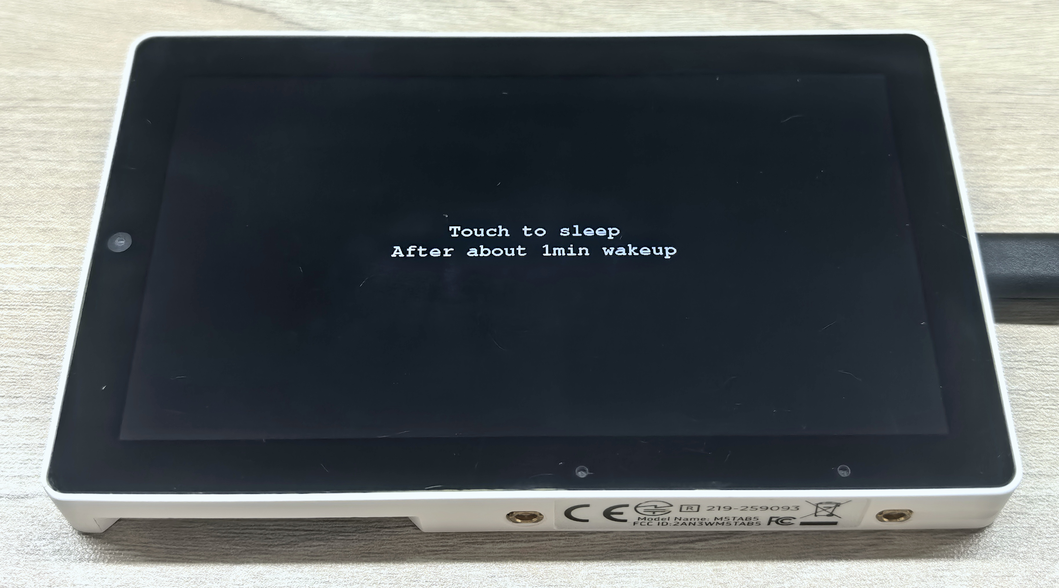

Wakeup at a Specified Time
Wakeup at a specified time uses the RX8130 RTC timer. The wakeup time precision is at the minute level, and the program restarts after wakeup.

After the program runs successfully, touch the screen and Tab5 will enter sleep mode, then wake up after about 1 minute. The screen display is shown below:
