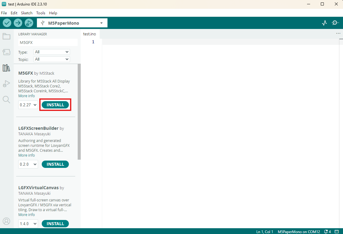

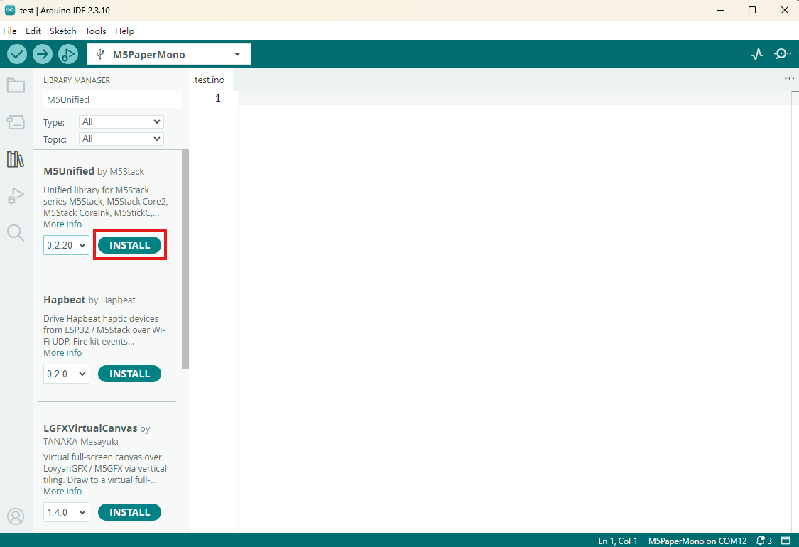

  • 3. Install dependent libraries: Follow the Library Manager Installation Tutorial to install the M5Unified, M5GFX, M5PM1, M5IOE1, M5UnitUnified, M5Unit-NFC, and RadioLib libraries, then install all prompted dependencies.

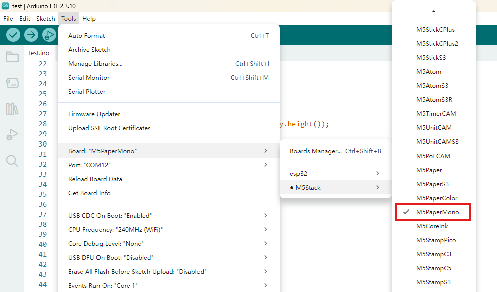

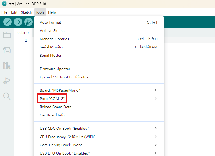

3. Port Selection
After the device port is detected, select the corresponding port in Arduino IDE.

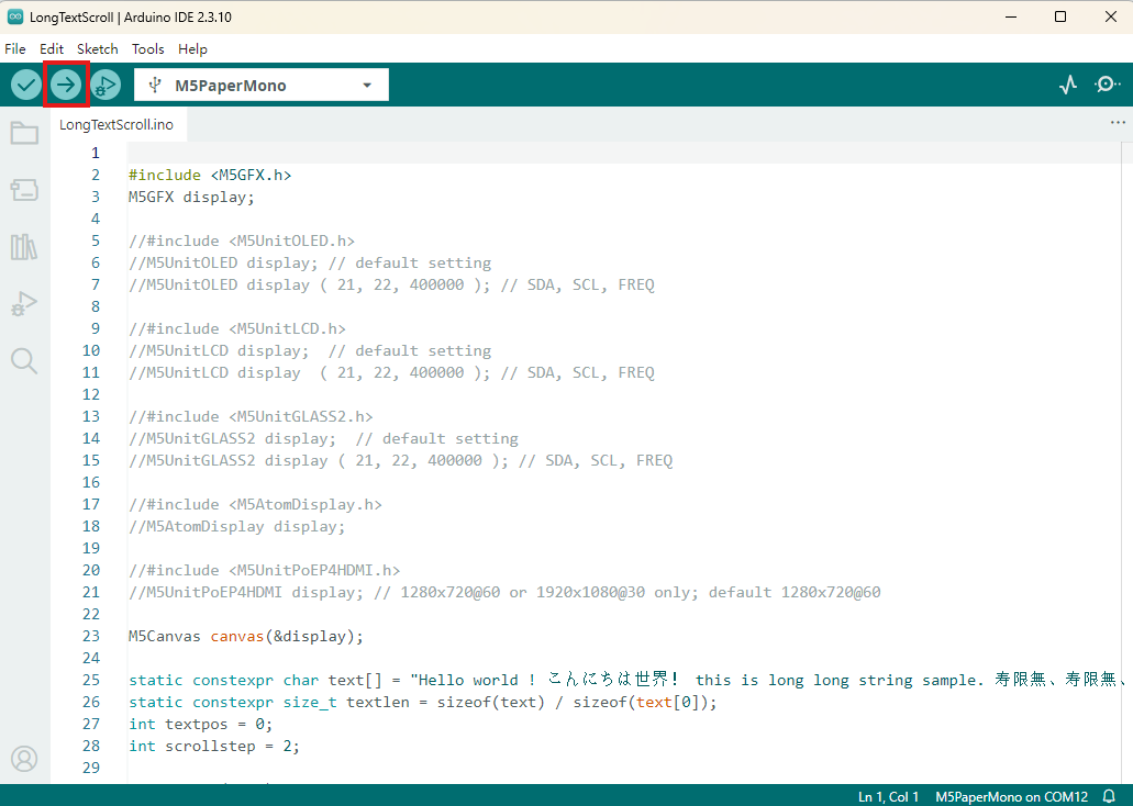

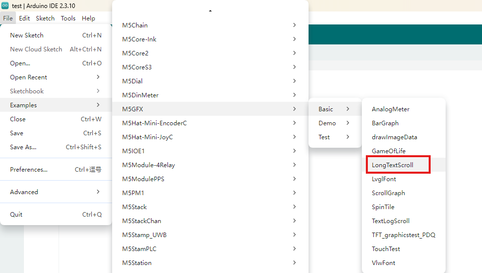

4. Program Compile & Upload

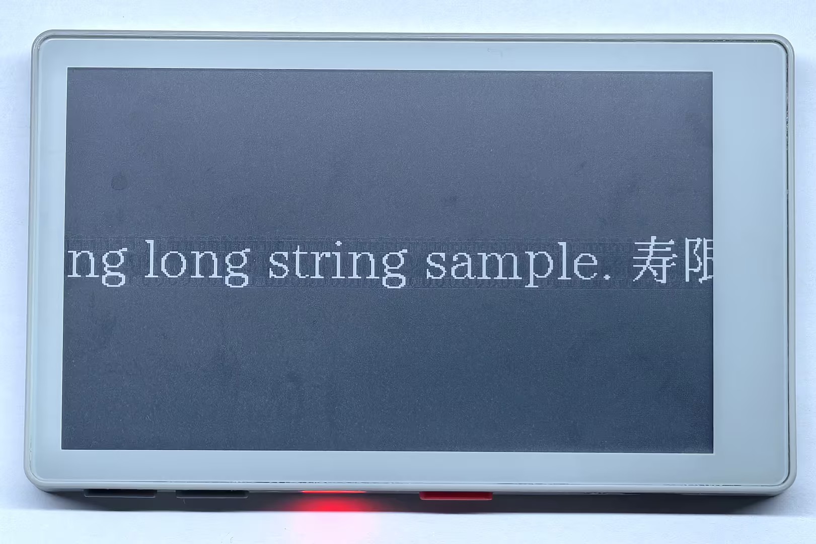

Open the “BarGraph” example from the driver library and click the Upload button. The program will be compiled and flashed automatically.
The result is shown below:
