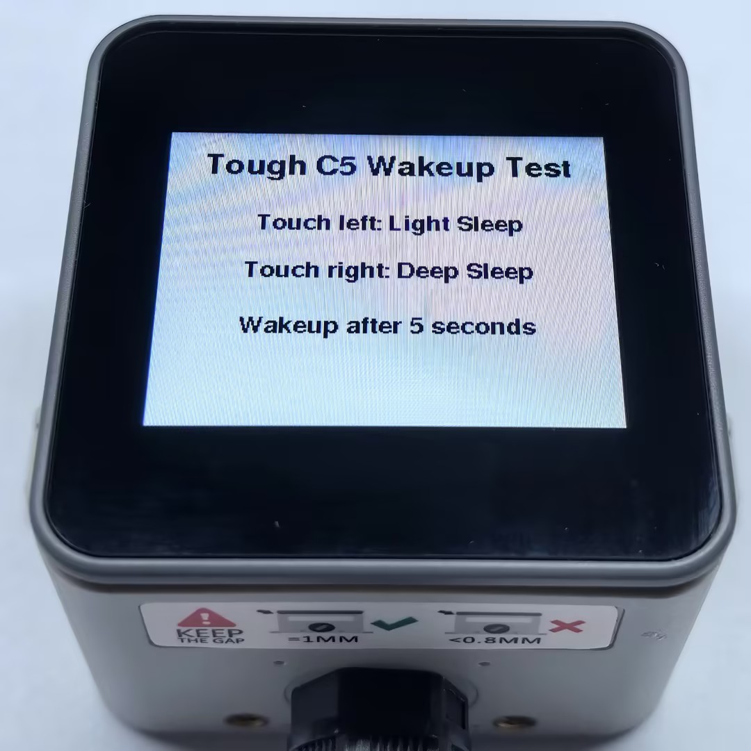

After startup, the screen shows two sleep options. Touch the left side to enter light sleep for 5 seconds. On wakeup, execution continues from the line after lightSleep() and displays a completion message. Touch the right side to enter deep sleep for 5 seconds. On wakeup, ESP32-C5 resets and runs setup() again.
