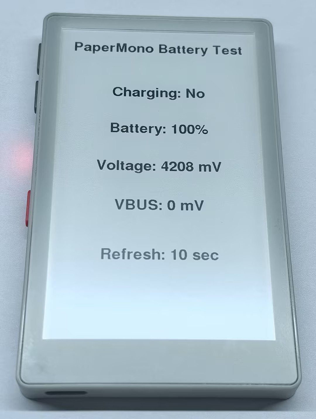

The program displays the charging status, battery level, battery voltage, and VBUS input voltage, refreshing every 10 seconds.
