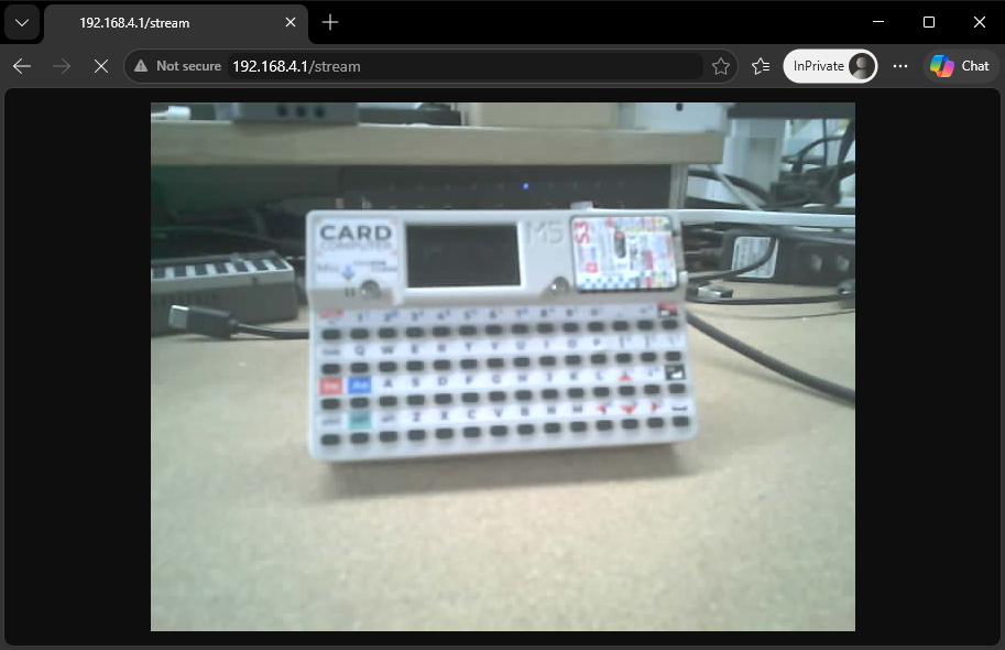

4. Running Result
After the program starts, connect a computer or mobile device to the Stamp-AddOn Cam3660 Wi-Fi access point using the password 12345678. Open http://192.168.4.1/stream in a browser to view the live stream, or open http://192.168.4.1/capture to capture a still image. The serial monitor displays the device IP address, access URLs, frame size, transmission time, and frame rate.

Browser access example:
