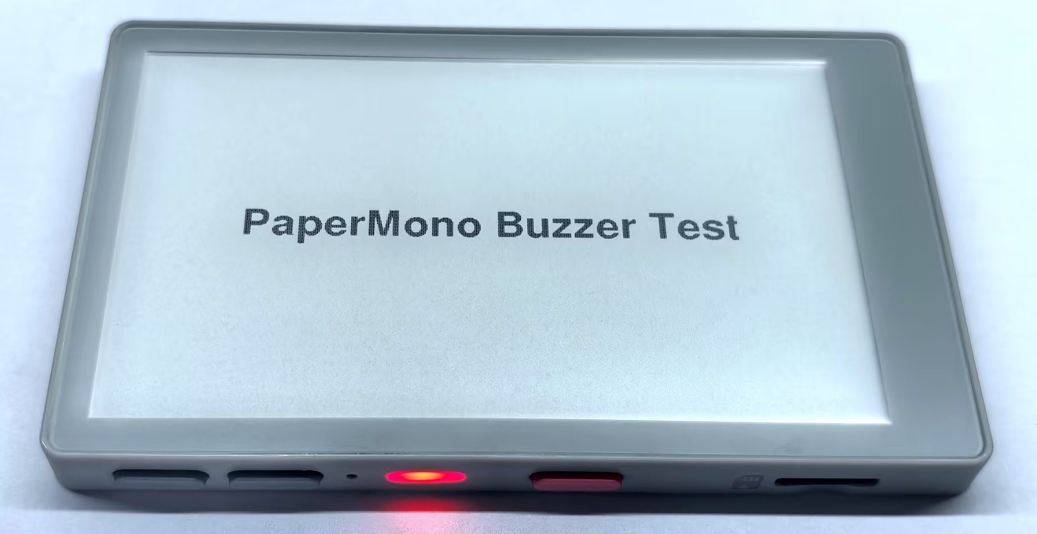

#include <M5Unified.h>
static void drawScreen()
    M5.Display.fillScreen(WHITE);
    M5.Display.setTextColor(RED);
    M5.Display.setFont(&fonts::FreeSansBold24pt7b);
    M5.Display.setTextSize(1);
    M5.Display.drawString("PaperMono Buzzer Test", M5.Display.width() / 2, M5.Display.height() / 2);
void setup()
    M5.begin();
    M5.Display.setEpdMode(epd_mode_t::epd_fast);
    drawScreen();
void loop()
    M5.Speaker.tone(4000, 200);
    delay(2000);
    M5.Speaker.tone(8000, 200);
    delay(2000);
After the device powers on, it plays two tones with different frequencies every 2 seconds.
