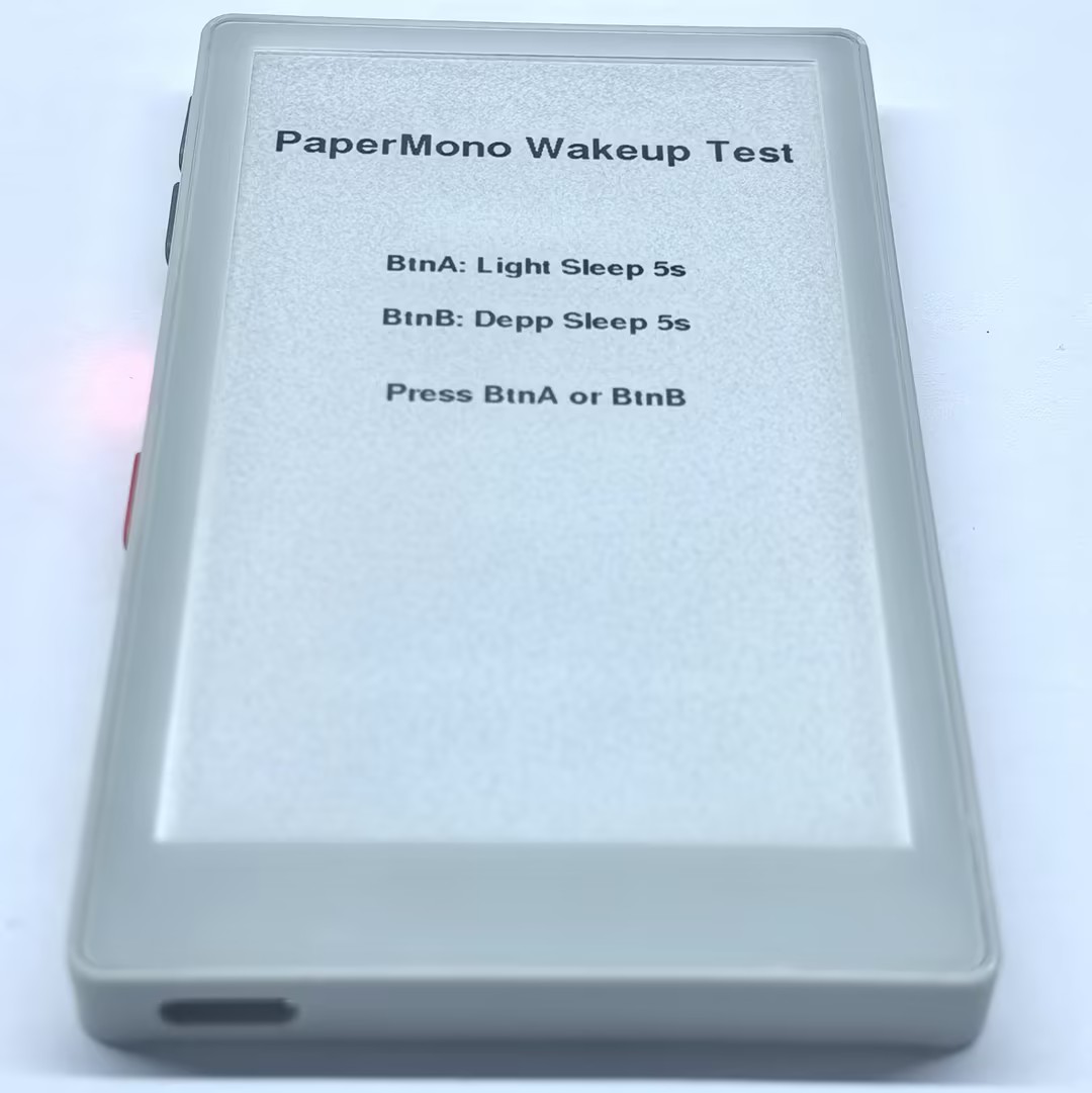

After the program starts, the screen shows two sleep operations. Pressing button A enters light sleep for 5 seconds; after wakeup, execution continues from the line following lightSleep() and indicates that wakeup is complete. Pressing button B enters deep sleep for 5 seconds; after the timed wakeup, the ESP32-S3 resets and starts again from setup().
